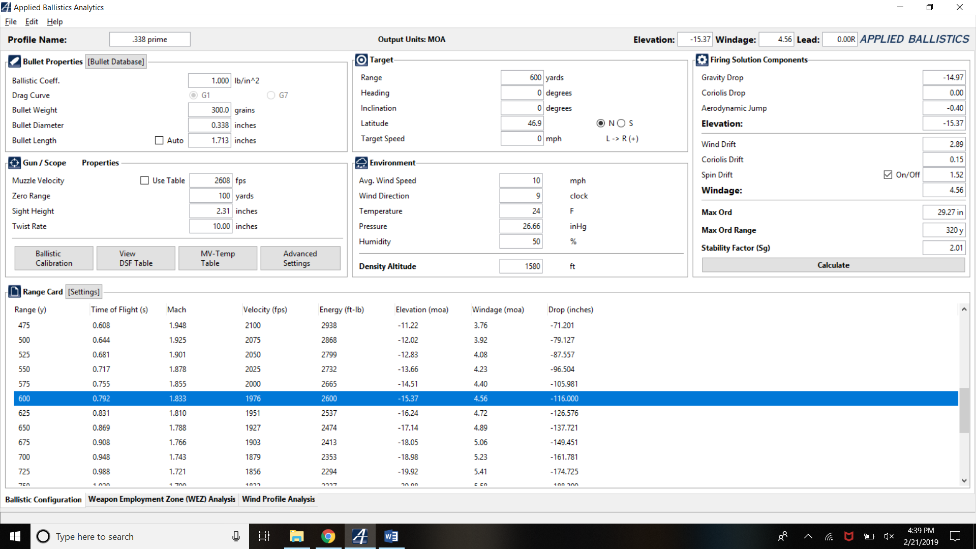

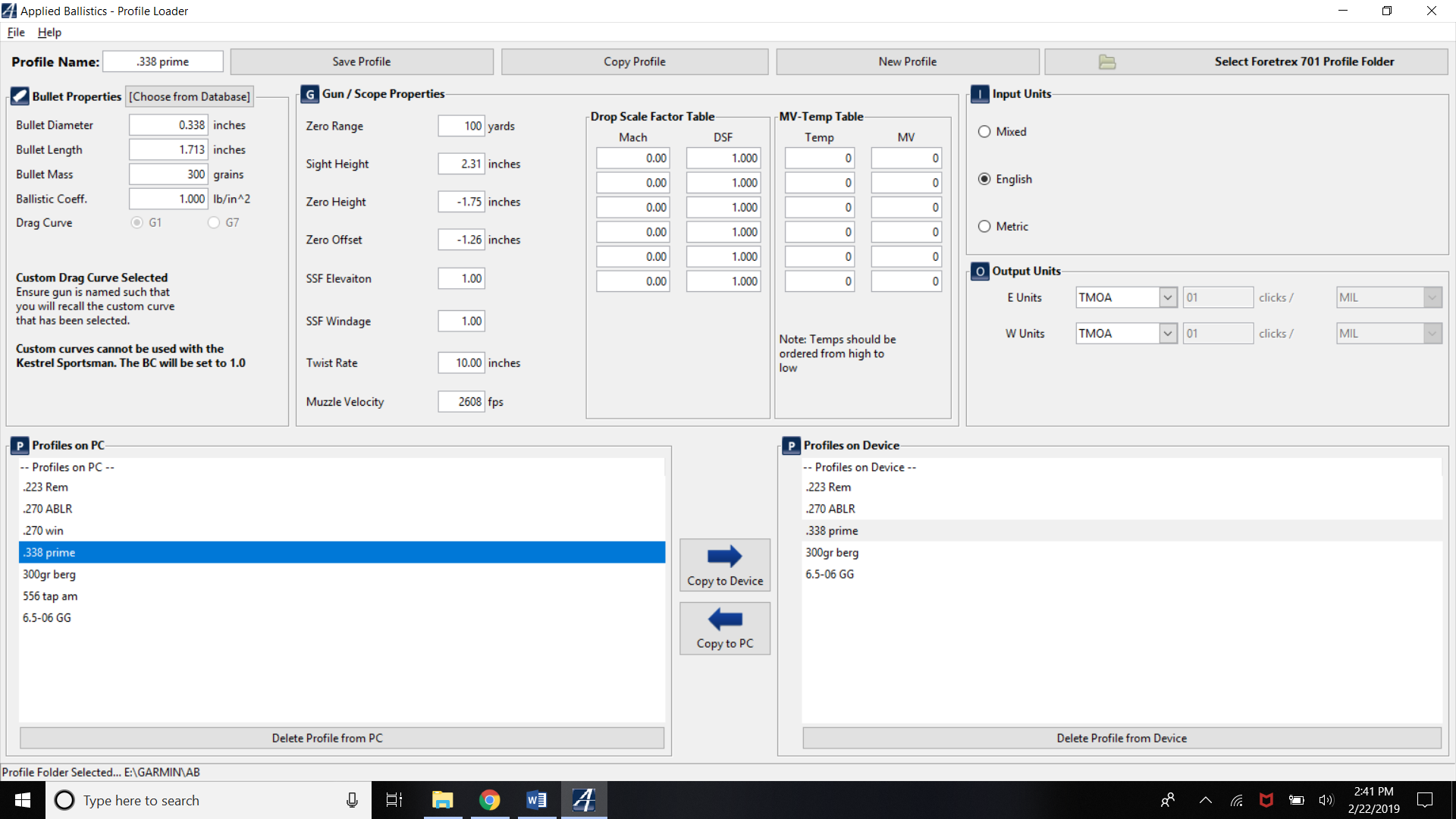

So I was at the range today and kept shooting low. I was using the 701 which was giving me a firing solution of 11.5 Moa (IK, IK moa but its what my camp communicates in). Once I was home I ran AB off of my computer and I am getting a very different solution. My computer is telling me I need 14.97 Moa for 600 yards. My 701 is claiming 11.62 Moa needed. Can anyone else replicate this same issue? Once Thing is that I am using a zero offset for different bullets. The off set for this load is -1.75 inches zero height and -1.26 inches Zero offset. I have spin drift, coriolis, and aerodynamic jump set off on the 701.
My atmospherics are
Temp: 24f
Preasure: 26.66 hg
Humidity: 50%
Lat: 46.9
Gun properties
Bullet: RUAG Swissp
Velovity: 2608 fps
Zero: 100 yards
Seight height: 2.31 in
Twist rate: 10 twist

The problem is the zero offset is BACKWARDS in the 701. If your zero offset is high, you actually need to input it as a NEGATIVE number, instead of positive, to get the correct dope. The same is true with the left and right offset. Seems to be a bug in the software as the manual tells you to input the values like you would any other zero offset in any other calculator.

Thats one of the wierdest things ive seen. Sure enough, I ran it on my desktop and the solution was wrong, i ran it on the foretrex and the solution was right. So now i have two profiles with the opposite off sets yet it lines up on the range card perfectly. Thank you for your help!
@DocUSMCRetired There you go, not sure why its reversed in the foretrex but its all working now.
The only thing other thing to keep in mind now is the wind hold is as if the wind was comming from the oposite dirreciton.
edit- I kept the horizontal offset as negative and switched the vertical offset to posotive and now its all lined up perfectly.
