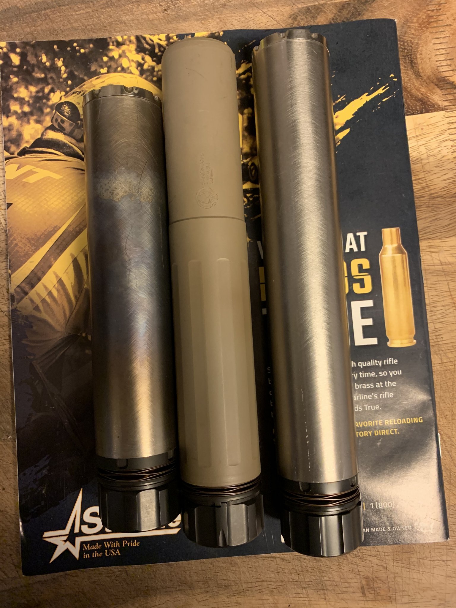

I have a couple of the Diversified SiCo Ti kits. They work as intended but not as well as my Dead Air Sandman L. I haven't done accuracy effect testing with them as I have just used them for quietening my 5.56 SBR's to this point. My 30 Cal version wieghs a lot less than the Sandman and works very well on a 10.5" SBR 300BO. All are set up to use KeyMo mounting.
