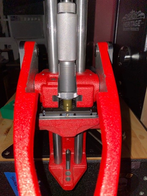

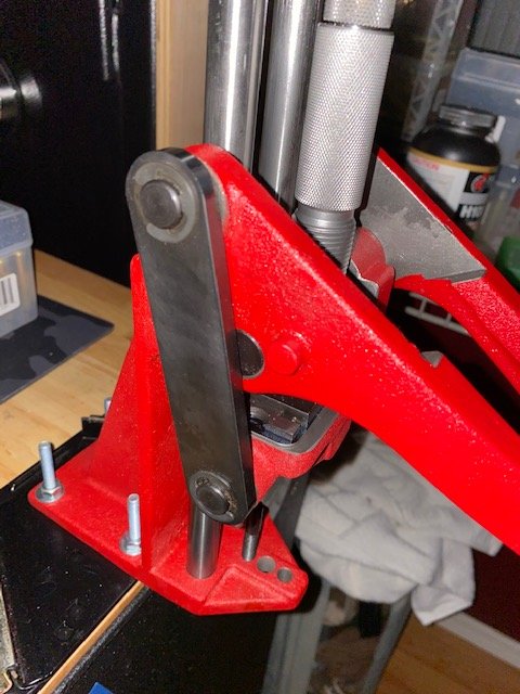

Forster Co-ax 300Win Die Problems
k3k0a808
Aug 16, 2020
47
11
Just bought a Forster Co-Ax and i am wondering if anyone has run into this problem, or have a solution for it. I have Hornady's Custom Grade Seating Die w/Micrometer, i have the die basically set as high as i can on the press, but its still not enough to not crimp the case... die clears the handle, but just barely. any help would be appreciated
you said your all the way up and still can not crimp? in order to crimp you need to go down with the die
I don’t want to crimp, but I’m at the end of the threads on the die, I was thinking of making a spacer so the shell holder doesn’t go all the way up
then you say you do not want to crimp...im confused can you explain what the problem is?
I think the issue is the OAL of the Hornady die with the Micro adjuster stem is too long for the Coax press?
He says it clears the handle. It isnt the issue.
OP: pull the handle down to raise an empty case up into the the seater. Then loosen the lock ring and spin the seater DOWN onto the empty case until it just hits the case mouth. Then just back it out one revolution since you say you dont want to crimp. That sets the die body, from there just use the micrometer to adjust the bullet seating.
What threads are backed all the way out ?.........seating stem on micro adjustement ?.......or......die backed out of lock ring ?......fuck it post a picture so we can see........ And while im one fingering this damn phone.....some up above might want to take a course in reading comprehension......it might help in not looking like an idiot.
@spife7980 probably figured out whats going on and gave the answer op needed. And if thats the case ( op doesnt know how to set up a seating die correctly) whats he doing pulling a handle on a press in the 1st place ?........ More reading time is advised...........But if seating die is backed just about out of lock ring and crimping, op has a die problem........
that’s my problem, I have the die screwed all the way up/out there’s no more adjustment up to make the die not crimp
don't have to be a dick about it, yeah its probably a die problem but the reason im asking here is to see if anyone else has run into this and if someone has a solution before i go out and buy another 100 dollar die
don't have to be a dick about it, yeah its probably a die problem but the reason im asking here is to see if anyone else has run into this and if someone has a solution before i go out and buy another 100 dollar die, also don't act all high and mighty, looking at your other posts you need to take a kindergarten level spelling course because some of your other posts on other threads need to be spell checked, first time I've seen someone misspell "public"
Hmm, I know in my coax and hornady custom 300bo (fucking polar opposite end of the spectrum) with micro stop seater gives me a very similar issue. I always assumed because it was so short of a case in the long seater but you are having the problem with it and a long case. (For those who dont know, the hornady custom grade uses the same generic seater body for all cases, the 300bo and the 300wm use the same seater)
I have to have the seater all the way out like that and even then I cant came over, I just have to stop right at in the middle of the handle throw with the press handle parallel to the floor or it does something similar and starts to crimp and smash the case too.
Get a different dies, the hornady custom seater is apparently a bad combo with the coax. Works alright for my 270 and 22 creed but this blackout is a pain in the ass and yours is too seemingly. Its the only die Ive had this issue with.
Hmm, I know in my coax and hornady custom 300bo (fucking polar opposite end of the spectrum) with micro stop seater gives me a very similar issue. I always assumed because it was so short but you are having the problem with it and a long case. (For those who dont know, the hornady custom grade uses the same generic seater body for all cases, the 300bo and the 300wm use the same seater)
I have to have the seater all the way out like that and even then I cant came over, I just have to stop right at in the middle with the press handle parallel to the floor or it does starts to crimp and smash the case too.
Get a different dies, the hornady custom seater is apparantly a bad combo with the coax.
yeah it smashes the case, i want the handle to be able to go all the way to the end of the travel so i get consistent seating
So did you get it figued out? My post wasnt intended to be an ass....if you took it as so.......SO
But i did kinda call out the reading comprehension problem by some.
Edit: @spife7980 thanks for explanation.......ive seen hornady seating dies used in co axle press but havent seen this problem...live and learn
@OP thanks for the picture ....again didnt intend to be a ass......peace
Just to piggyback Spife, all of my dies are at the end of their thread engagement in my CoAx. They work fine but there isn't much room to work with. All it takes for the dies to run out of engagement is to have the die reamed a little shallow. Since Hornady is making dies for their own presses they aren't taking into consideration thread engagement necessary for compatibility with the CoAx. It is a bummer to find out the hard way though and neither company is going to tell you up front.
yeah, but good thing i only have 2 of these hornady dies, for my 6.5CM and 300Win. always wanted a co-ax so when i found one for sale i jumped on it. to tell you the truth i don't really like the hornady micrometer, sometimes its hard to see the numbers with the lightly etched markings on the polished surface
yep I miss read that. 🤦‍♂️
I ran into the similar situation with the Hornady micrometer top on my seater. Less than $2 at the hardware store fixed this and I get consistent seating depth now at a positive stop now at about 1/2 stroke with the handle. I, too, could not even get close to 'camover' with this die setup like I can with my Forster and Redding dies. I'll post a pic up by morning of how I solved this.
Here's the pics in a thread I added...
I see no need to buy new dies! YMMV
