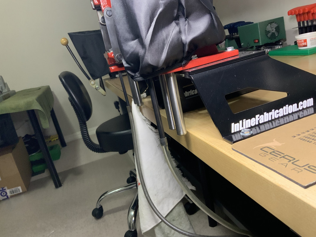

The 7.5 ultra mount would be the shortest you can go. Pic is with standard height ultramount.

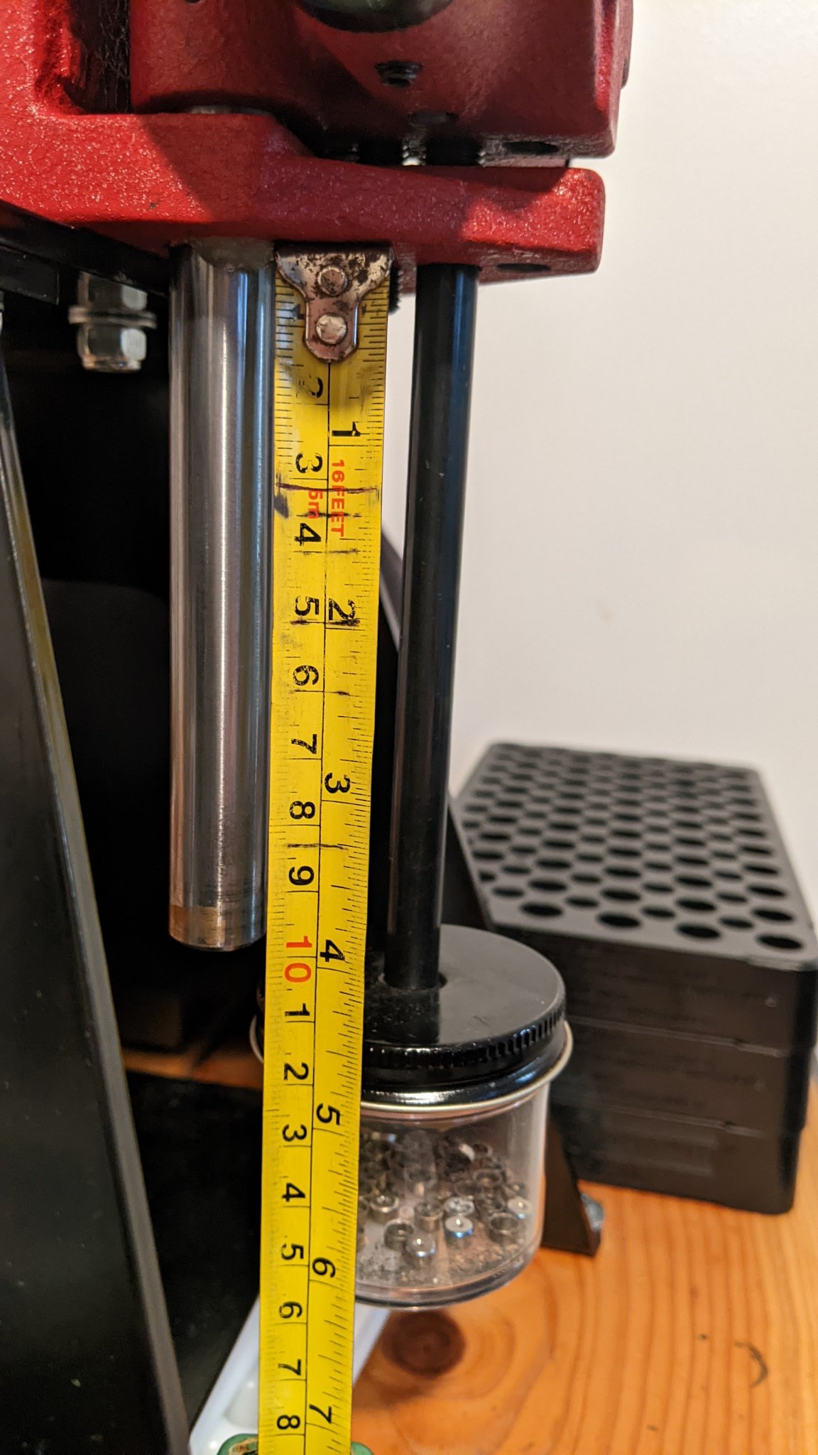

Just a smidge too long. The guide rods extend 4 1/32" from top of the plate without the primer catcher. If you want absolutely 0 contact, the 4" Micro Quick Change Ultramount + #8 Quick Change top plate should give you around 3/16" (6/32") of extra height.

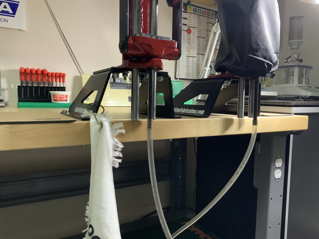

Here’s my two Co-Ax’s with the 4” mounts. I moved them forward so the rods are just in front of the bench (no conflicts).
I do use the quick change plates for both of my 4" Ultramounts. I make sure the rods have about 1/2" of space from the bench face. Obviously the primer tube has plenty of clearance too. I like the quick change plates enough that every press I own has one and I use their plate mounts to hang the one's not in use on the wall.
