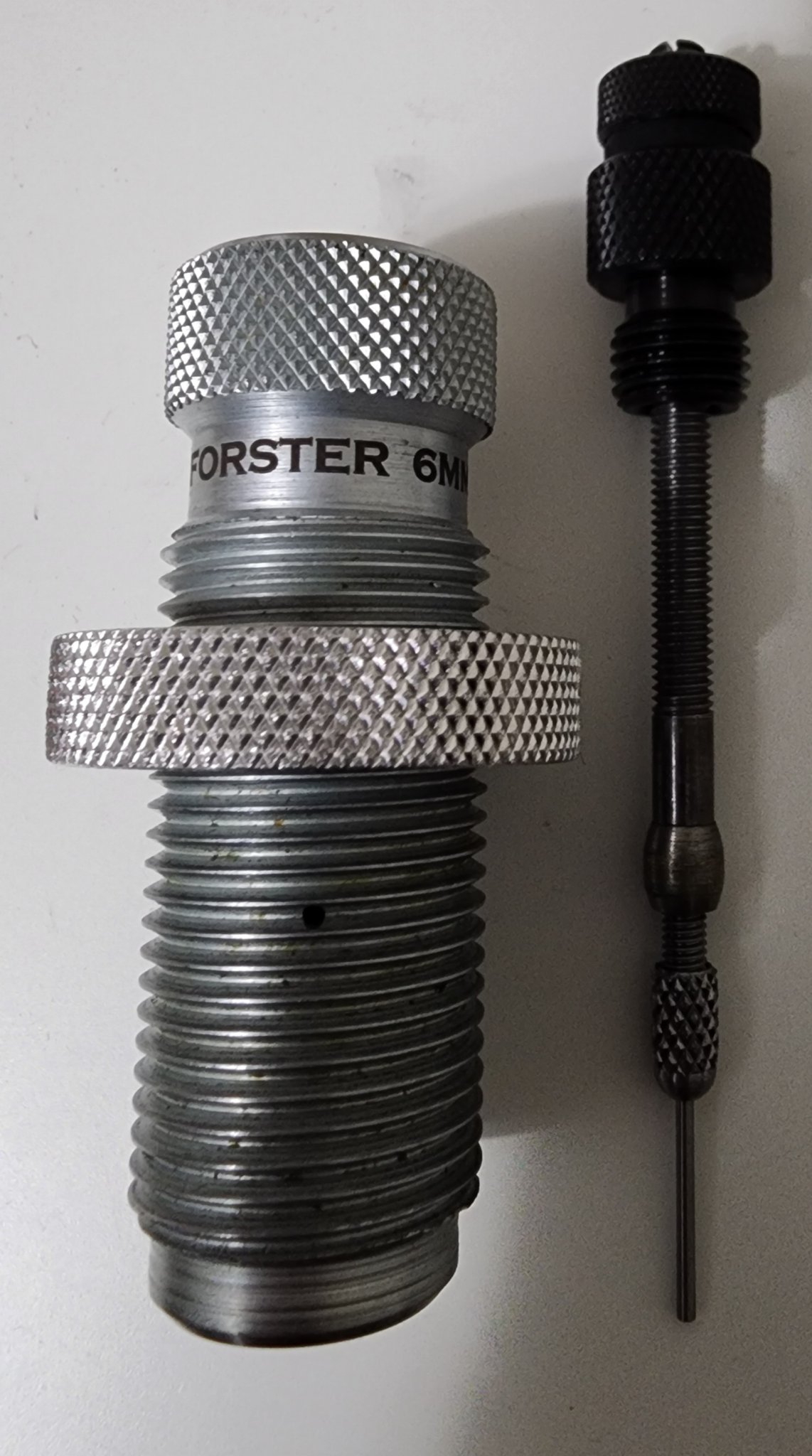

New die, followed the instructions included to set it up - twist in until it touches the raises ram and then another 1/8-1/4 turn.
Lubed the once fired brass inside and out, raises the ram but the brass has way too much resistance. Feels like it goes easy for the first quarter and then I practically have to hang on the ram handle to push it in. That's where I stopped. Also tried the same with new, unfired brass, same issue.
Alpha brass
6mm Dasher
I also tried removing the whole recapping unuty (that has the depriming pin and the expander ball) and run the brass just in the die body. Same issue, gets too much resistance at the same 1/4 way in.
New to this so it's likely that I'm not doing something right but I'm not sure what.
Thank you

Have you inspected the inside of the die? Too much lube can be a problem so try cleaning the inside of the die out really good with some type of mild solvent/degreaser. In a pinch try rubbing alcohol or something of that sort if you don't have anything else (not WD40 btw).
This is not something easily diagnosed from afar.
After you clean the inside of the die out really good try raising the ram and screwing the die OUT about 1/4 to 1/2 turn and try again.
I would also highly recommend leaving the decapping unit out of the die until you figure out what the problem is.
Also try another brand of brass if you have any.
I am just throwing ideas out to see if anything sticks.

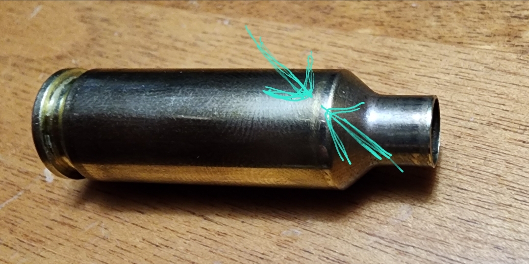

Noticed the following ring just below the shoulder. Not sure if that's an indication of anything?

Forster FL dies sizes the case almost back down to factory size if not smaller. Measure base & should neck junction before and after sizing. I’m guessing is sized the shoulder body junction down about .005 or so. Check the OAL before and after and note the difference. Could be die is out of spec or your chamber is not a match for that die meaning chamber is larger than the die which requires a lot of force to size the brass all the way back down.
