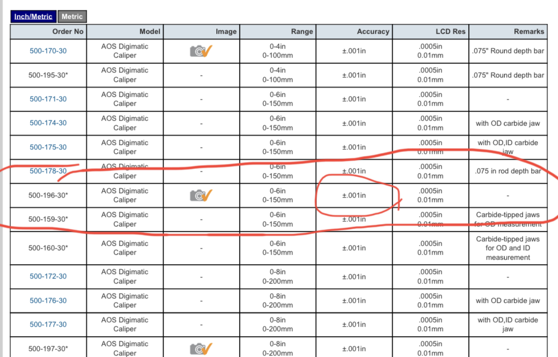

    Two things that you should know. First off, it’s extremely unlikely that your calipers are capable of accuracy to less than 0.0005” anyway. I’d bet on it in fact, unless you paid much more than $200US for them. Second, bench rest shooters would never want to bump the shoulder back more than 0.001” and typically prefer neck size only for very specific reasons.
    You are worrying about a thing that doesn’t matter. It’s not uncommon with first time loaders, so don’t take it personally.
    This!! I always thought this was bull****, but then I upgraded my $30 amazon calipers w/ 0.0005 resolution to mitutoyo. The amazon ones were off by a whole 0.0015"!!! There was a very very small air gap at the top of the calipers you could barely see at the right angle.

    Also, for what it’s worth, I’m using Mitutoyo 500-196-30 AOS calipers. They aren’t quite $200, but they aren’t cheap and I know a lot of people use them. They are pretty darn accurate and repeatable (enough for what we are doing anyway. All that said Im guessing that once I test the sized case in my chamber it’s probably going to to be just fine. Thanks for your input. Much appreciated 🙏🏻.

    For those interested, my comment above about accuracy was not meant to be a slight or exaggeration. It’s just a simple fact of repeatable accuracy. I have those same calipers and here’s the actual accuracy expectation from the mitutoyo website:
    Thus, my comment on not worrying about what that ten thousandths digit is telling you. Just because the digit displays does not mean that’s the level of accuracy you are getting.
