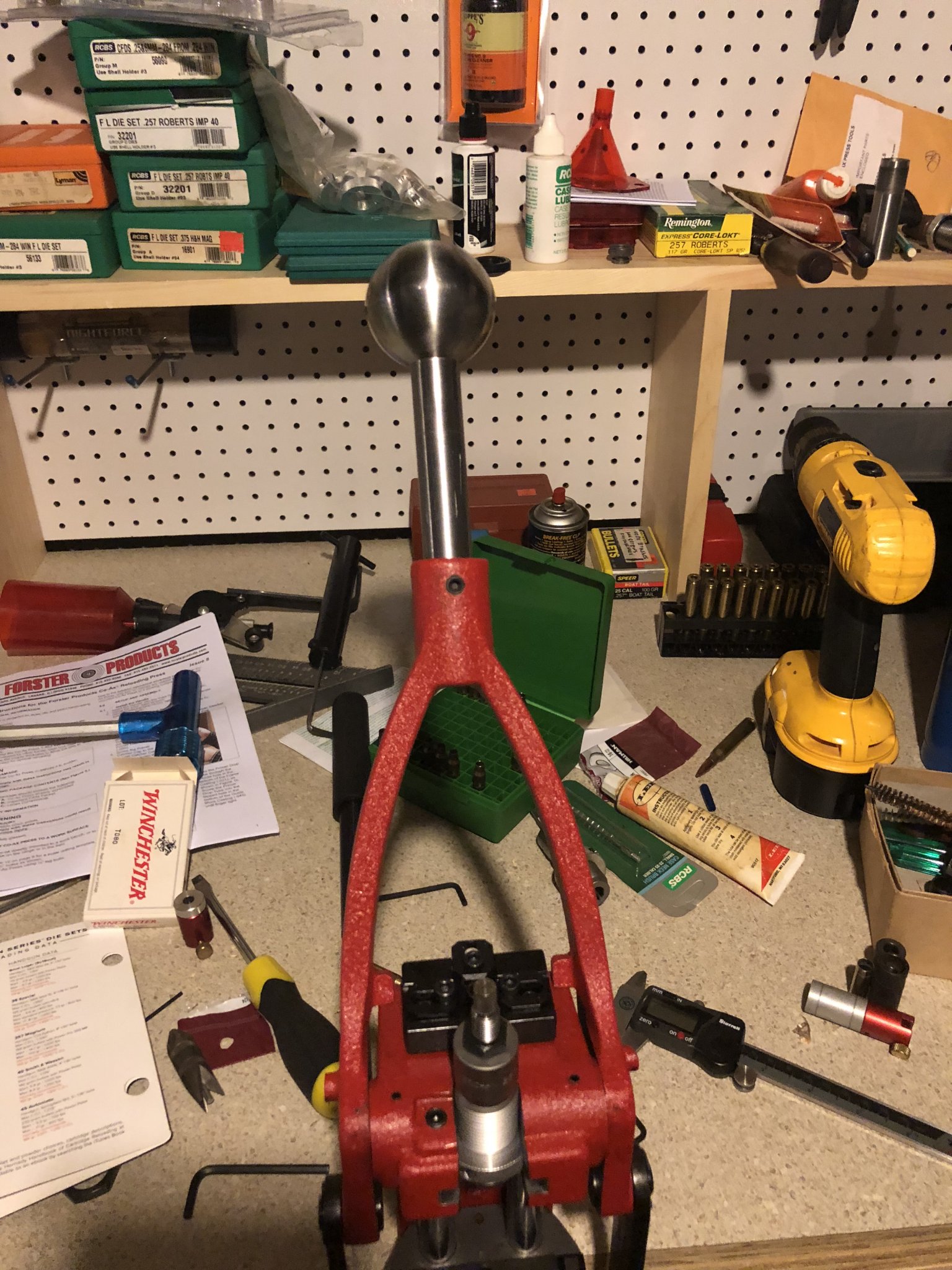

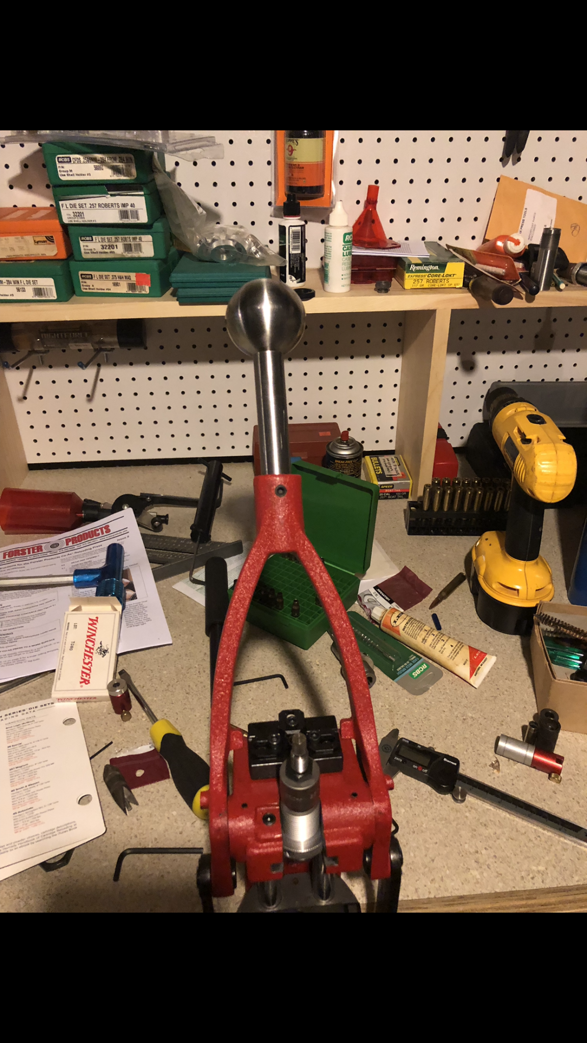

Love my press the only thing I changed was I made a custom handle.

Uhh where can I get one of those? The only bitch I have is the handle is too damn long and makes me have to step to the side while operating the press.
Ummm...you know that a set screw is the only thing that keeps it on right? An appropriately sized piece of metal barstock can be had at your local metal supply and chopped to whatever length you desire (You can even thread it for a ball if you want). Just saying... :)
