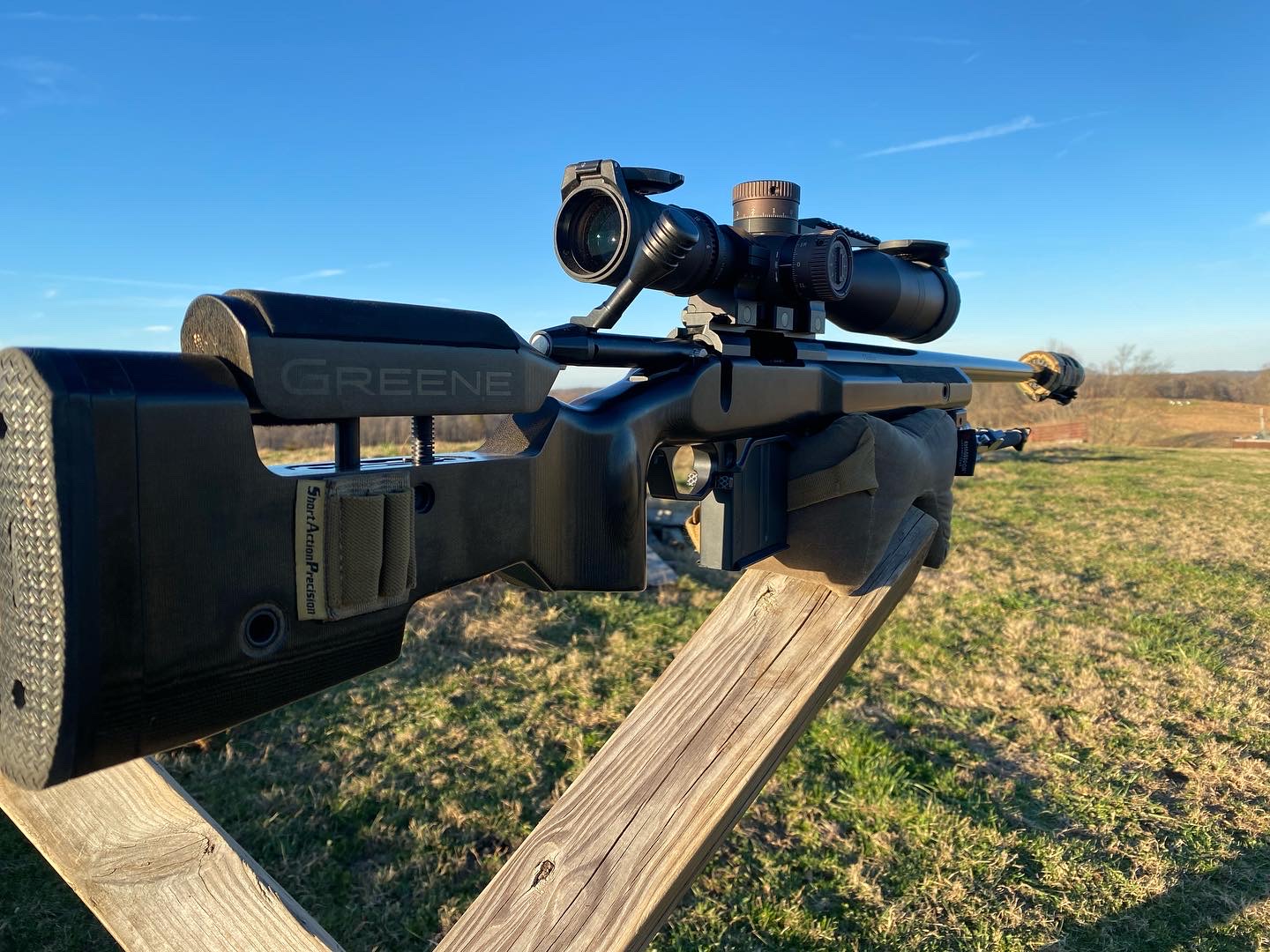

Will also depend on what optic and mount combo.
My centurion (standard fill) is as follows.
28” HV 6dasher. Omega suppressor
John wells lead weight slugs only filled from front to about first 2/3. Leaving out the last 8 holes.
Gen 3 razor and Hawkins 1 piece mount.
Rifle weighs right at 22lbs. With optics around the 40-45oz range and larger mounts mine was a touch rear biased. After adding the lead weighs it was enough to bias it a hair front which I prefer.
I work with my rifle til I get to the perfect feel for me. The rifle should pretty much drive itself if that makes sense.
I actually use the barbell on my bench with bag changer as the setup jig. Lol.

Does the Razor tends the bias the weight to the rear a little ?
This gen 3 is 45 oz gen 2 was 47 oz if memory serves me correct on both numbers. NF is 39.x Tangent is like 40.5 oz ETC. I was just meaning each persons setup will vary slightly. Also each persons preference of balance. I'm running a 1 piece mount prob about 5oz-6oz? Idk for sure. But these things in mind, changing weight slightly based on each persons specs.
I also have my second Centurion which will be here next week. I went with the lighter cut which hollows out some of the rear under the check riser etc. I messed with a loaner for a couple of weeks in the light cut and it seemed to naturally balance better than my standard did out of the box with my particular barreled action setup.
My thoughts is that micarta is a fairly dense material to start and with a large portion of it being in the rear may lend it to being more rear heavy etc. My stock got delayed due to the snow and so according to UPS the light version should be here Monday. And I can try and give more feed back then.
Again I am no professional just my personal experience thus far!
