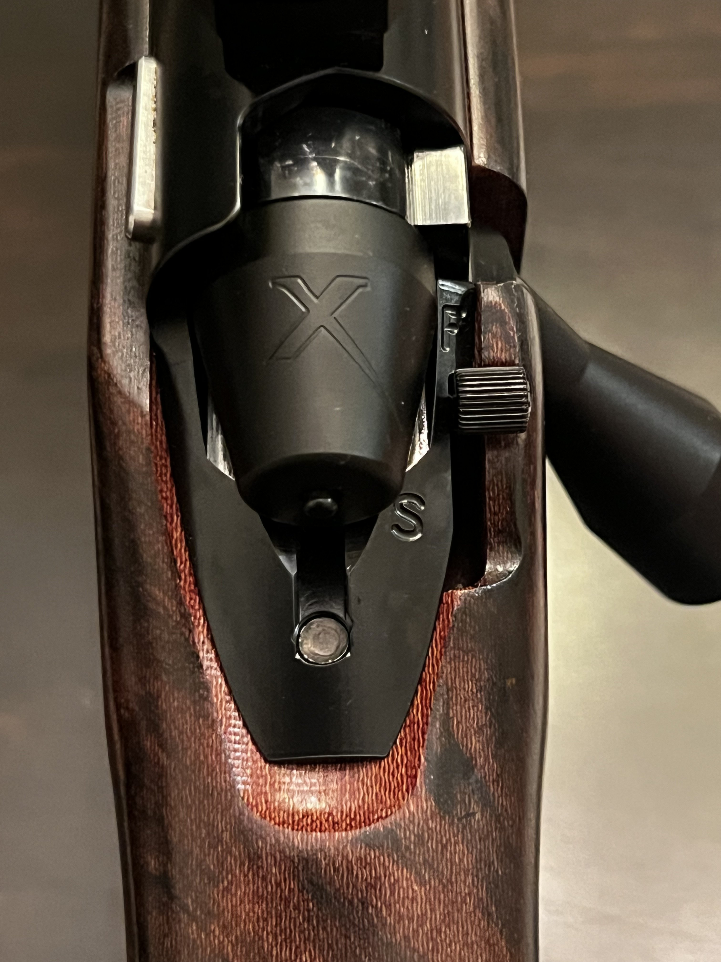

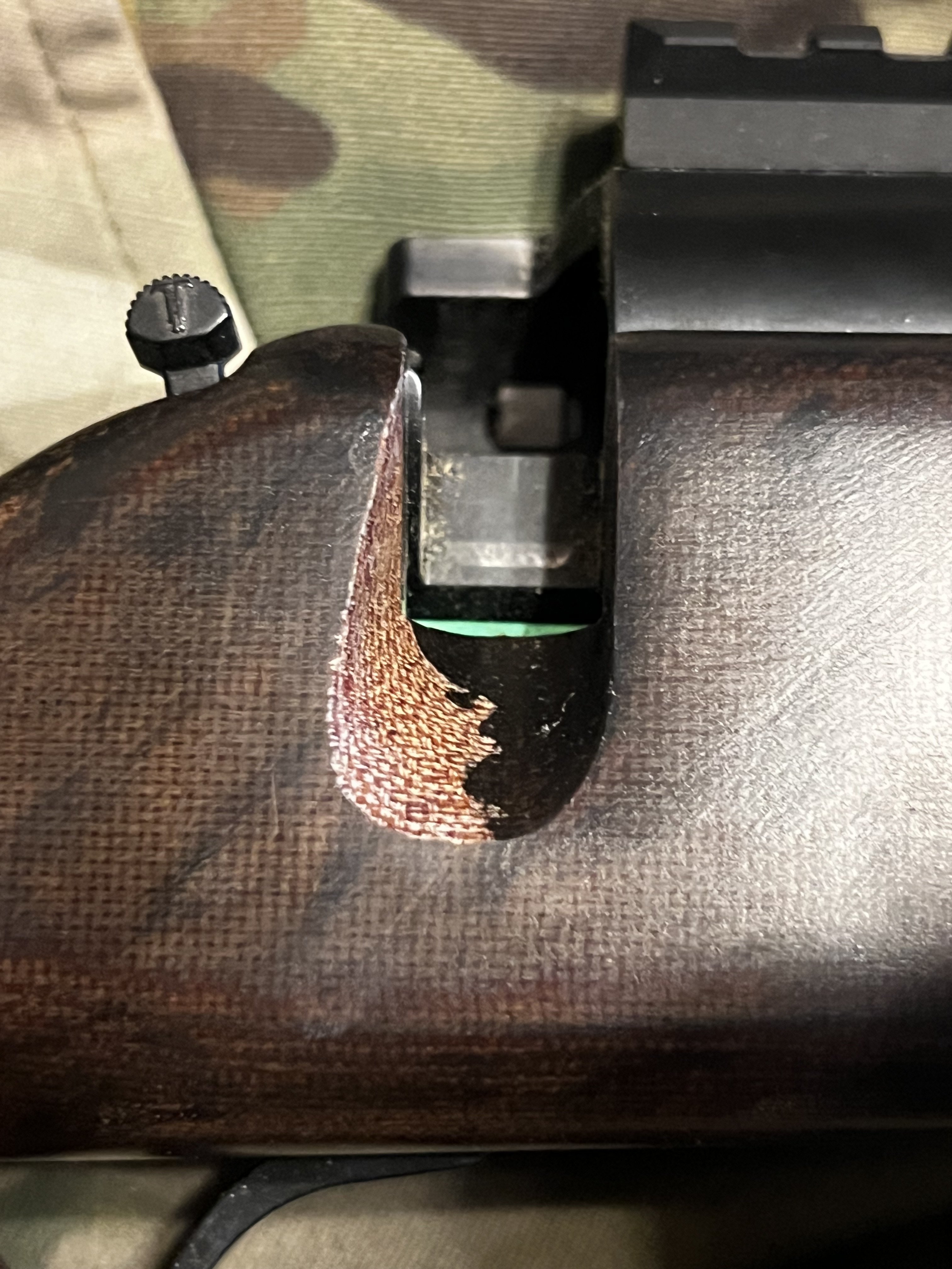

For what it’s worth, after coming across this thread, I began looking for and missed out on a couple foundation stocks inletted for both Rimx and impact 737 in the market place. being too impatient to wait for a new foundation build, I decided to buy an in-stock Impact 737r foundation MG2 from bullet central during the Easter sale and make my RimX fit. Turns out it was pretty simple.
First off the RimX dropped right in the inletting, the only interference was the rear swept bolt handle, which I expected.

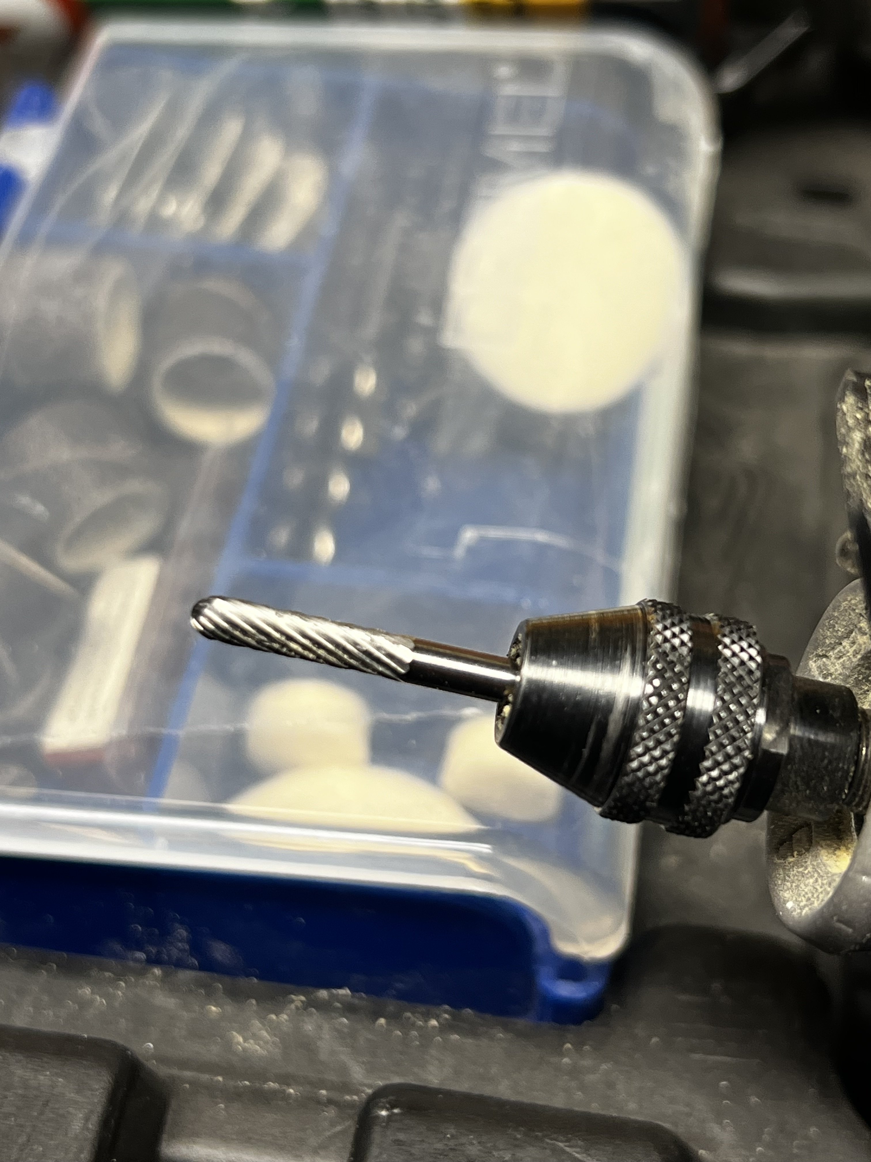

I used a steady hand and a Dremel with a carbide cutting bit to slowly open up the notch for the bolt.

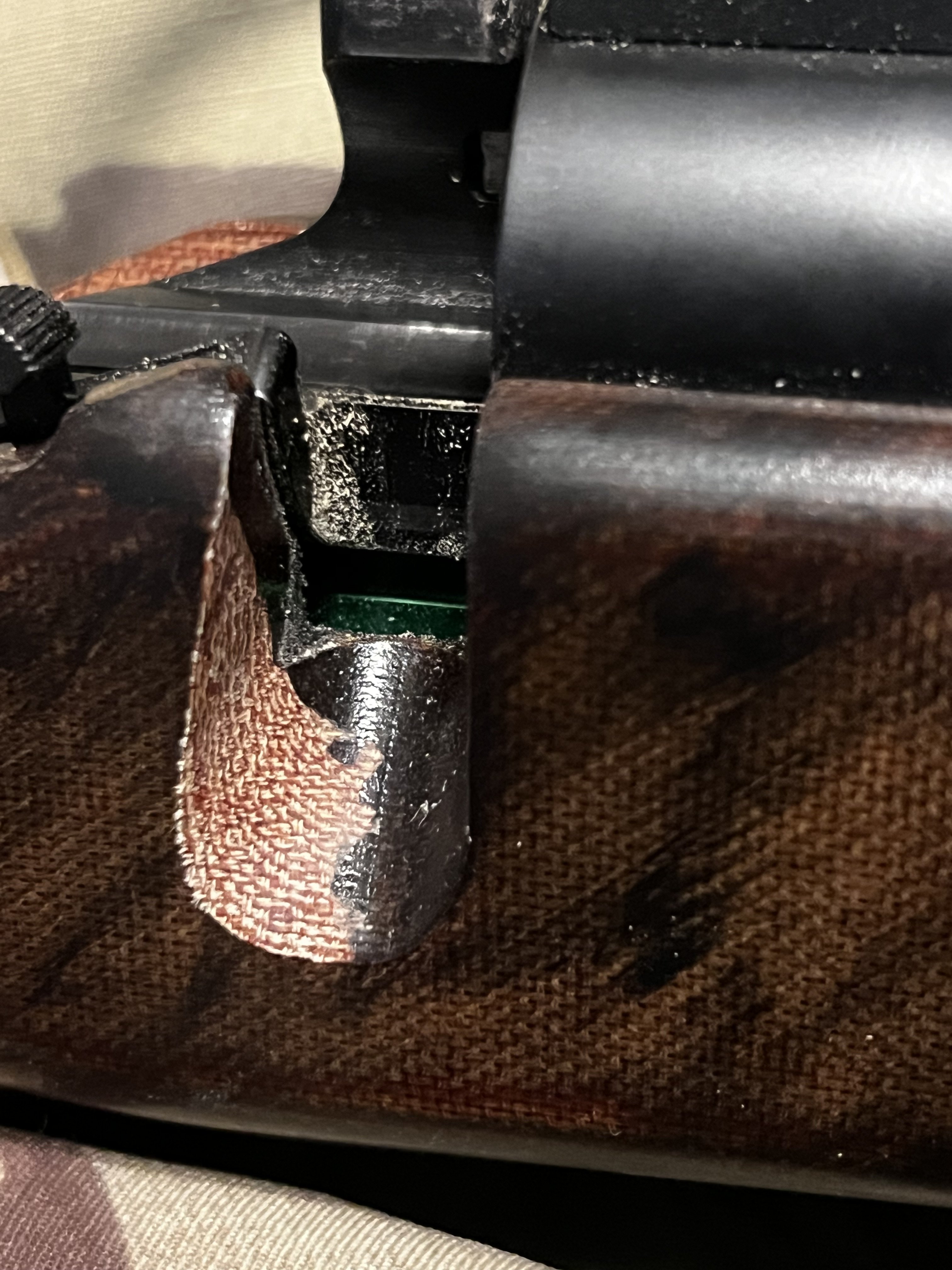

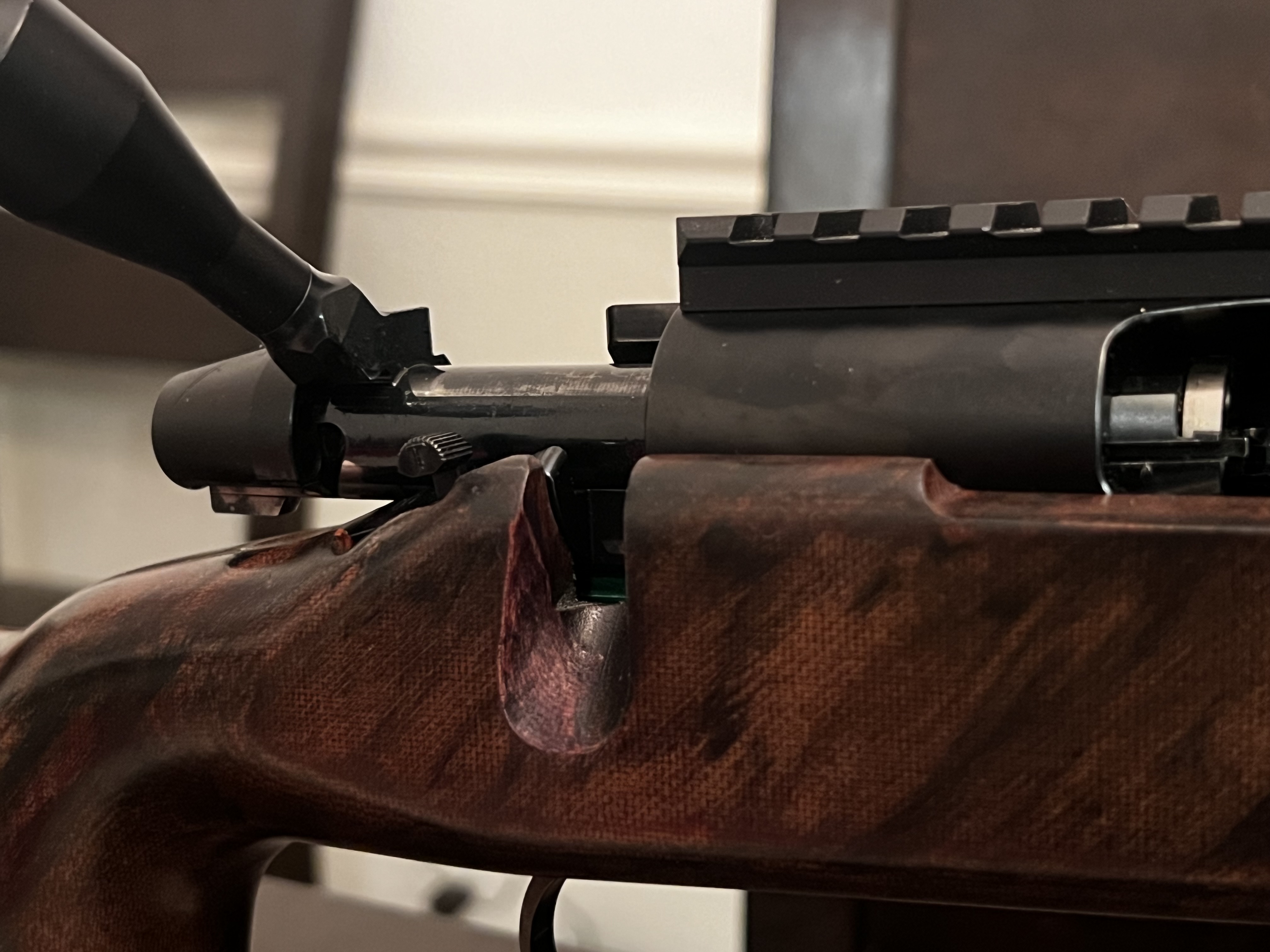

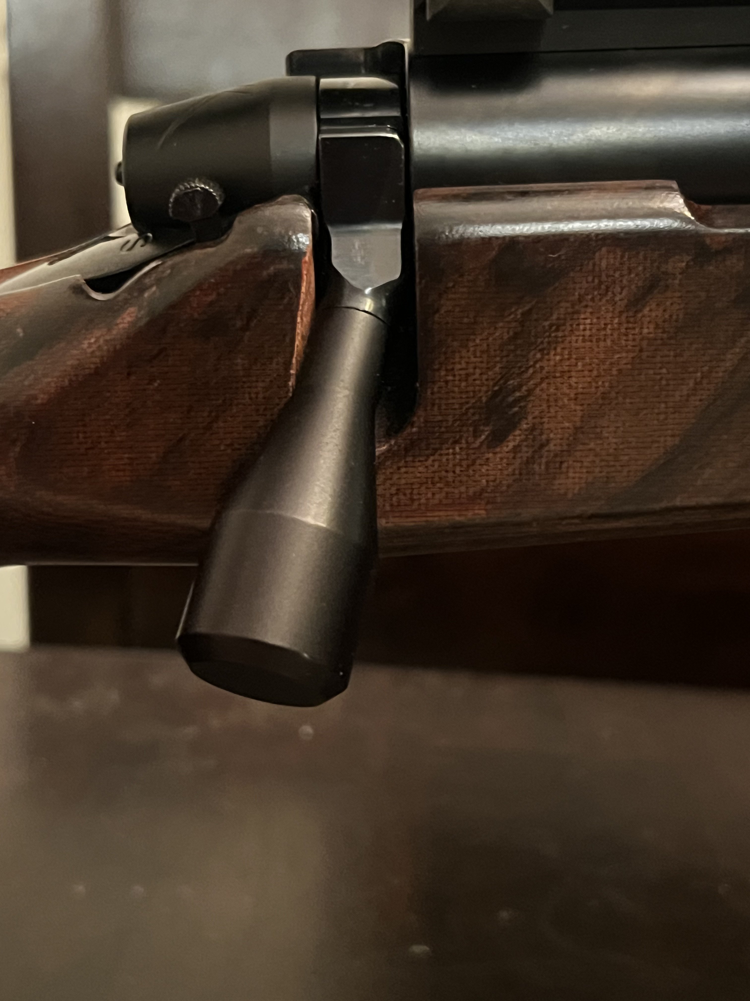

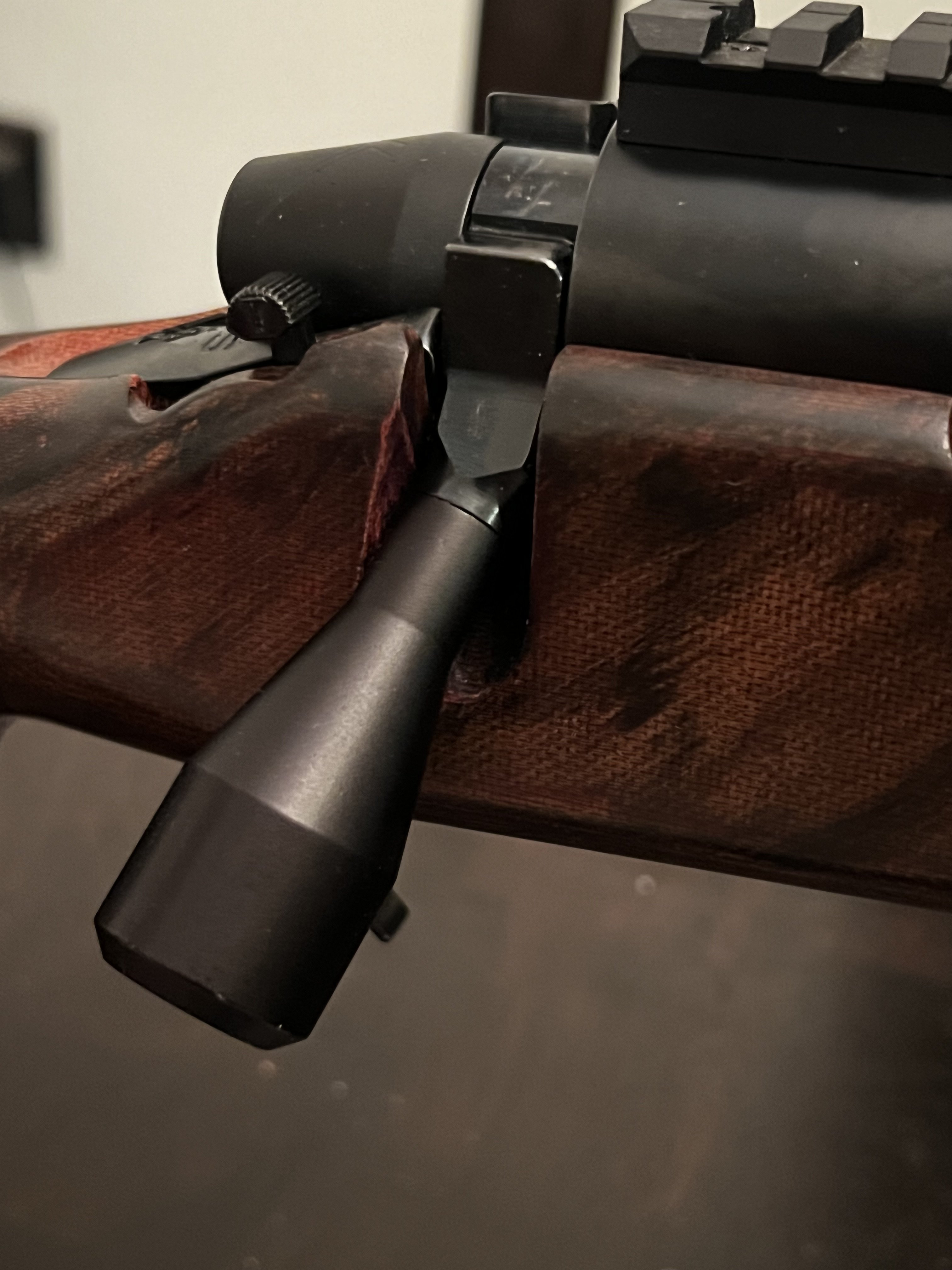

I slowly worked on the rear edge of the notch, frequently checking the clearance with the bolt knob. This is the result.
After it was fitted i used some 600grit sandpaper to smooth it out just a tad. Then used the ghetto method of a few rounds of applying black sharpie immediately followed by smearing it while it was still wet. I think it turned out great, matching the dark distressed color and took lest than 30min to do the whole job.
