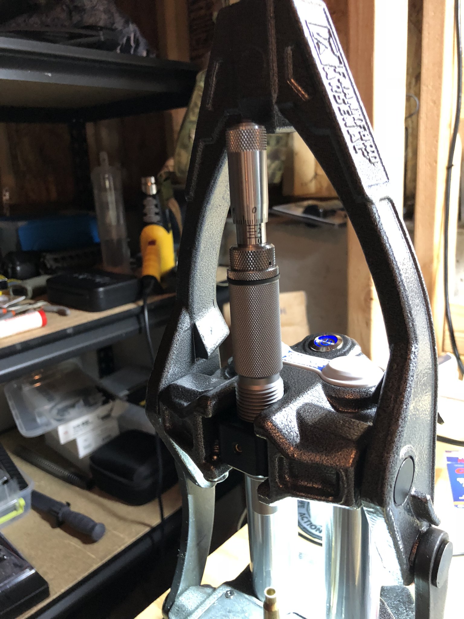

Well I'm returning it. I didn't have a problem with the sizing die, but I did have clearance issues with the micrometer on the top of my seating die. To get enough clearance for the arm I had to screw the die in so much that it would bottom out on the brass at about half the stroke. I had really high hopes.

Well I'm returning it. I didn't have a problem with the sizing die, but I did have clearance issues with the micrometer on the top of my seating die. To get enough clearance for the arm I had to screw the die in so much that it would bottom out on the brass at about half the stroke. I had really high hopes. View attachment 7064088
Ummmm, get rid of that Hornady die, they are not the way to go. Get a Forster or Redding seater, they will give plenty of room. Hornady is not a chamber die and leave too much run out.
