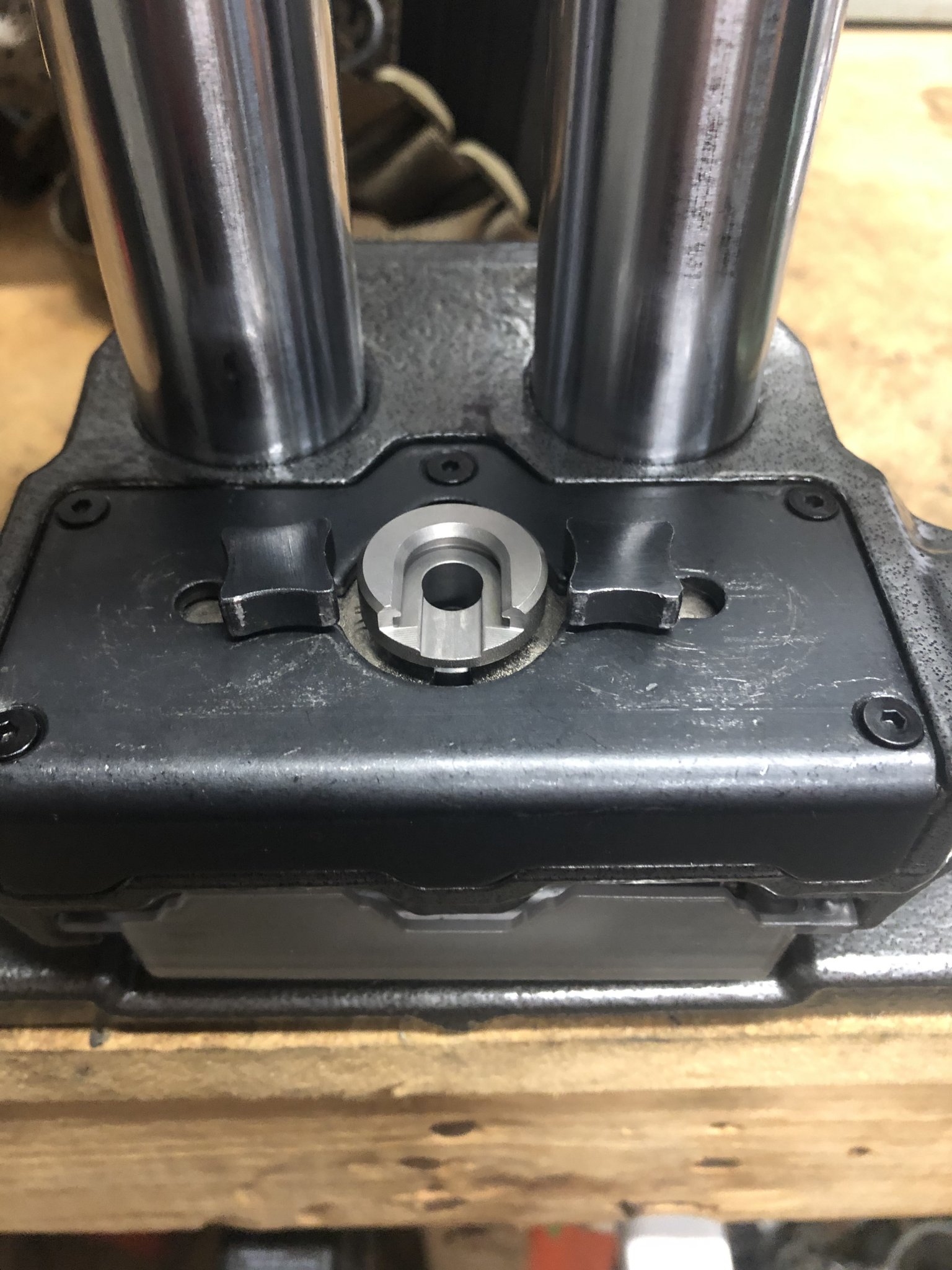

Close up of the universal shell holders (retainer plate removed). The bottom of the die butts directly to the top of theses.
Unlike the Co-Ax, these spin in place to reveal 4 different caliber choices: Large, Small, .223, and .308:
Too thick @ .1285" ?

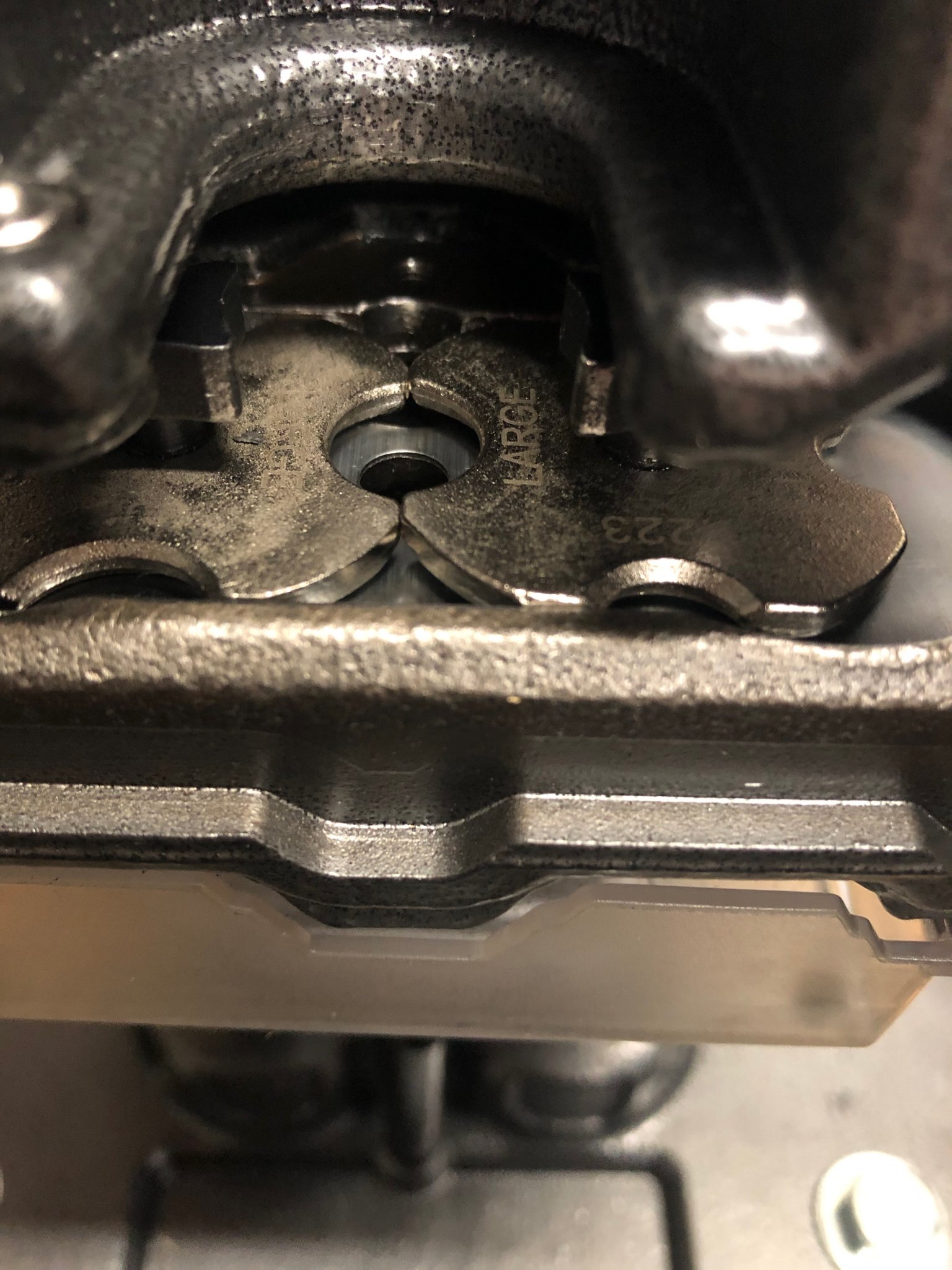

ON the bushing bump die, I can't even get the shoulders to touch the top of the die. It's worse than the FLS die, as you can see from the grease line below. I put extra one shot wax on a shell to locate how far down the die was making contact onto the neck and shoulders. It doesn't even make it to the shoulders It appears.

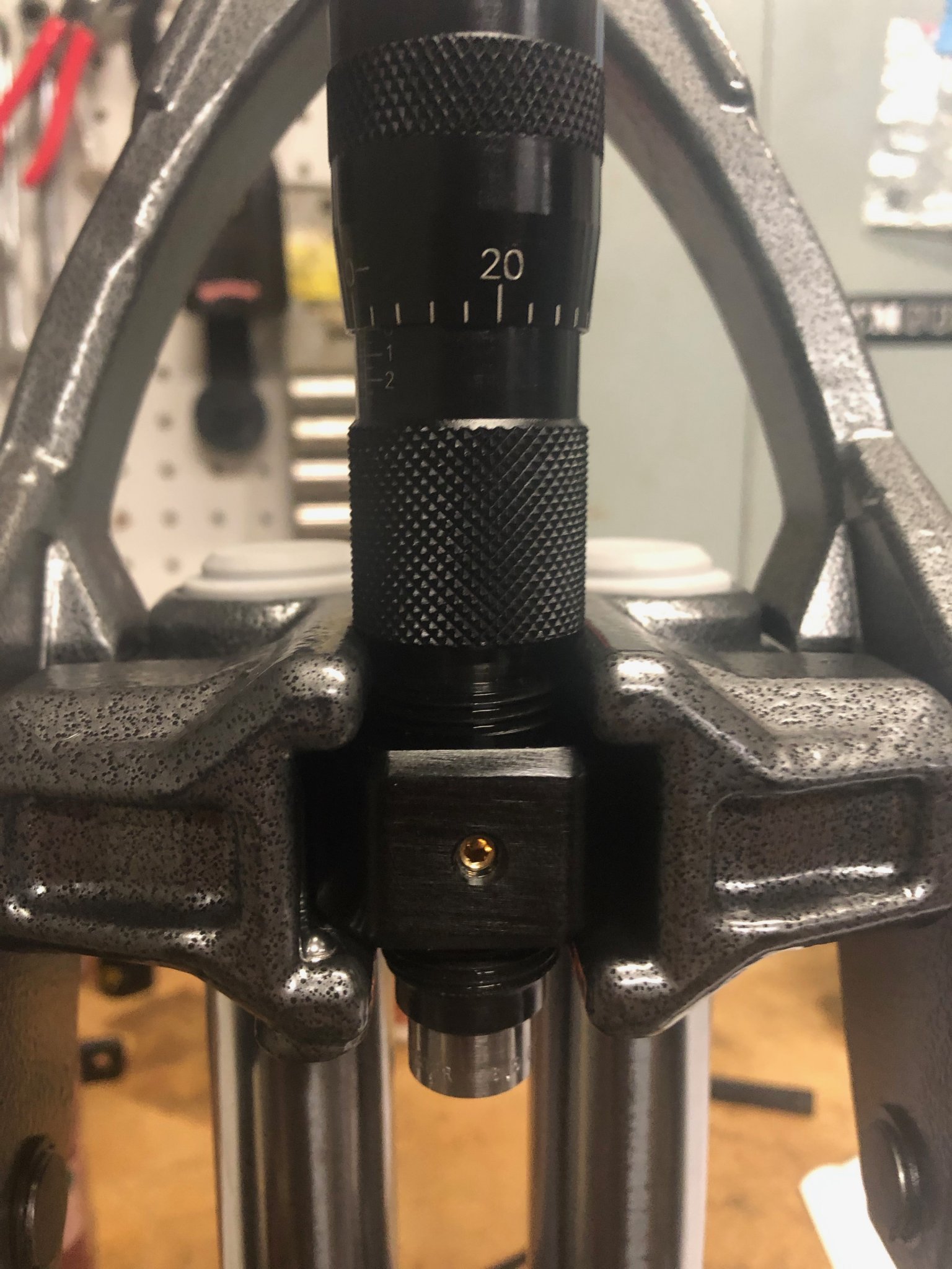

Problem area - fitting large dies deep enough without hitting the Press Fram:
If your case shoulders are not bumped, die to long or shell holder too big. Check the die in another press.
Solutions are to call and deal with frankford, or trim the die down.

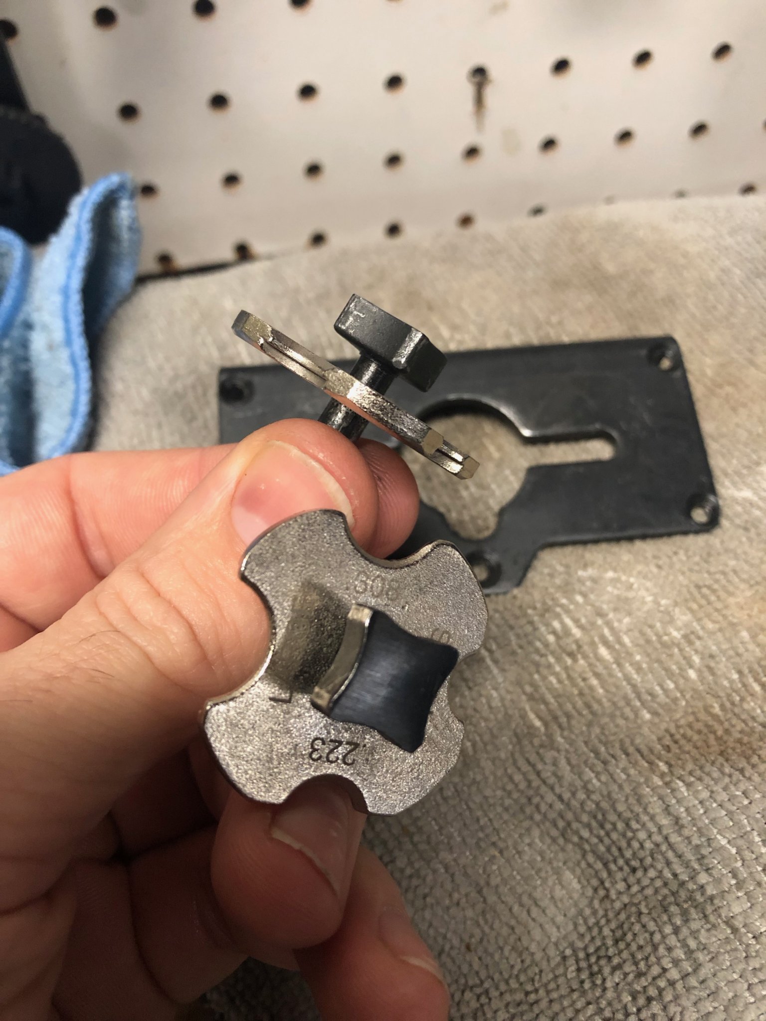

Thanks - this confirms what I suspected. I also figured out a way to use a regular RCBS shell holder in this press. If I flip the universal shell holders to the “Large” size, a normal shell holder fits in perfectly. I then remove the separation pin which is engaged at the bottom of the stroke so it doesn’t let go of the shell holder at the bottom. Works perfect this way, even lines up perfectly to the deprime hole.
This also solves the issue with my seater die hitting the frame of the press as it raises everything up the height of the shell holder. Dies now work as intended, but I’d like to get it working as it was designed. I’ve contacted Frankford, because I don’t want to have to mill down every die I have for this press.

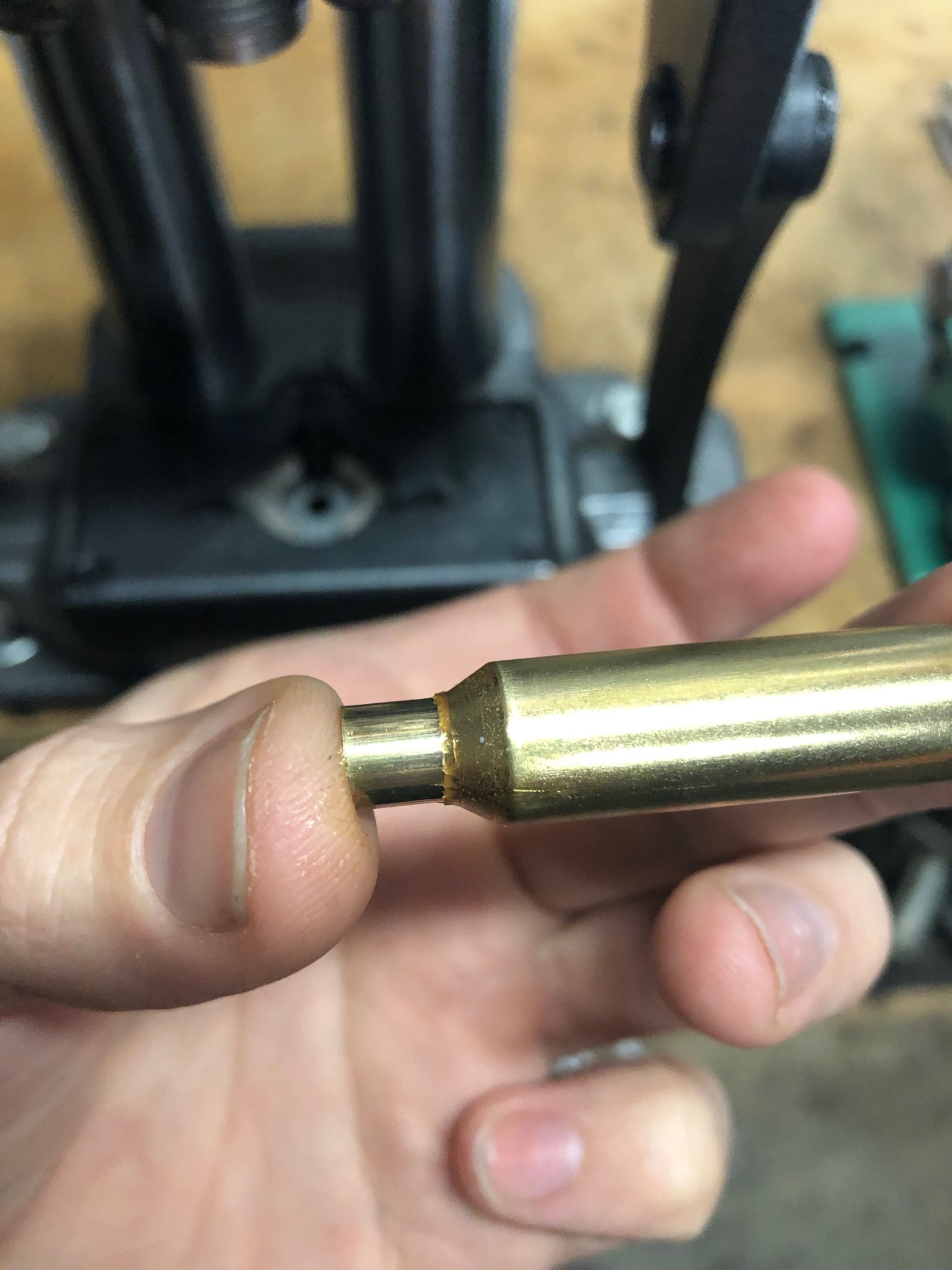

What is going on here with the neck? This isn't right.
Forster bushing bump die - all that engaged was the neck down to the grease line just before the shoulder you see in the picture. It touches the shoulder now, and all is well.
I put a ton of grease on this one to indicate how far down the die was reaching. The smeared grease looks strange in the picture, but once wiped off the casing looks normal.
Are you seeing something else besides what I explained?
Explanation nailed it! Looked funny.

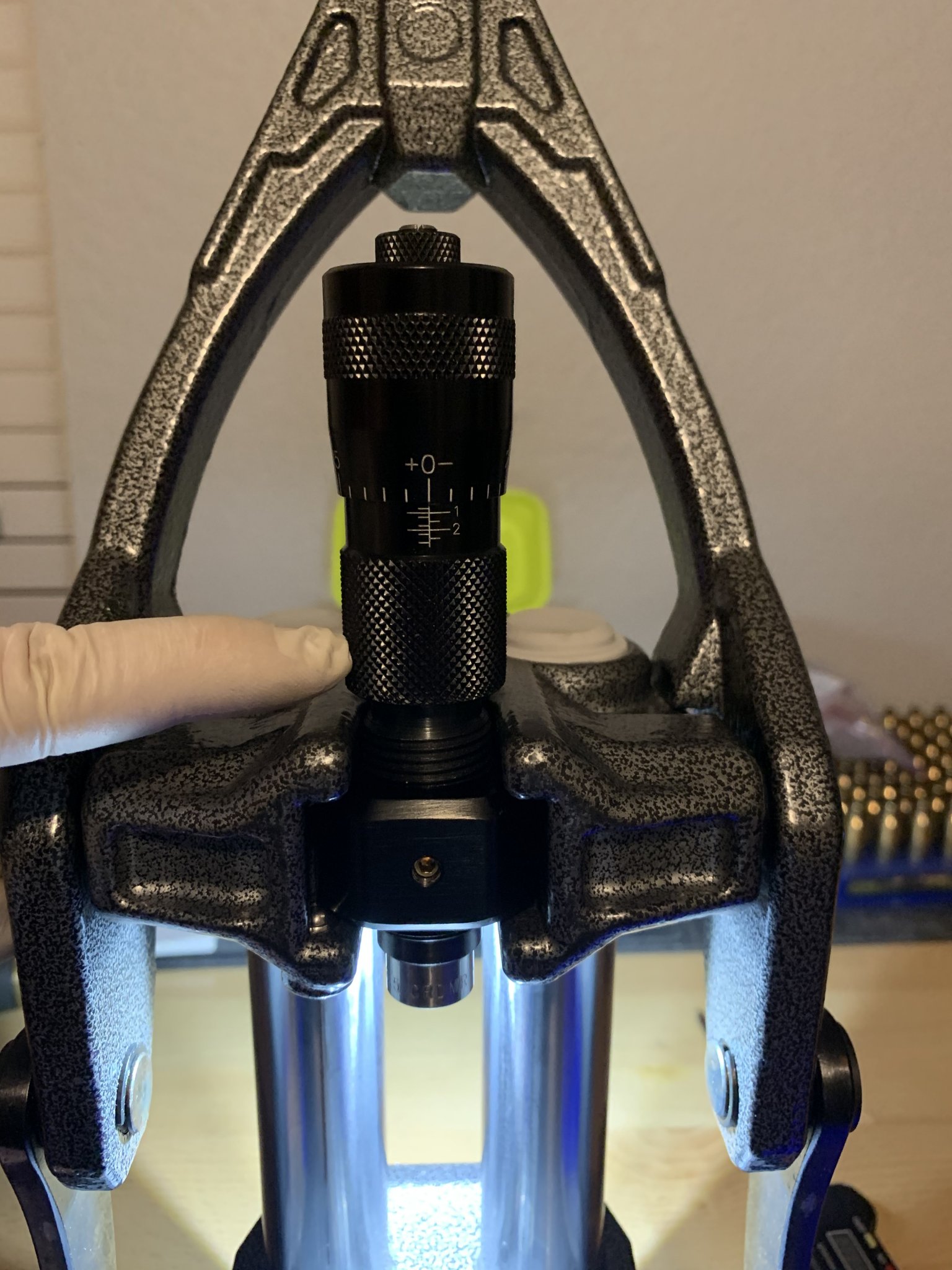

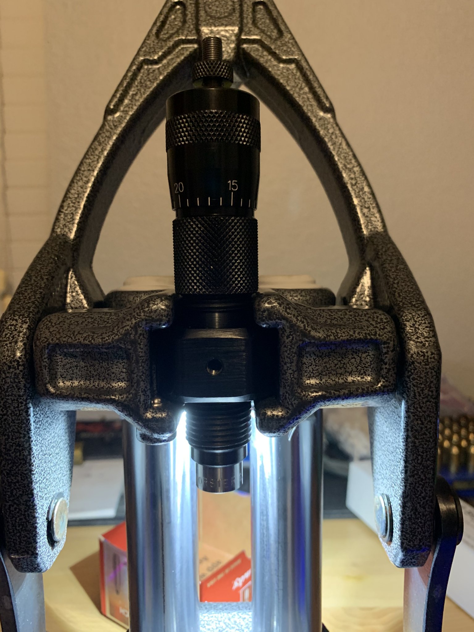

Hey there. Had a question about using the Forster Mic Seating die on the M-press. I am using the same set up and don’t think/know if I can getting the die ‘deep’ (Down) enough to make the necessary contact with the bullet/cartridge. I am getting it to seat, but not really getting to the point that the spring is being depressed. Your pic above (of the seating die) is what I am speaking about. Was the corrected shell holder thickness the fix? Or are you continuing to use a ‘classic’ style shellholder in the m-press universal (you included and pic of this as well)?
Did you ever get this resolved? I just got this press and had the exact same issue - I can't screw the die down low enough because it hits the press.
