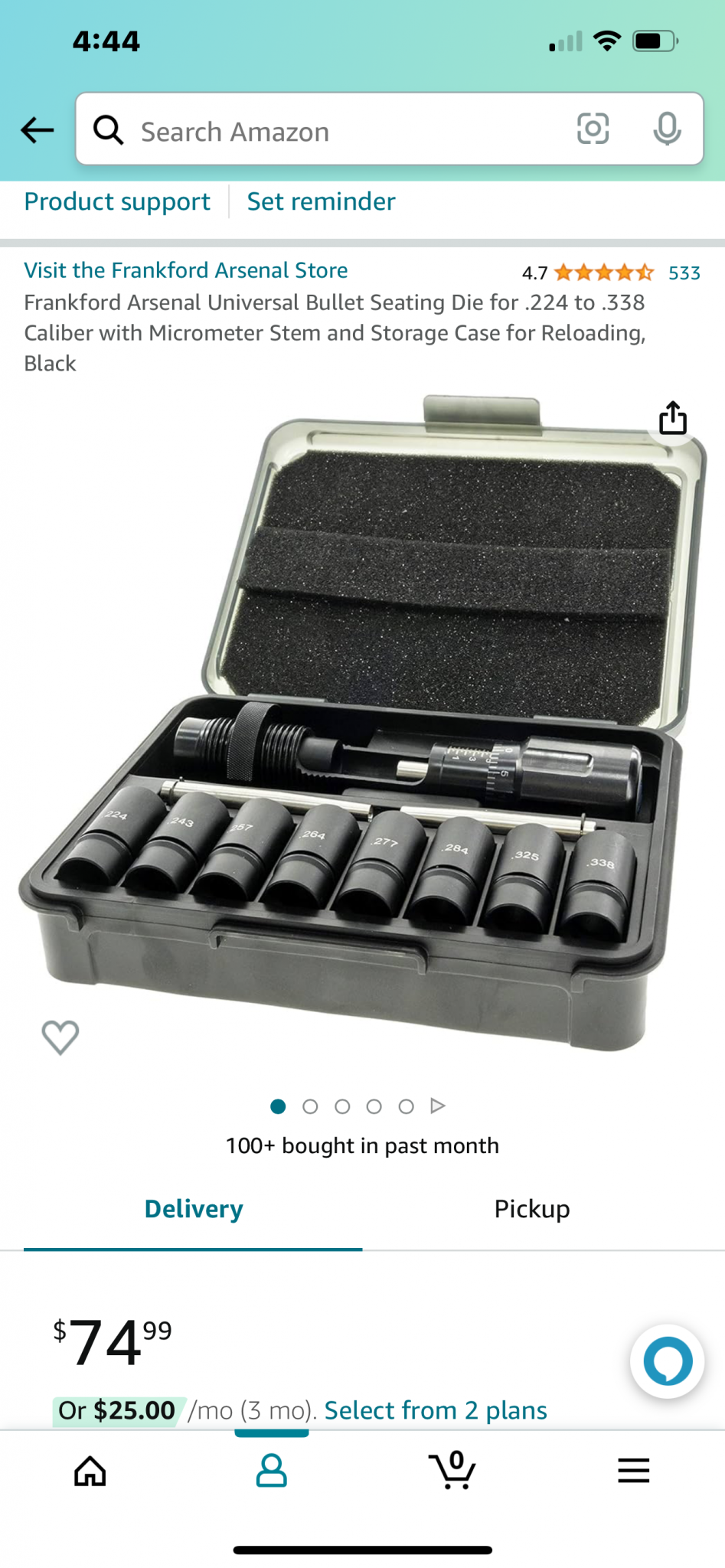

I bought one of these a few weeks back and have used it to load 223 and 300blk thus far. I like it. Anyone else using this die? What are your thoughts? I like being able to drop the bullet in the die window as opposed to balancing it on the case mouth and it seems to seat within. +/- .002. Usually .001.
Reactions: MO Fugga
I used it to seat some 78 and 88-grain 223 bullets recently and it did a great job with those. With the 300blk, I had to use the 22-caliber seating stem because the cases are too short for the 308 stem. I ran out of die body thread before I was able to get the stem to seat the bullet to the proper depth. Worked fine, just something to be aware of. They were not thinking of short 30-caliber cases when they designed the 308 stem.
