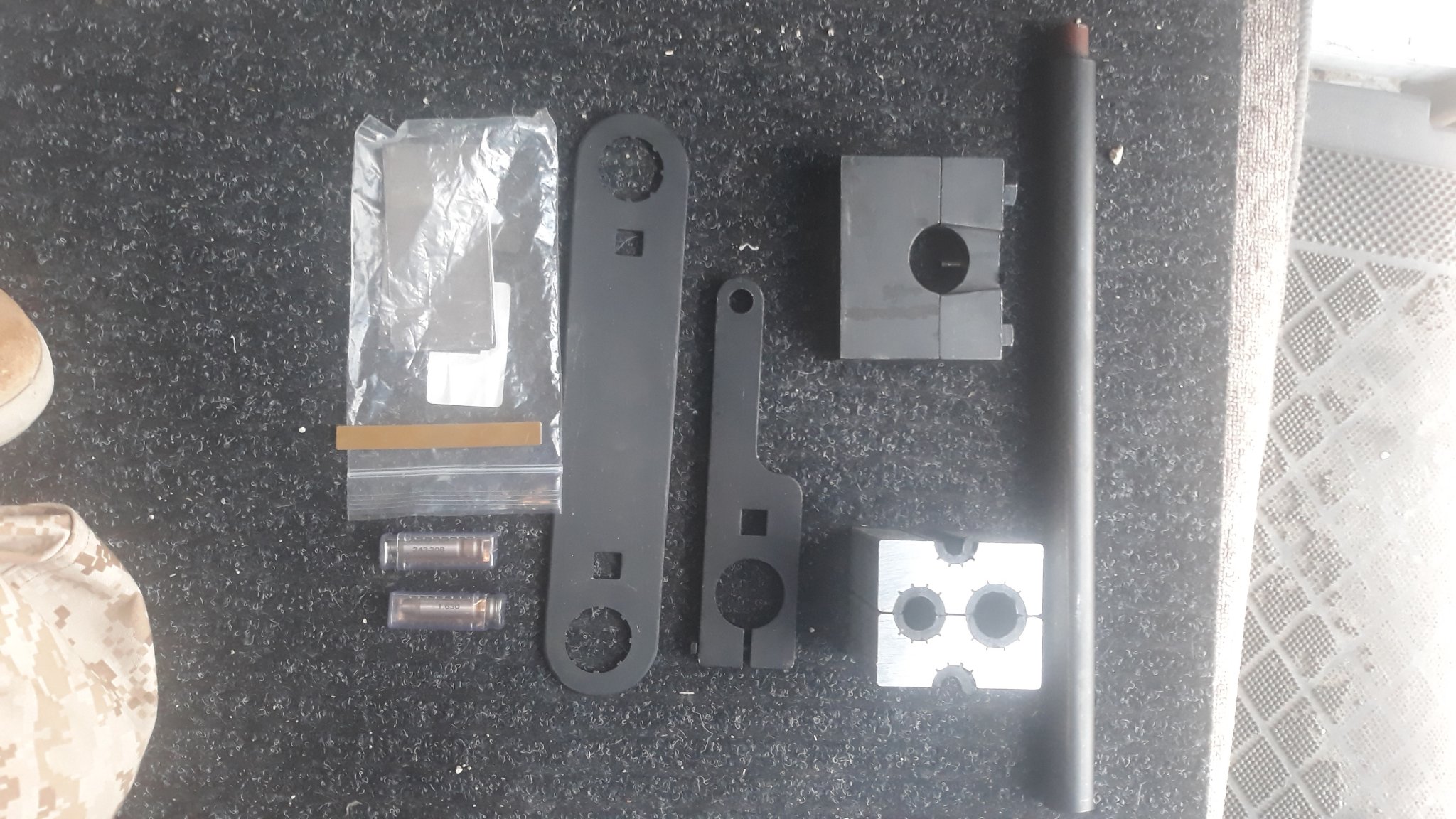

FYI, I received the tools today. They include the following:
1) the barrel vice,
2) the action vice w handle,
3) .308 gauges
4) barrel wrenches and
5) shims
I will contact motoflier to ship to him in a couple days.

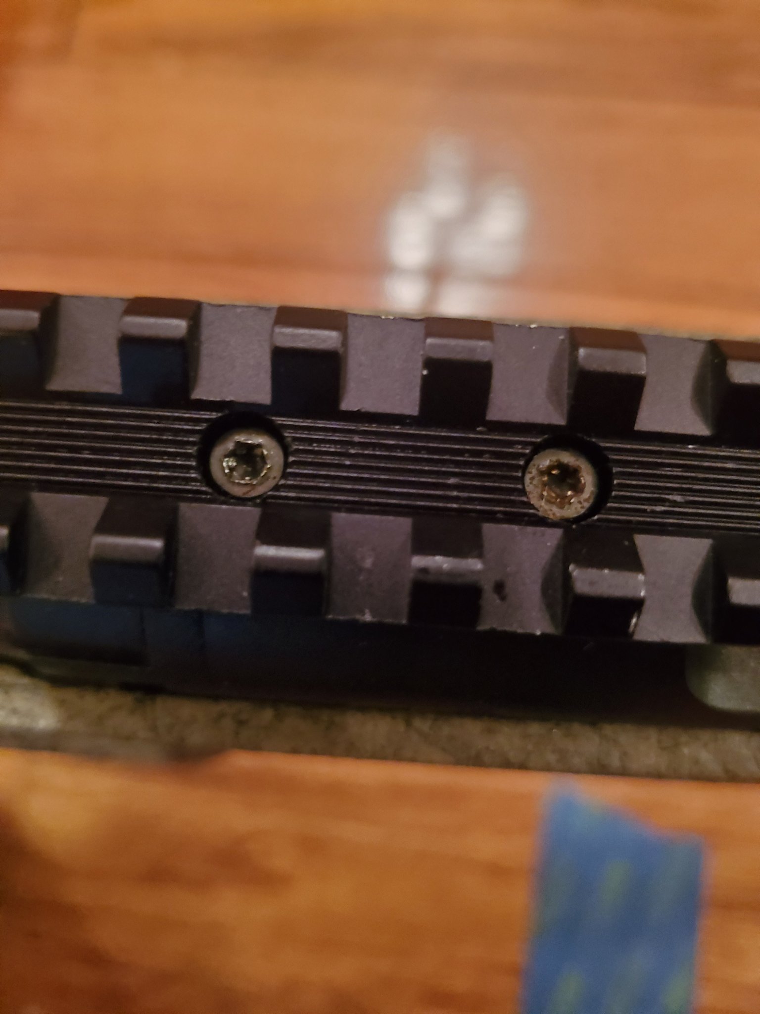

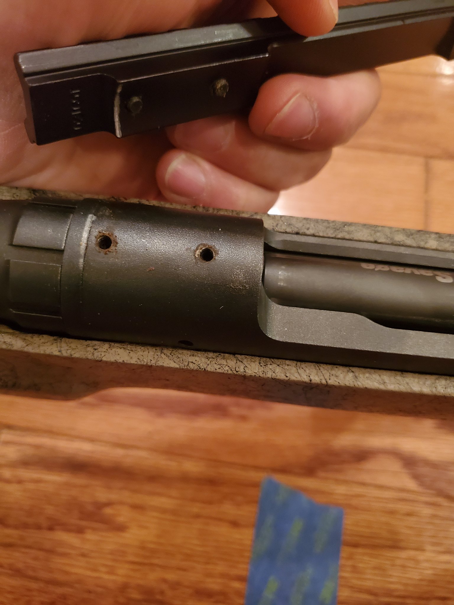

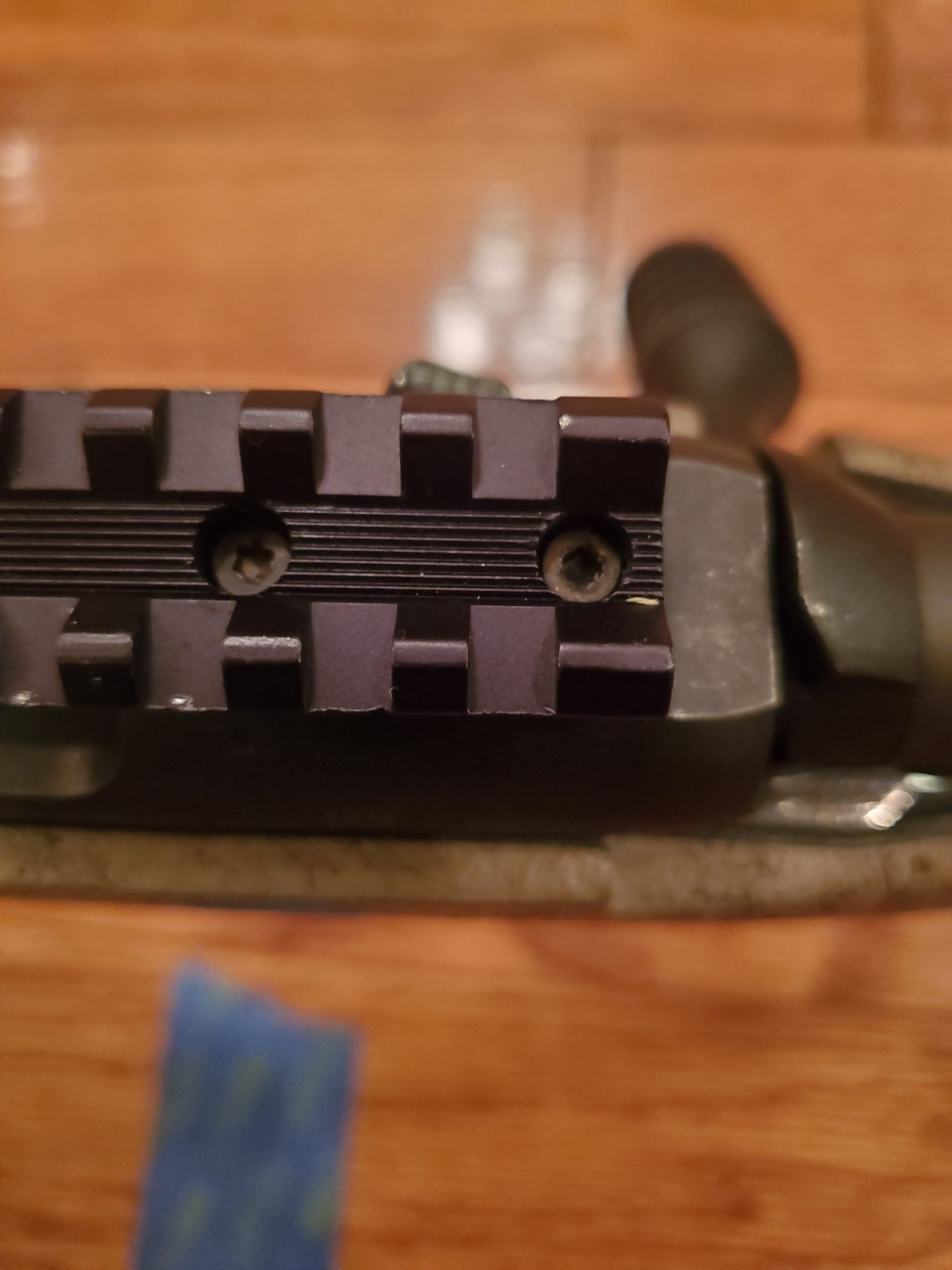

Tools showed up!! Got excited and dug in right out of the gate Previous owner completely stripped out 3 of the 4 base screws. Gonna work on it after dinner worst case I will drill the heads and pray enough sticks out to get ahold of. The rail hangs over the nut so no short cuts and honestly I couldn't leave it now that i know it would drive me nuts. GAME ON!! hahaha
Reactions: dspjaggar
I win sorta the base was actually mounted backwards to the point it was digging into the lug and not sitting flat. This is likely why the screws were stripped from trying to "Crank" it down flush SMH. Good thing I'm doing the barrel swap so I can go over everything I cant imagine the headaches trying to work up a load for the first time in my life would have been hahaha.

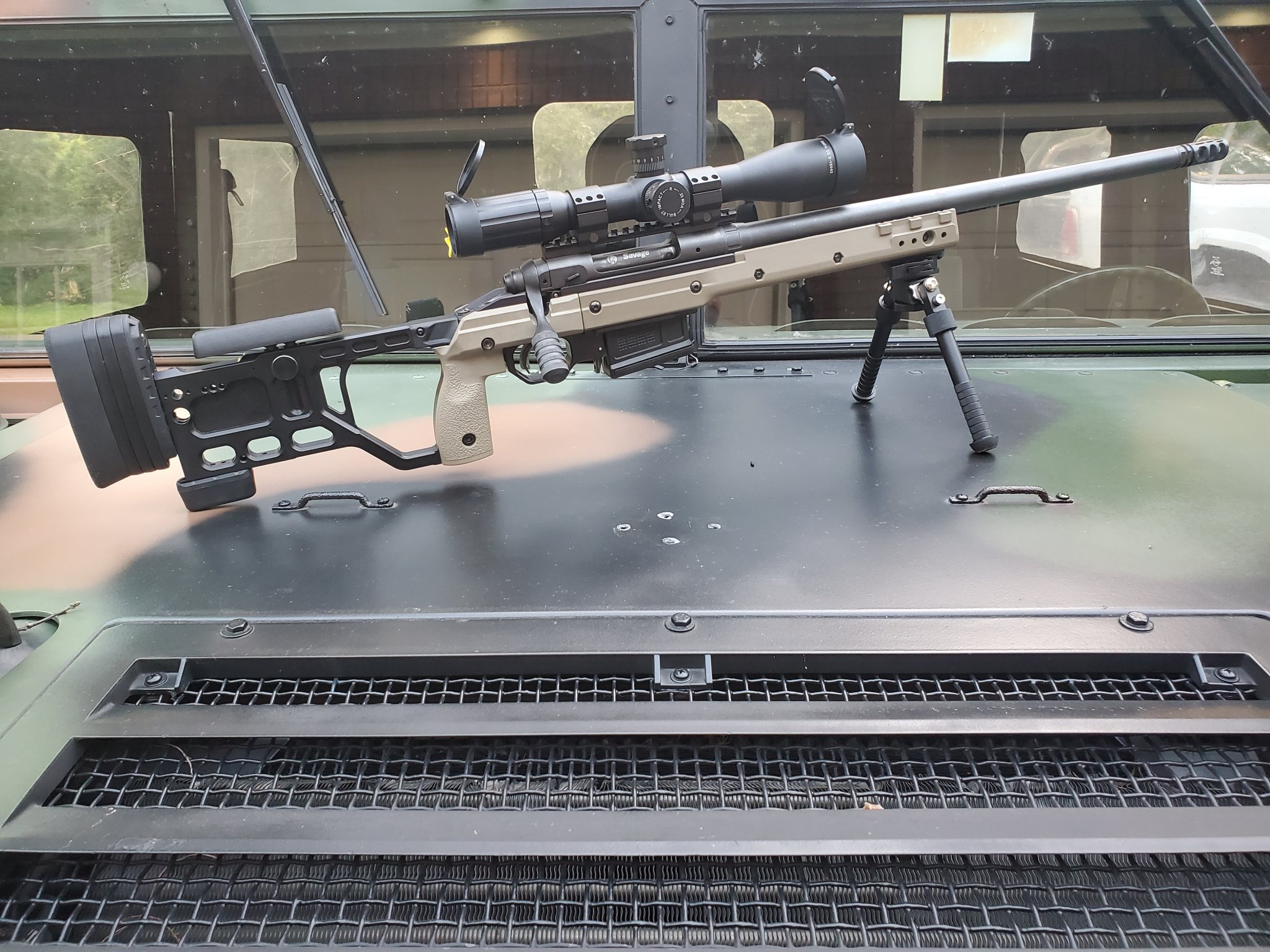

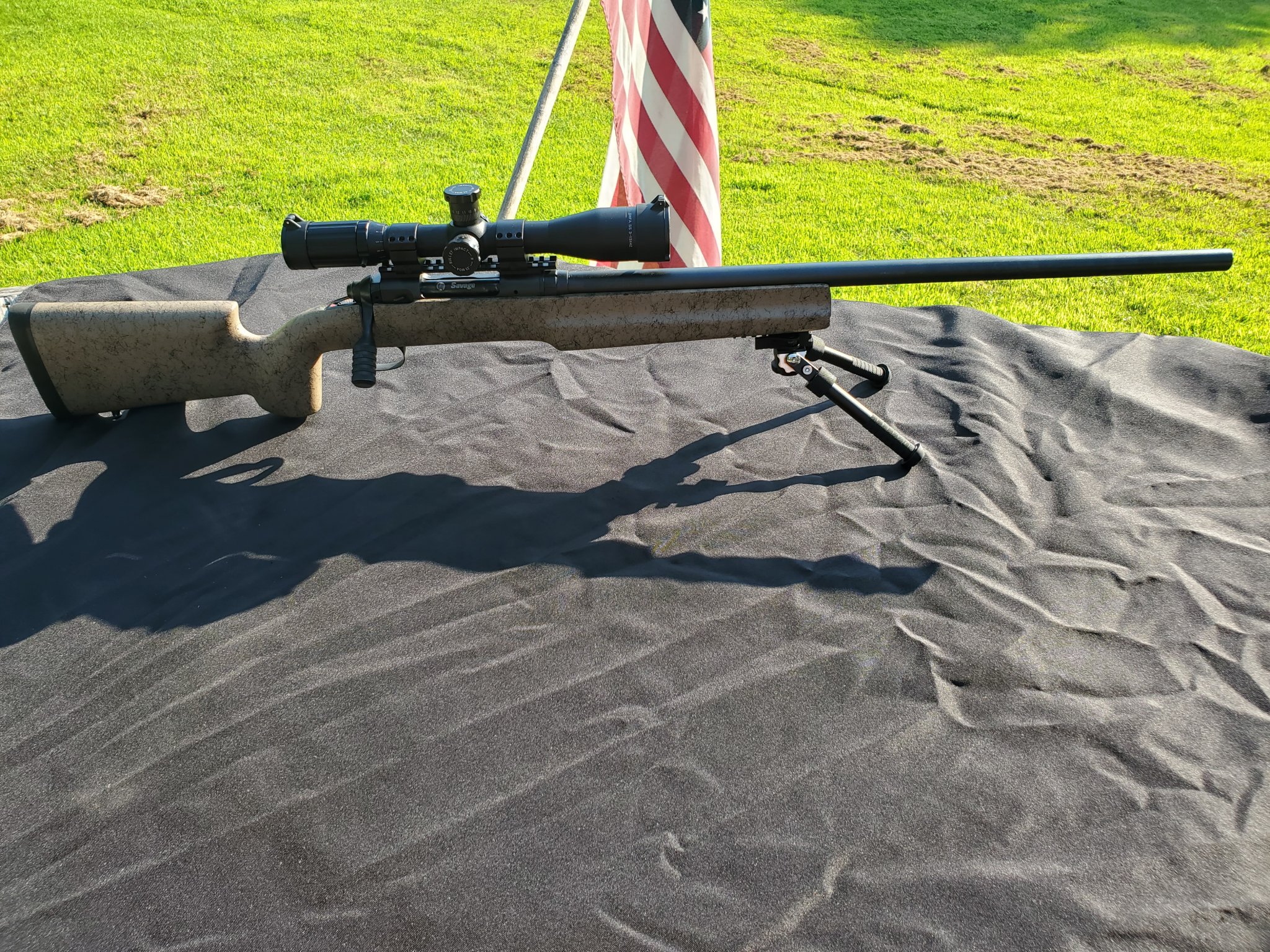

Last spam post in this thread I promise, got ahold of some screws that will work temp they are alittle short put 20rds through it and everything seems great I can't wait to dive into reloading! So happy with how the build turned out!
Some Before and after pics
this is what its all for man, i want to see the before and afters of everyones rigs,
when you make a post showing you shipped to the next person if you can also include an updated running list of whos in line it would be appreciated.
glad it was a quick weekend job
on a sided note, is that a H1 its sitting on... EPIC!! more pics of that lol
