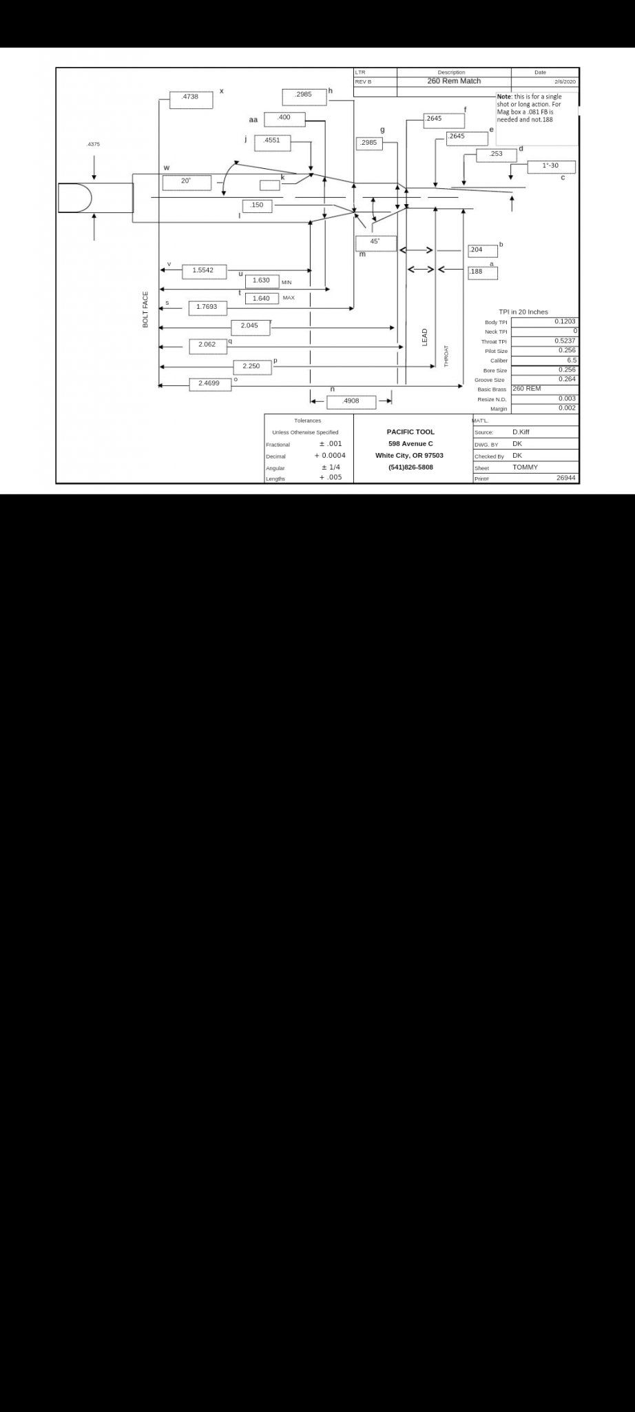

    Cool, post the print when you can.
    Yes, but to a very minor degree imo. How hard you push it is going to be the major factor.
    Here's a screen shot. Hopefully you can expand it to view. It says it should have a .081 freebore which I'm still trying to learn about:unsure:

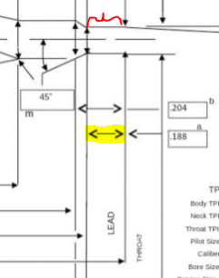

    According to that print, the FB is .188 and not .081.
    The note in the top is referencing the fact that if you used that reamer, you would need to use either a long action or single load, as the bullets would be too long to fit the standard magazine if loaded to be near the lands.

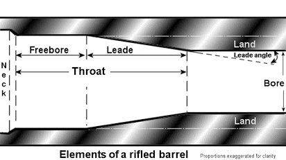

    The freebore is the area right in front of where the case neck ends but before the rifling begins to ramp up. PTG and others label their stuff backwards though so thats why its important that you know what it actually is that you are describing.
    This is how most people describe it
    SO on your print that would be the .188 dimension.
