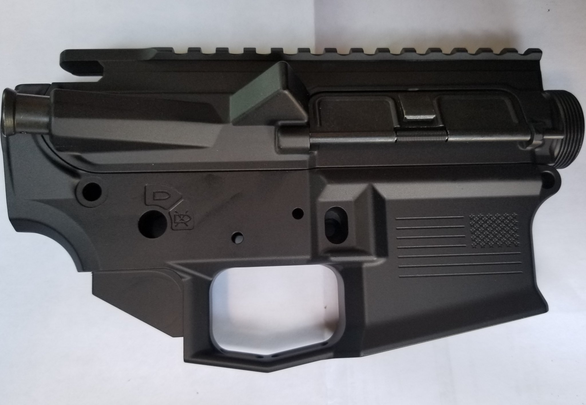

When politicians start saying I can't have something then that makes me want it even more. Since some are saying that I can't have an evil "assault rifle", well that just made me want one even more. So, with that being said and the Labor Day weekend sales what do you think I did? I practiced my God given right that is protected under the 2nd Amendment of the United States Constitution and purchased an evil black Aero Precision Freedom reciever set to start building an "evil assault rifle" GOD BLESS AMERICA
I will be ordering a custom barrel from Bartlein Barrels on Monday that will take about 4 months to get to a gunsmith to finish it off. Since I hate paying retail it probably won't be until Black Friday until I order more parts. I already have a few bits and pieces that will be coming in next week. Still have to decide on the bolt carrier group and hand guards anyway plus some of the control devices such as the safety and bolt catch. So many to choose from, decisions decisions ???
I'm always open to suggestions on parts to use. Since the barrel is going to be some time out it's going to take a while. But it will be interesting to see the results.
The parts I currently have are:
Aero Precision M4E1 Enhanced Receiver set Freedom Edition
Geissele SSA-E trigger

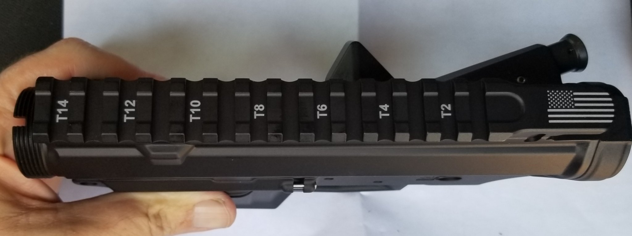

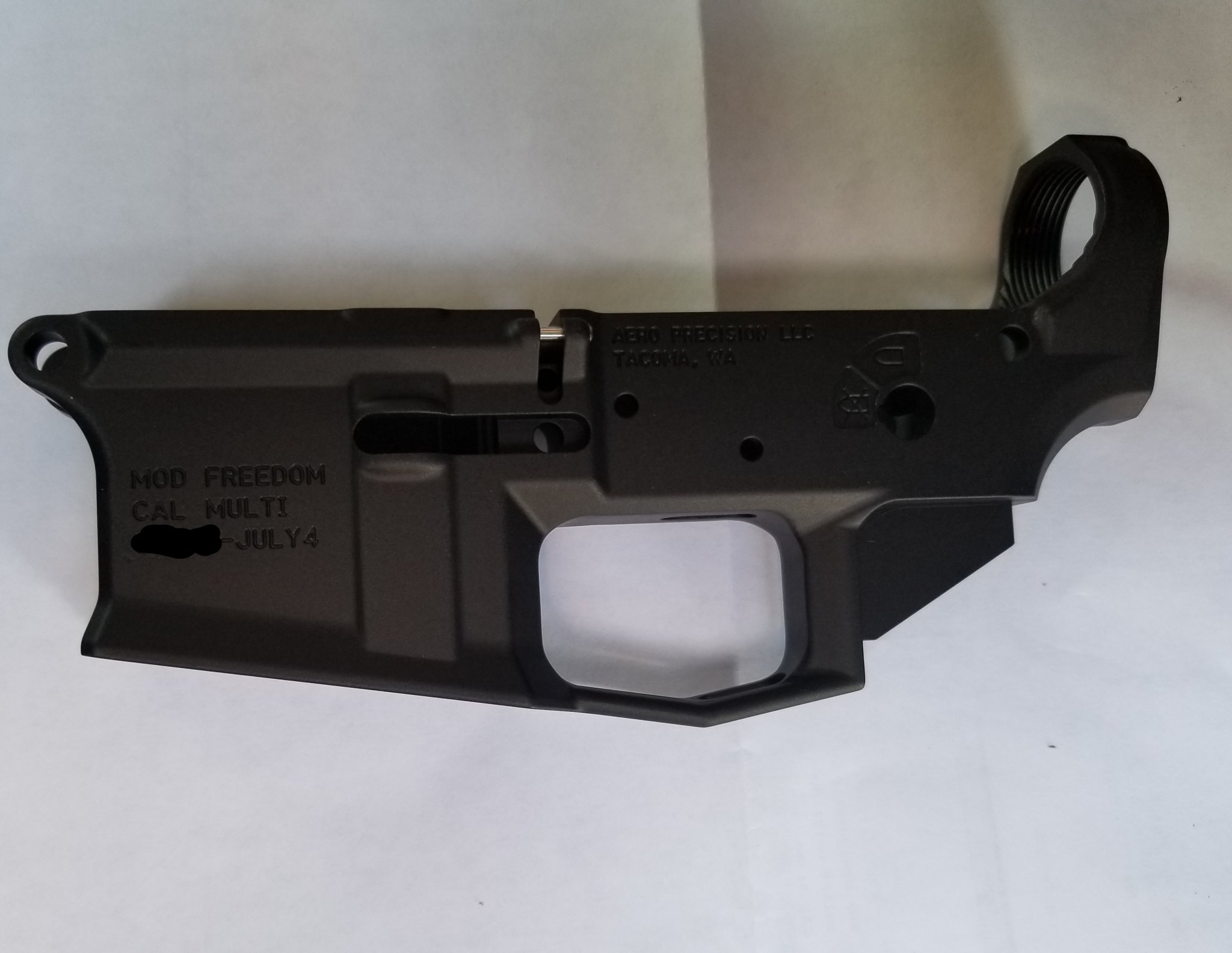

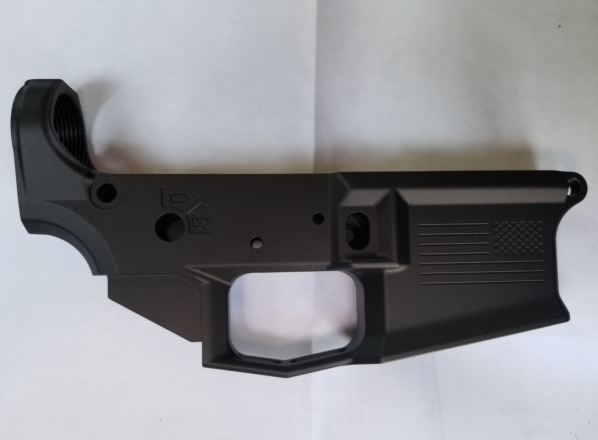

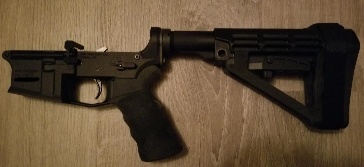

Just got the lower built. I have another lower that's been sitting around for a long time doing nothing so I decided I would do two builds. In fact the lower is so old that the company is no longer in business LOL. The 18" build I started planning and a pistol build. So I took the lower last night and started the 18" build. Since I don't have the barrel or the handguard yet I decided I would build that lower into a pistol lower to start out with and once I have the handguard and barrel I will switch out the pistol brace for a Magpul UBR Gen 2 and build the other lower into a pistol.
Parts list:
Aero Precision M4E1 Freedom Lower
Battle Arms Enhanced Pivot Pin Set
Geissele SSA-E Trigger
Geissele Maritime Bolt Catch
Radian Talon Ambi Safety
BCM Quick Detach End Plate
SB Tactical SBA4 Pistol Brace
Ergo Tactical Delux Grip
Mil-Spec Castle Nut
Mil-Spec Magazine Release
Some notes about the build"
Aero Lower: This is a M4E! Enhanced lower. The set screw for installing the bolt catch is a nice addition. Aeros website said it's a 1/16" set screw but the hex key needed is smaller than that. Not a bid deal but knowing the right size hex key from the start is always nice especially since a lot of people probably don't hae hex keys that small and would have to go buy one. It's also a little bit of a pain to screw in and out because it's so small and you have to remove the hex key every half turn so it takes a few minutes to screw it all the way in. Nothing Aero can do about that but it's still nicer than trying to pound in a roll pin so I won't hold that against Aero but it's just something to note. Tolerances seem excellent and no issues with anything fitting in loosely.
Battle Arms Enhanced Pivot Pin Set:
The pivot pin set came with a small magnet to help install the pivot pin. I found it too much of a pain. You place the magnet on the other side of the pin detent hole and place the pin detent in the hole and the magnet holds it there. You then place the spring into the lower and try to place the detent into the lower and then slide the pivot pin into the holes and it's supposed to go right on. The problem I had was when I tried to place the detent into the lower the pin would move and not go into the lower. I finally just took a punch slight smaller than the holes for the pivot pin and placed the pin and spring into their hole and then placed the punch into the pivot pin holes and then slid the punch out with the pivot pin and it went right into place like it should. Much easier than trying to use the magnet method. But over all it's a very nice pivot and takedown pin set and wouldn't hesitate to use it again in another build
Geissele Maritime Bolt Catch: It appears to be a pretty nice bolt catch. It's nice and large. The bottom howerever is slightly too large. It covers up part of the hammer pin hole and you can't install the hammer into the lower if you're using some kind of slave pin. So if you're installing a trigger you'll have to remove the bolt catch so I would recomend installing the bolt catch after the trigger. I will see how I like it once I get an upper built for it.
I think those are the only issues that weren't of my own making like trying to install the safety cylinder in backwords and wondering why it's not working. DOH LOL. But overall I'm very happy with pretty much all of the parts.
I'm thinking about changing the magazine release for something else just because the mil-spec part seems a little out of place on this build. If anyone has any suggestions on a good aftermarket release go ahead and make suggestions. No real reason to replace it since I can reach it without changing my grip other than it just looks out of place. LOL
