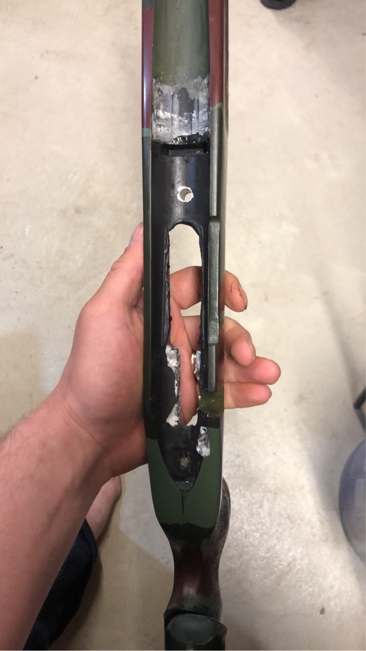

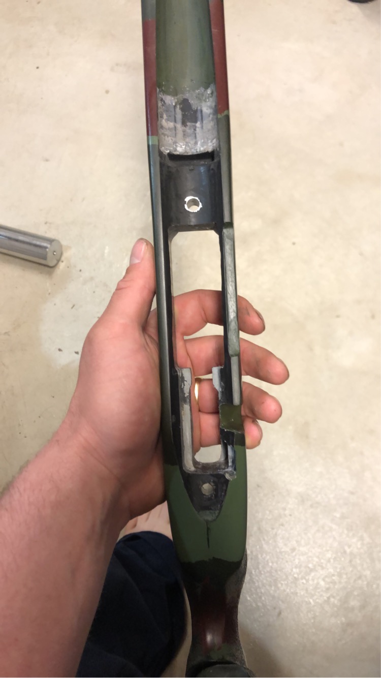

In theory, bedding your action into the stock, and having aluminum pillars will help with constant removal and retorquing of the action, and with repeatability. I have an origin action that I use as you describe, in a bedded stock with pillars, that I remove all the time, and iv had no issues to date. When I bedded mine I put 2 layers of painters tape thickness on the front of the recoil lug if I recall correctly. I’ll look for some pictures but it was my first bedding job and I learned from reading on here and other forums.
