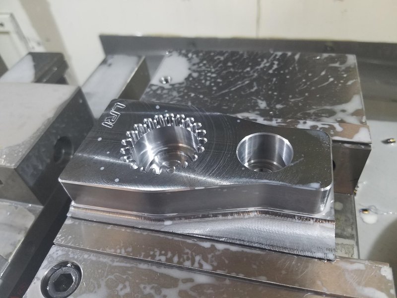

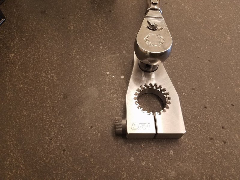

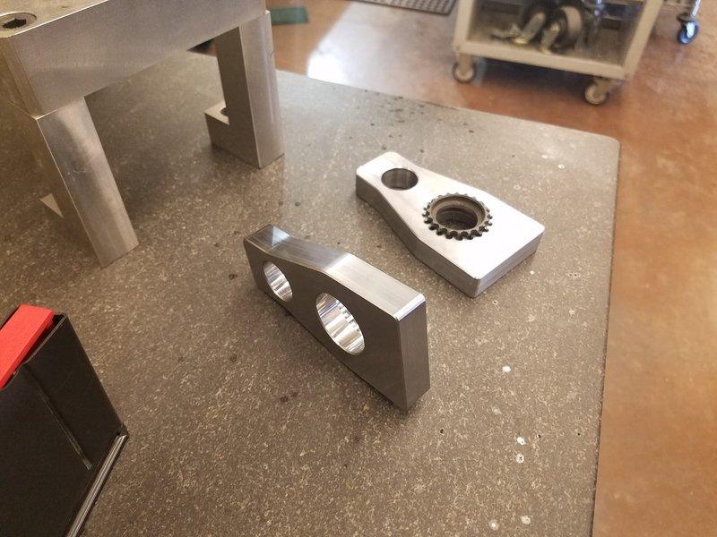

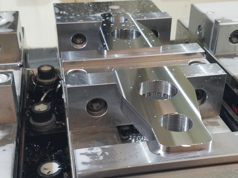

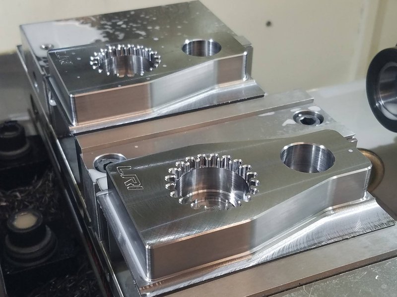

    RPR's can be a royal bitch to get a apart at times. The AR15 armorer's wrench is a joke imo.
    That box is now checked. I've been beta testing one of these in our shop over the last 6 or so months. Few little changes and this is what we now have. No more busted tools. No more blood drives being held at the barrel vice, lol.
    In production next week. If interested you can pre order. Price as yet to be determined but we'll be able to keep it right at about $95.00 +/- a few scheckles. I have to sort out material costs, cycle times, etc... I think we'll be able to keep it under $ ### though.
    100% bar stock machined. 1/2" drive socket. We press/weld it on the back side.
    Thanks for lookin.
