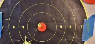

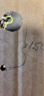

My Browning X-Bolt Max Varmint/Target is zeroed at 100yds. To hit zero at 25yds I want to holdover because I want to retain the 100yd zero for shooting 625yds at Pala shooting range. Upon firing the rifle at 25yds indoors the point of impact is 1.50 inches low as measured by calipers. So knowing that 1MIL is 3.6 inches at 100yds that means at 25yds 1MIL would be 1/4 of 3.6 inches or .9 inches. To move the point of impact 1.50 inches up, doing the math says I would need to holdover about 1.7 MILS which would mathematically be 1.53 inches which is as close as I can get to 1.50 inches. However, It takes a holdover of exactly 2.0MILS to hit dead center at 25yds. We all know that 2.0 MILS at 25yds is exactly 1.8 inches which is 0.3 inches more than 1.50 inches. What is going on here?????
Here is the 100yd target with red bullseye and the 25yd target showing point of impact of crosshairs and 2.0MILS holdover.
My question to the cognoscenti is WTF????
Ballistic arcs are not linear. Period.
Go spend a minute to lookup a graph of a ballistic curve. Then you will understand better than we can tell you. Specifically a ballistic representation of the curve with 100yd zero.
