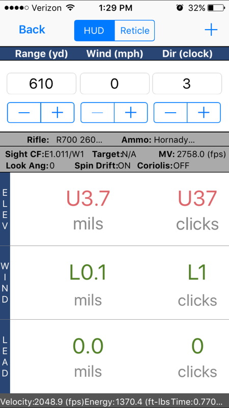

4 separate ballistics programs agree the solution is 3.6mils at 610 yards but I had to dial 4.1 to hit the target; I needed 2.5mils at 423 yards when the computer says 2.0.
What am I doing wrong?
Give us all the inputs you are putting in. MV, Density altitude or pressure and temp, sight height, BC, G1 or G7, all of it.

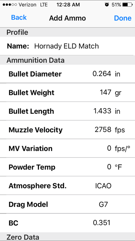

I just used the listed bc in ballistic ae, and somewhat generic on the other inputs besides your MV and came out with way different.
0.351 G7 BC
2758 fps
1.91" scope height
100yd zero

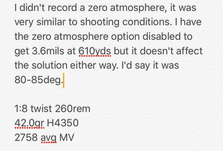

I didn't populate any of the atmospheric data, the zero and shooting day conditions were very similar tho and any small errors due to pressure or temp wouldn't add up to 0.5mils. I believe it was 85 deg and 30.08 inHG

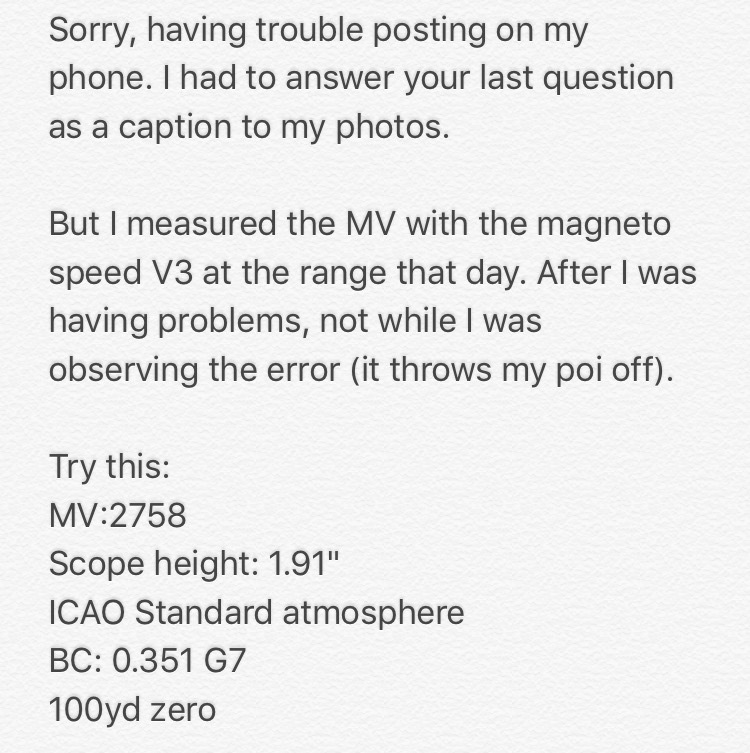

I've used Ballistic, JBMBallistics, Bullet Flight, Applied ballistics, and Sterlok.. all at 3.6-3.7mils....Its acting like an input error but I have no idea what it could be.
0.351 G7 BC
2758 fps
1.91" scope height
100yd zero

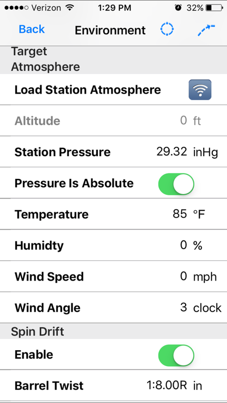

30.08 inHg? You are using corrected pressure not absolute pressure.
Where re are you getting your environmental data from?
what is the elevation where you are shooting? What calculator are you using?

change the atmospherics. make sure in the settings you have pressure is absolute on. use 29.32 and 85 degrees and see what the solution says. also, when you got that MV, was it that day or another day at a different temp? AB requires 1 of 2 things, either a calculated change in fps per degree or you can plot a table with different velocities at different temps and it does it for you,

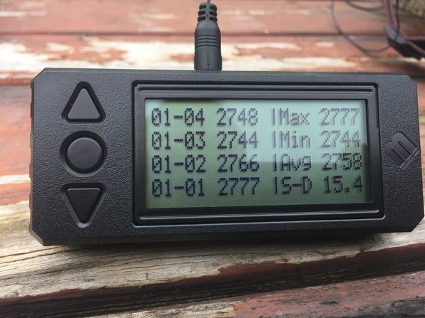

My guess is 1 of 2 things. Either your MV is wrong and/or the pressure was making it think it was at a different DA than what you really were.
[No message]

What about my question regarding the MV? Was it measured that day or a different day at a different temp?

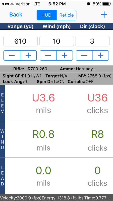

i use AB as well, going to try and recreate everything you did in mine and see what it says so if I could have your zero info when u get a chance. I have very good success with AB so I'm curious.
Well I got the exact same thing as you when I made my zero atmosphere the same as what you said you were shooting in. I think you need to start from scratch.
rezero and record your actual zero atmospherics and save them in the ammo profile. get a muzzle velocity for this zero temp (don't zero with MS attached, but get the velocity either before or after you zero).
take that MV and your 2758fps at 85 and figure out the difference in fps/degree and be sure that field is plotted in the ammo profile. then when you go out and shoot make sure you use all the correct inputs and see what happens again. im sure its a MV error and since you don't have your exact zero range and atmospherics and MV, the algorithm is no good.
AB doesn't require you to change the BC, the BC isn't your problem. the problem is your MV and the MV Variation.

Any chance you transposed numbers in your velocity data from the magnetospeed? If I input 2578fps instead of 2758fps I'm curiously close to your 2.5mils and 4.1mils solutions for your given distances.
I just don't see how any 6.5 projectile going 2750fps would need 4.1 mils to 600 yards. I don't think this is a ballistic calculator issue.

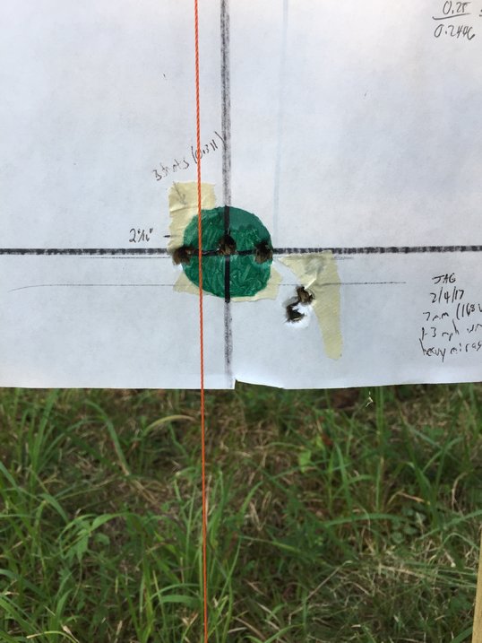

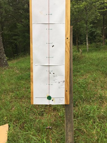

I shot a scope tracking drill today, see picture below (ignore crap group on 2 mil line). Seems to be tracking correctly but in doing so I noticed something odd. The poi shifted 0.2 down and 0.2 right.
I zeroed the last time I shot and now I'm off the amount I had to shift my zero last time. My loads were made up from a mix of new unfired brass and 2x fired brass. Is it possible that these different loads are causing a diff poi shift?

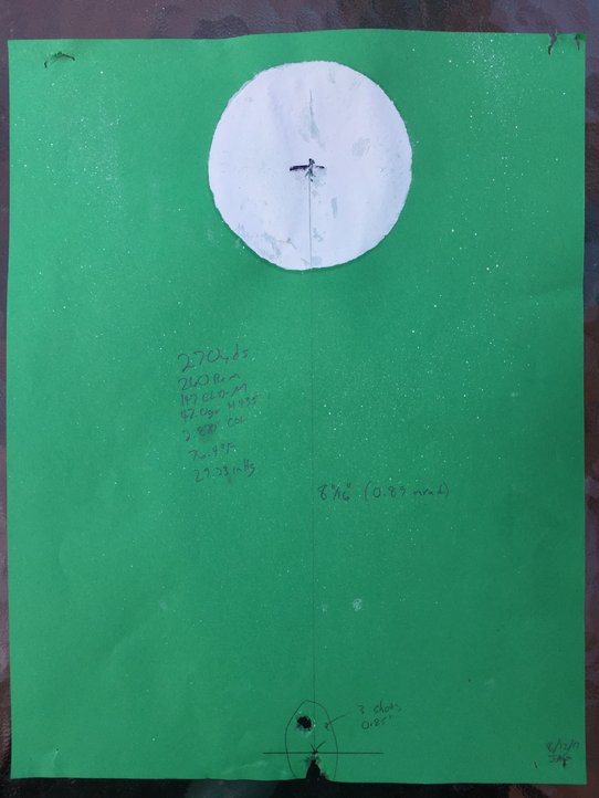

No, I'm going to prep all my brass the same and then rezero and record all my info. Running low on H4350 and I have to save enough for an upcoming match so I'm being very stingy with my shots.
Zeroed today and shot a group at 270yds (longest I have) without dialing any correction on my scope. See the pics for the results. With a confirmed zero the solution was 0.9mils and I measured a drop of 0.89mils so it appears my problem is solved, at least to 270yds.
We'll see what happens in my match but I guess the new unsized brass was causing a poi shift?
So if you update AB with your zero atmosphere and then go to the solution and put in the atmospherics of where you were shooting with the original problem, what does it look like?
