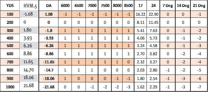

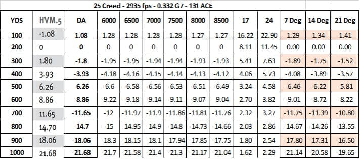

here is the nominal HVM.5 dope from the scope I used and the dope for my 25 Creedmoor slowed way down for better recoil control (I never referenced this image one time but had it on hand).
Here is the DA vs YDS matrix that directs simply and extremely fast DA corrections per range band. as you can see a 1000 yd shot at 8500 DA and with a 21 degree incline would adjust -10 clicks. Even though we were shooting up and down mountains the max correction I needed across two days and 20 stages was 1 click.

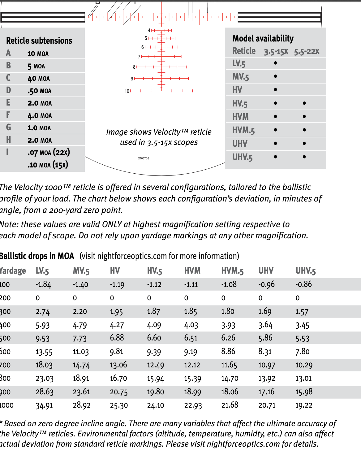

Here are the nominal elevation measurements for the 8 types of NF Velocity 1000 reticles.
