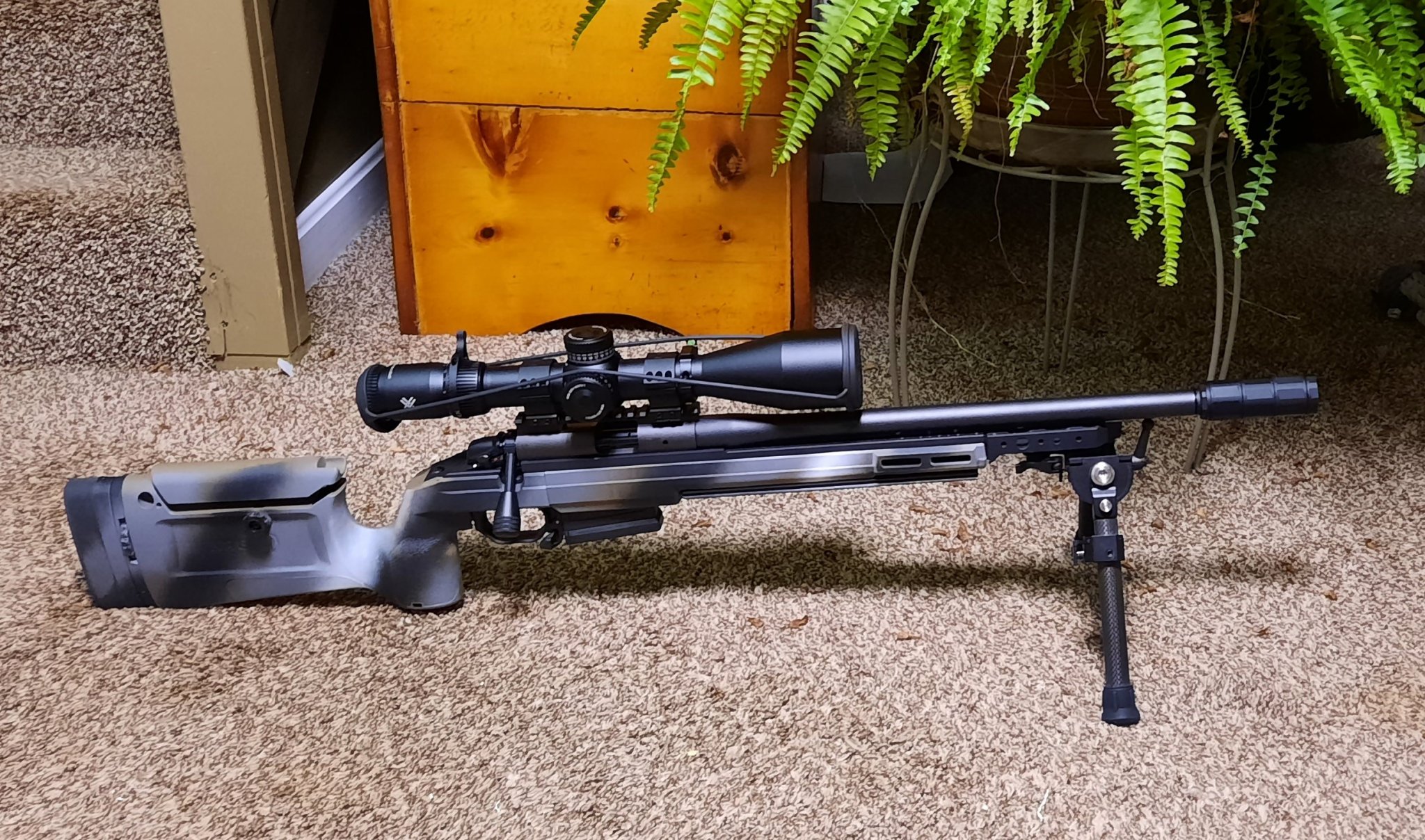

Sounds like you've done your homework . You'll need to address the trigger though. Diamond Tech seems to be the trigger of popular choice but a Timney HIT will get you a crisp 8 oz for less $. ( You can also just modify the factory trigger for $6 to get around 1#) If you need to make up that trigger cost, consider the Vortex Venom vs SE. Same glass and retical for about $300 less. Another way to squeeze a few more $ out of your budget is to shop in the classifieds here. You won't have to wait long on a KRG Bravo at a discounted price. FWIW, here is my B14R in a Bravo with Venom. Shoots better than I can.
The Venom is NOT the same glass as the Strike Eagle. And they are not the same scope, minus a few options. I used to think that, but after closer examination, they are not the same. The Strike Eagle is actually a much better scope over the Venom...And worth the $300 difference.
