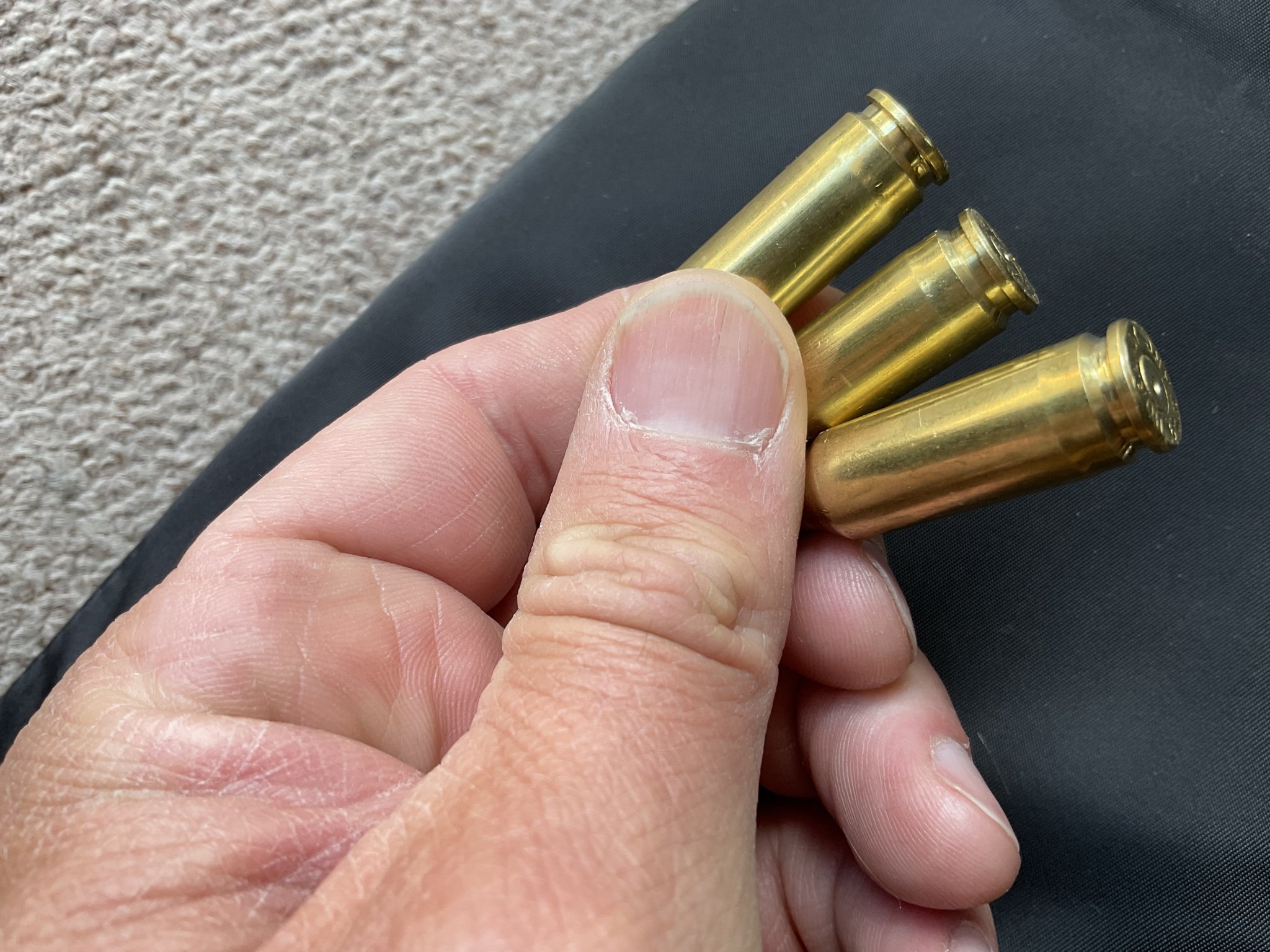

Full circumference case bulge, 6ARC
OREGUN
  • Apr 29, 2014
    2,257
    3,788
    Out West
    Any gas-masters care to weigh in on what’s causing this bulge AHEAD of the case head? Hornady factory (black and match). Happens in about 20% of cases. Suppressed and unsuppressed. 22”, +2 gas.
    Gun runs fine, shoots great. Still waiting to hear from manufacturer.

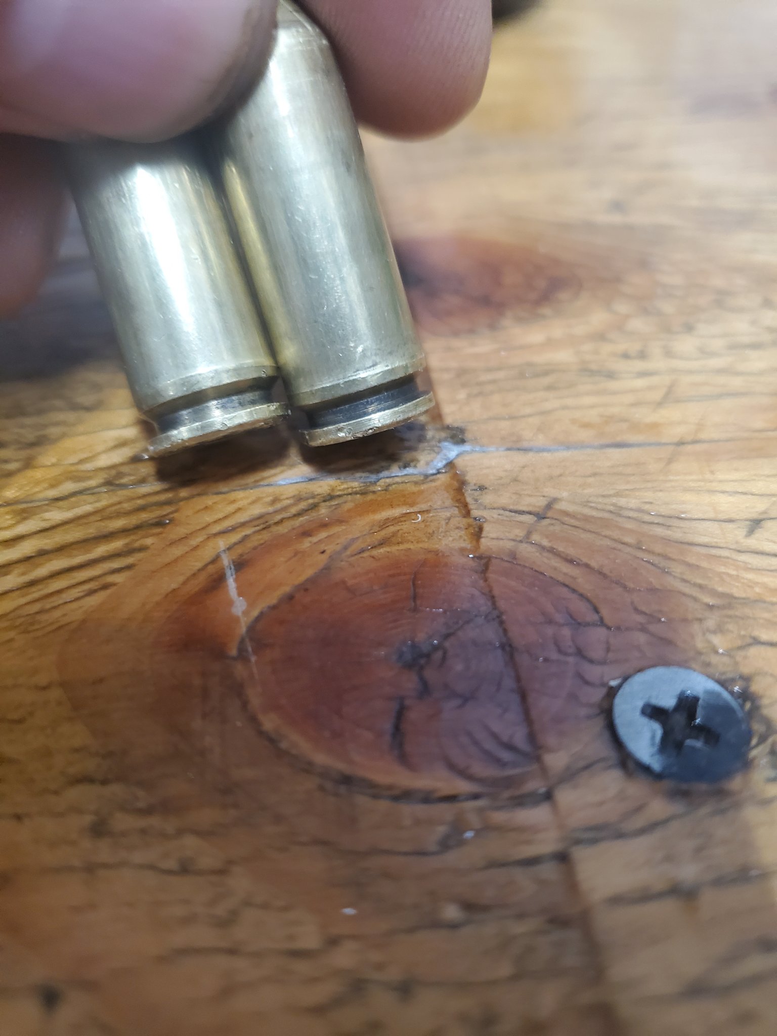

    My unfired starline is .438 at the .2 line, and fired is .442-.443 at the .2 line. Sized is .440-.441 at the .2 line. As measured with shitty calipers. It's either 9x or 10x fired. 4x in Rainer um and 5-6x in CMMG.
    This is two peices fired from the rainer UM I had to cull because they wouldn't size enough at the base to fit in my CMMG barrel. They measured .445-.446 at the .2 line.
