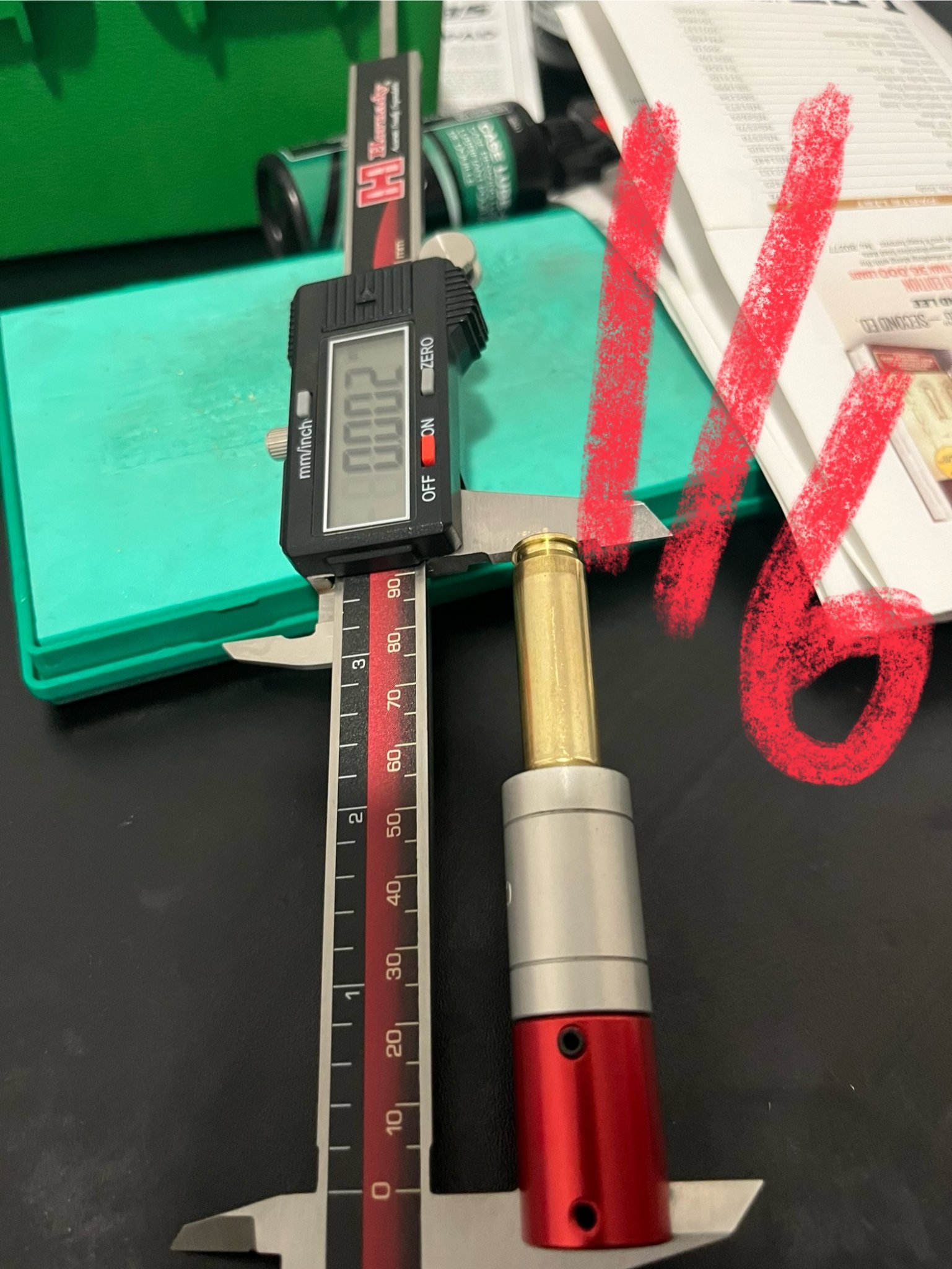

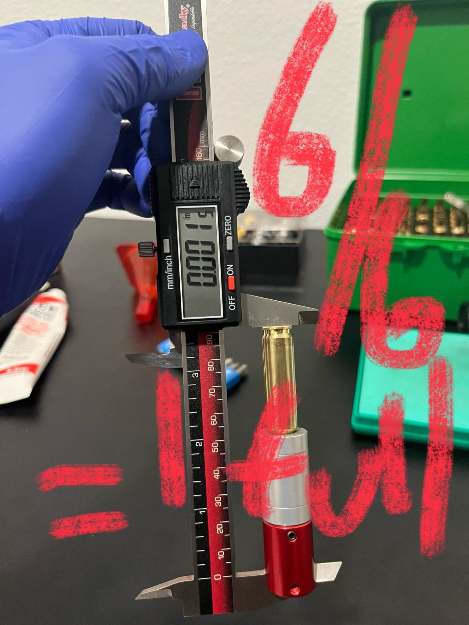

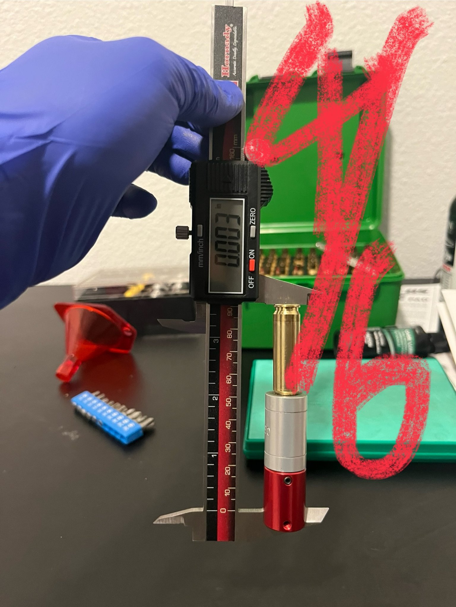

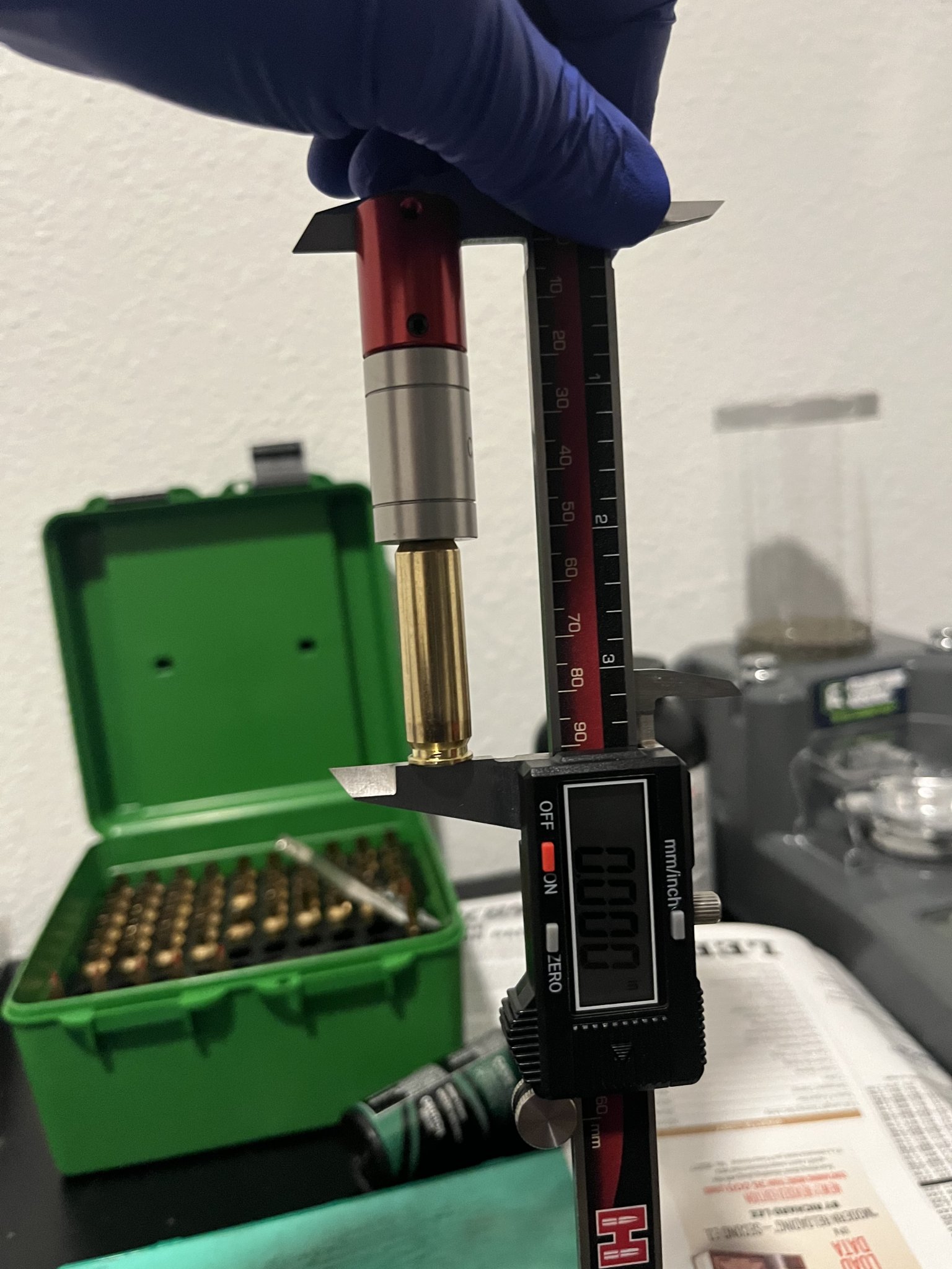

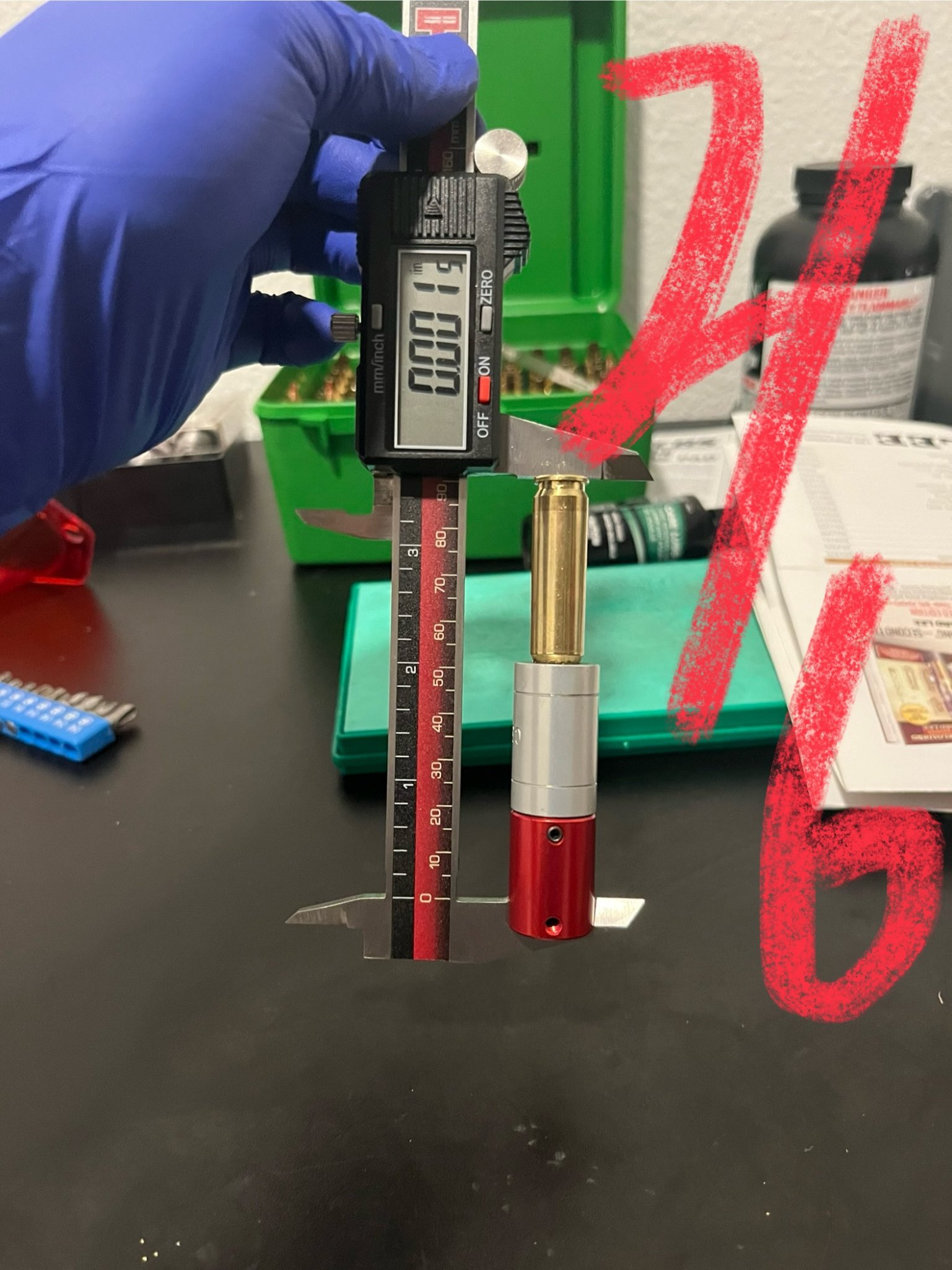

I am a really newbie of reloading
I have a Lee challenger Single press
And Lee rifle die set for 6.5CM
Id like to do full length sizing
But I have a big issue.

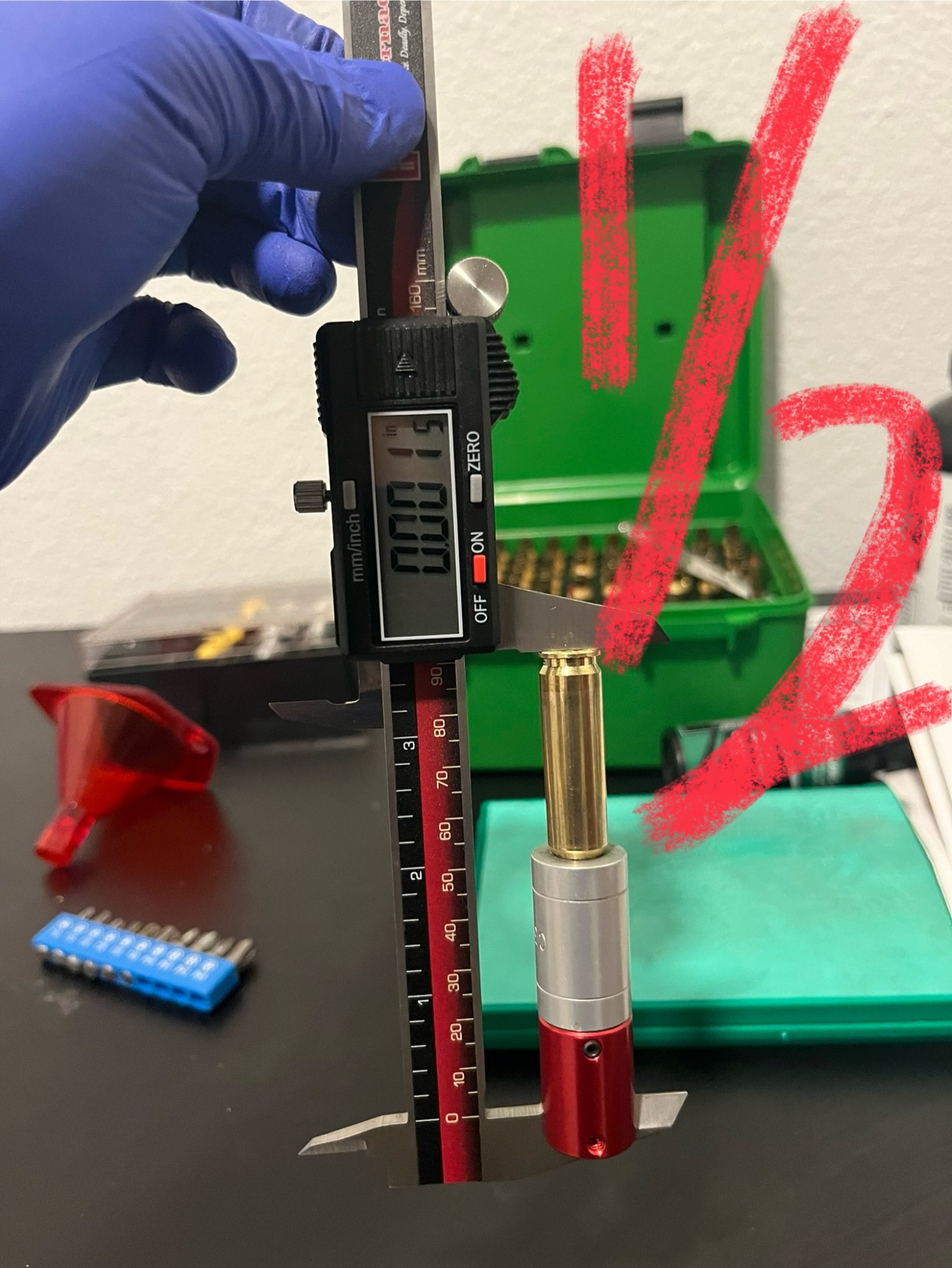

First, by using digital caliper with Hornady Headspace kit, check the number for brass that once fired ( it was Hornady 140gr 6.5CM ELDM )
And make it zero. 0.0000
Lubricant applied on brass
And as instruction that i learned or from manual, fully stroked up the Ram to touch the bottom of Full length sizing die( this is the standard point as I call). Then, check the gap between Ram and FL sizing die, no gap between.
Little bit lower down the Ram, Turn the FL sizing die 1/3 turn to down and Lock the die with Lock ring. Gently but firmly, sizing the case,
And check the length?
0.0035-> it stretched.
Gave another 1/3 turn
0.0035 same
Gave 1 full turn from the standard point
0.0035 same
2 turn
Same 0.0035
4 turn 0.0035
How should i do? Lock ring does not go up more than 4 turn.

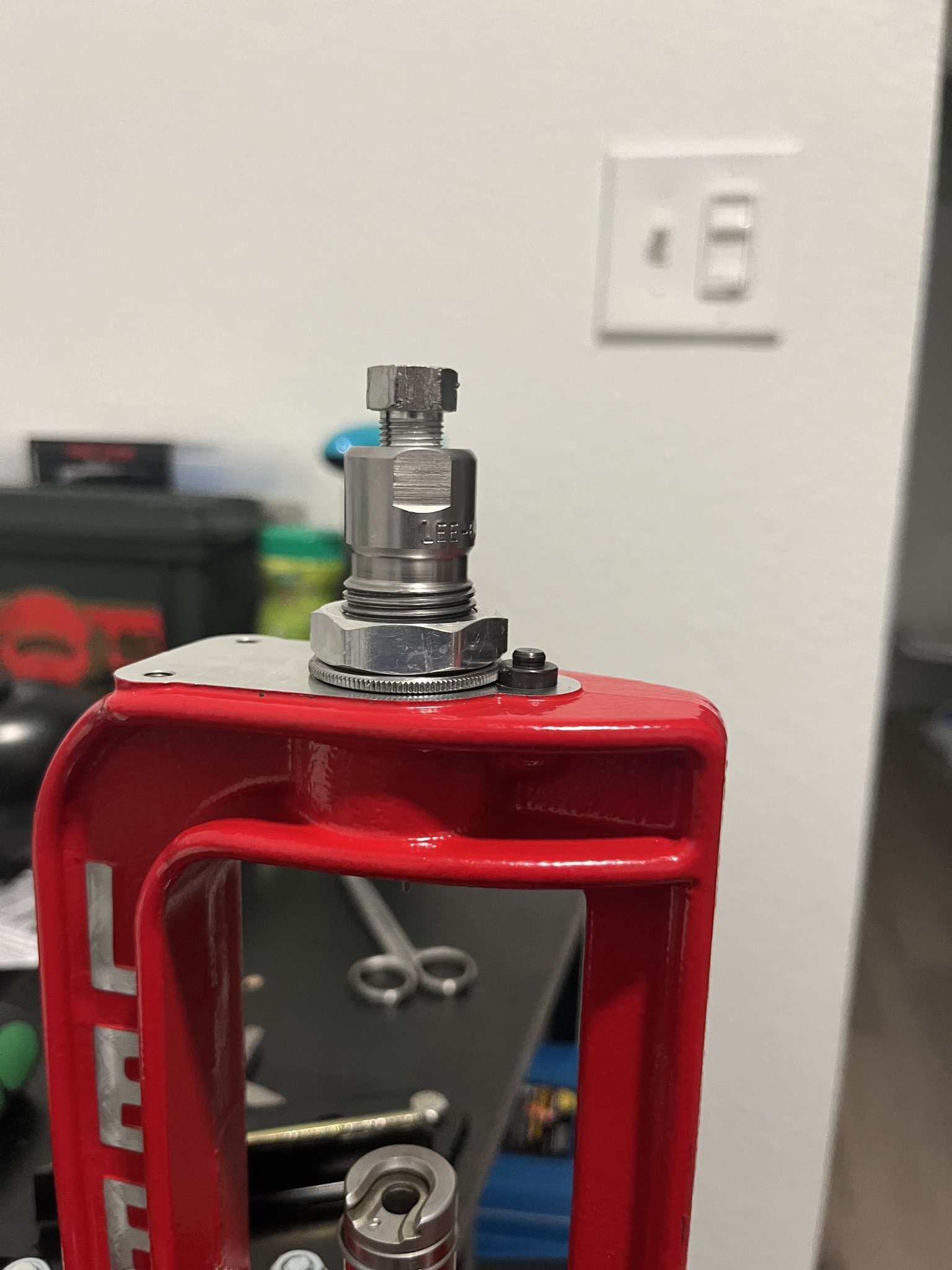

You mean the CBTO is not changing as you screw in the die? Post some pictures of die in the press. And the die and lock ring.

Once the die is seated on the shell holder firmly you’re not going to get any more sizing by screwing it in further. You may have to experiment with shell holders or take a few thousandths off the mouth of the die. They make shell holder kits for this. The die will have to be done on a lathe I would think.
