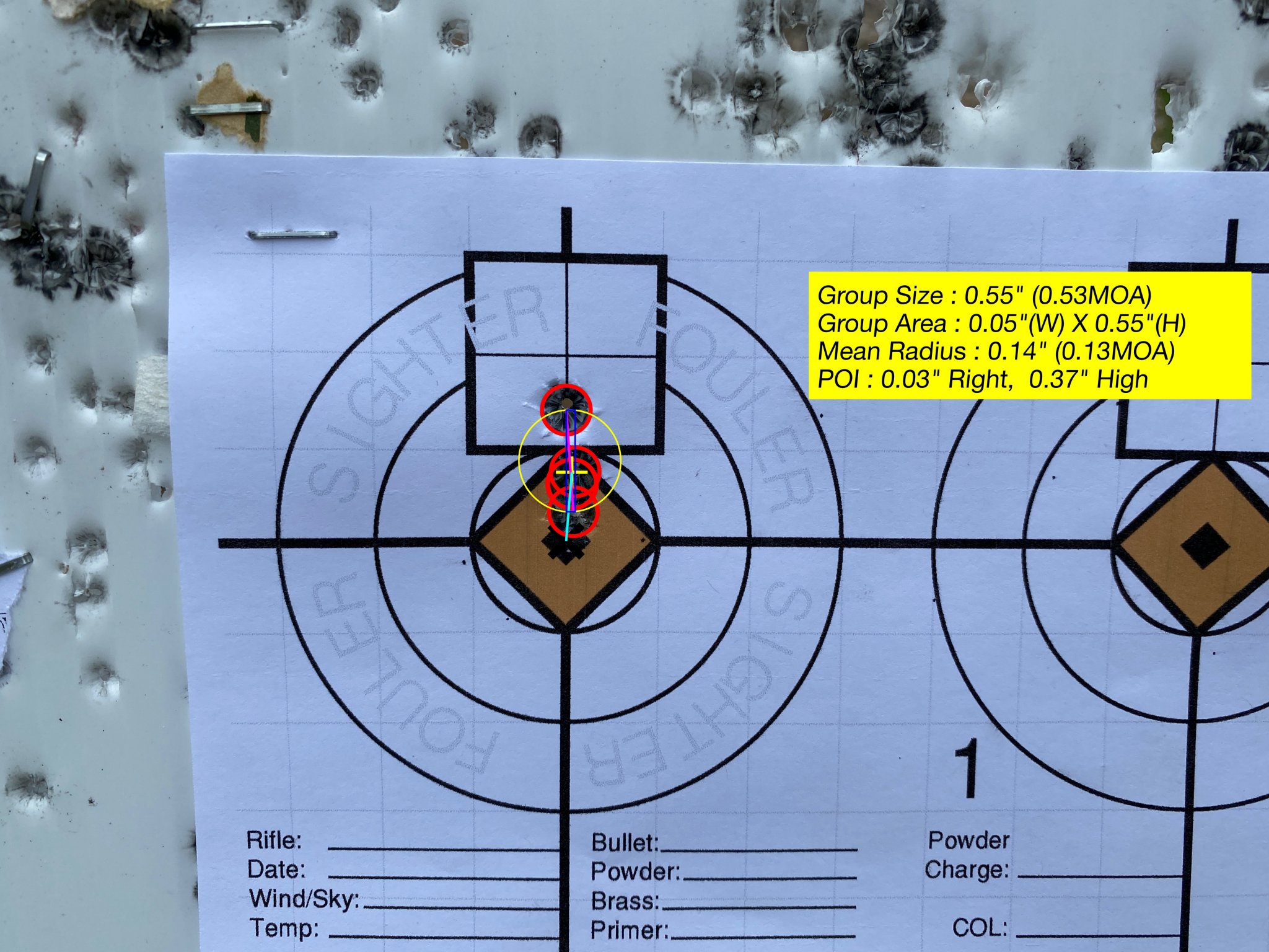

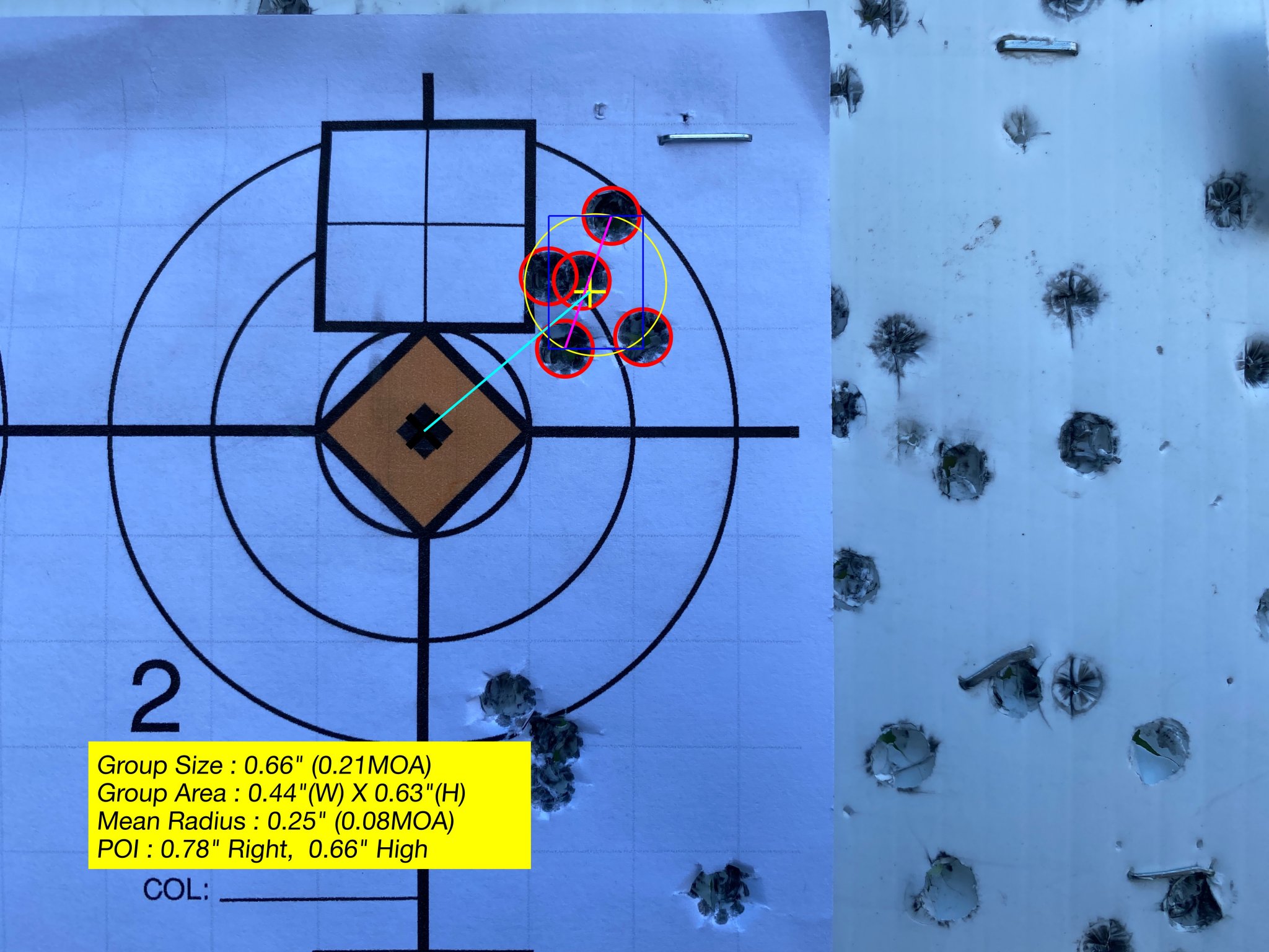

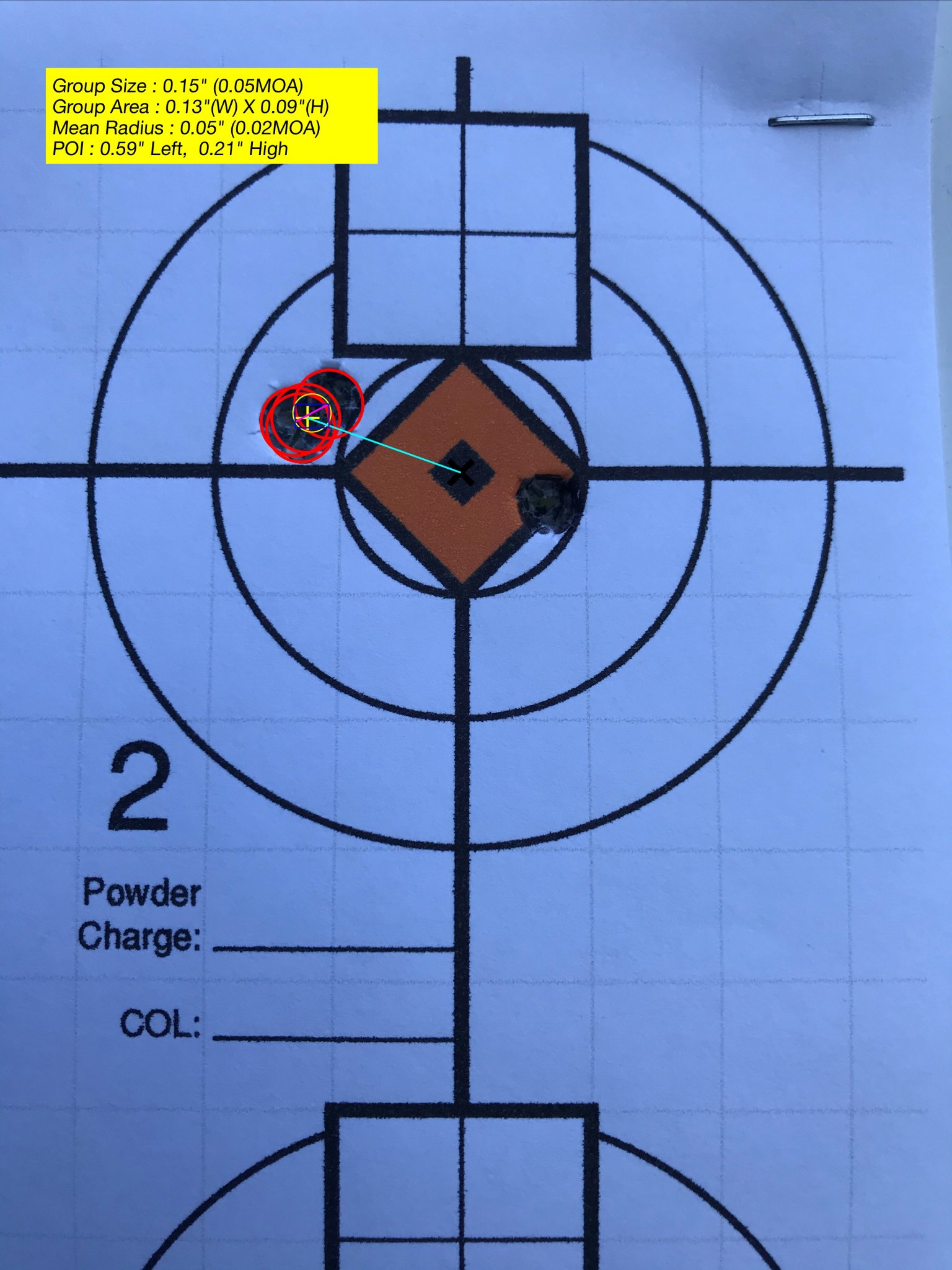

Let me preface my post with the fact that I’m very new to precision rifle shooting and reloading, but I’m also extremely mechanically minded, have strong math skills, and am an aerospace machinist and applications engineer. I have the ability to separate dogma from fact, generally the first time hearing it. If it sounds like it should work mathematically, I’ll try it, and it usually does.
I full length size in a two step process with Redding Comp dies every single time but the first firing of virgin brass. Before I bump the shoulder, I want to be sure that my brass has filled the chamber. It usually has on the first firing though. That’s just a redundant step for me at this point. I have not trimmed the last two batches of brass that I’ve run with this process in 10+ firings each, and not a single case has grown even a thou.
I’m in the process of switching over to Mighty Armory’s sizing and decaping die. I’m told it will yield identical runout results. I won’t know until I verify, and I’m not sure if my brass will begin to grow with this method either, but to eliminate 300 pulls of my single stage press for every 100 cartridges I produce, I’m willing to give it a shot.
I’m extremely consistent in my reloading process and the current 5 die setup including a mandrel die has proven very positive results for me, who’s still learning to shoot in general.
100 yard zero.
300 yards.
300 yards.
The load is so repeatable, that even my wife can do this her second time shooting the gun.
I listen, and try, and what works, I adopt into my process. Then I can transfer what works for me to her, and so far it’s working for her as well. Except now I need to build her a gun and teach her how to make her own ammo. Fml
