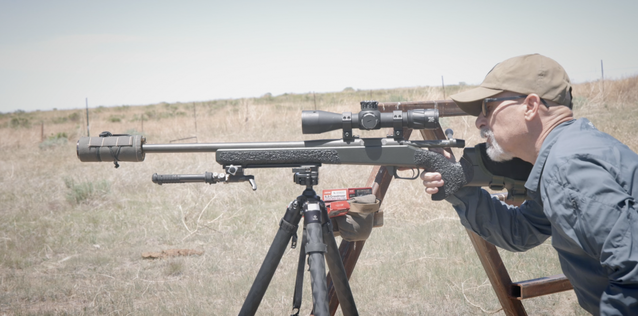

    I just ordered a second Biscuit, I absolutely love everything about that can... the look,
    The recoil pulse is nice... it's a bit noisier on my Tac Ops with the shorter barrel (sub 20") but I was psyched to switch the Hub over to Mike's thread, so if you watch the videos I just did, the Biscuit is on the Tac Ops

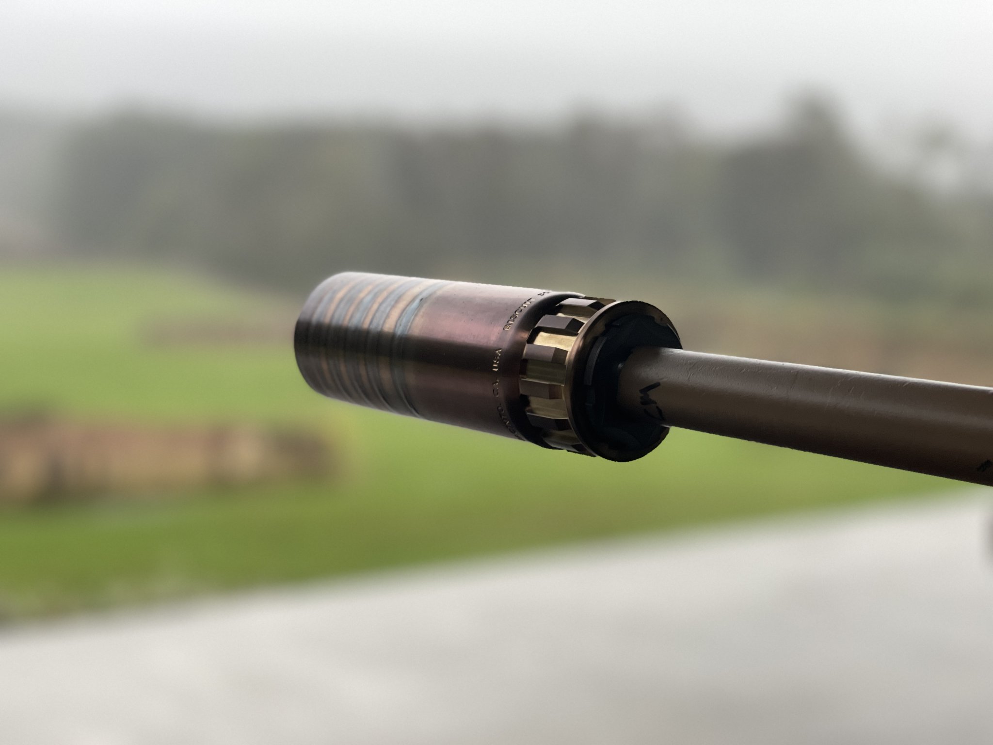

    Most of my cans use the Area 419 mounting solution so they can't work themselves lose. I run the KGM R30 suppressor
    I use the Hellfire brake now. I am going to be mounting a KGM R6. I was just planning to remove the brake and direct thread screw it on.
    I don't see KGM listed in Area 419's suppressor mount solutions.
    Maybe I am looking a the wrong stuff. Do you maybe have a link to the one you are using?
