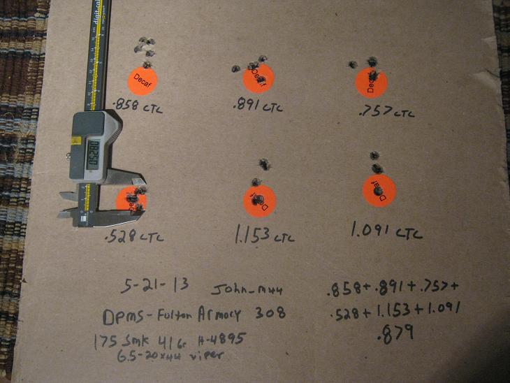

The 22" one that I have loves 175 SMKs on top of H4895
Here is my entry into elfsters 30 round shootout

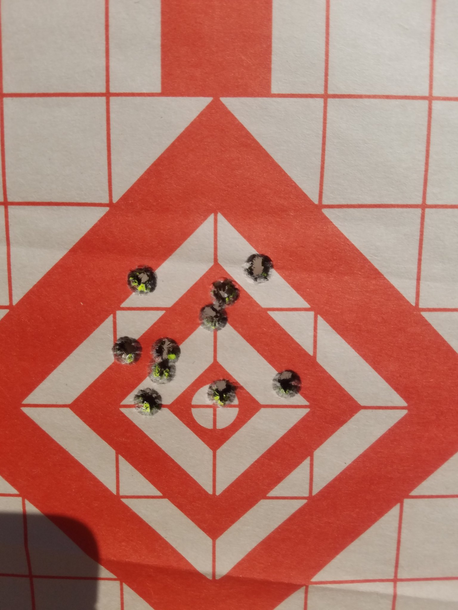

I've done a few load work ups with varying results. Best performance has been with 175gr SMK and 40.5 grains H4895 and 43 grains Reloader 15. I haven't tried the 155 Scenars yet, but have heard great things.

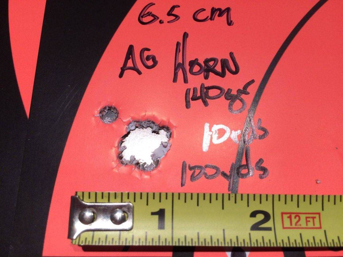

22" 6.5CM hybrid self assm. PSA , 10rd Horn. AG 140gr, 100yds.. benched scoped , bagged front and rear... ( see the weak link is me.. Lol, the flier )
18" .308 Criterion Mid gas, also self assm. PSA PA10 upper, OEM lower.
And because we all like to shot surplus... 20rds Sanitized DAG 7.62x51 surplus... ( or the ball ammo that shot the best group

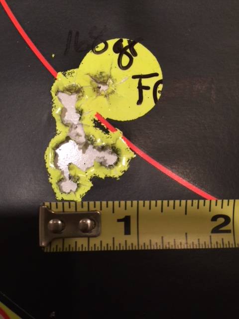

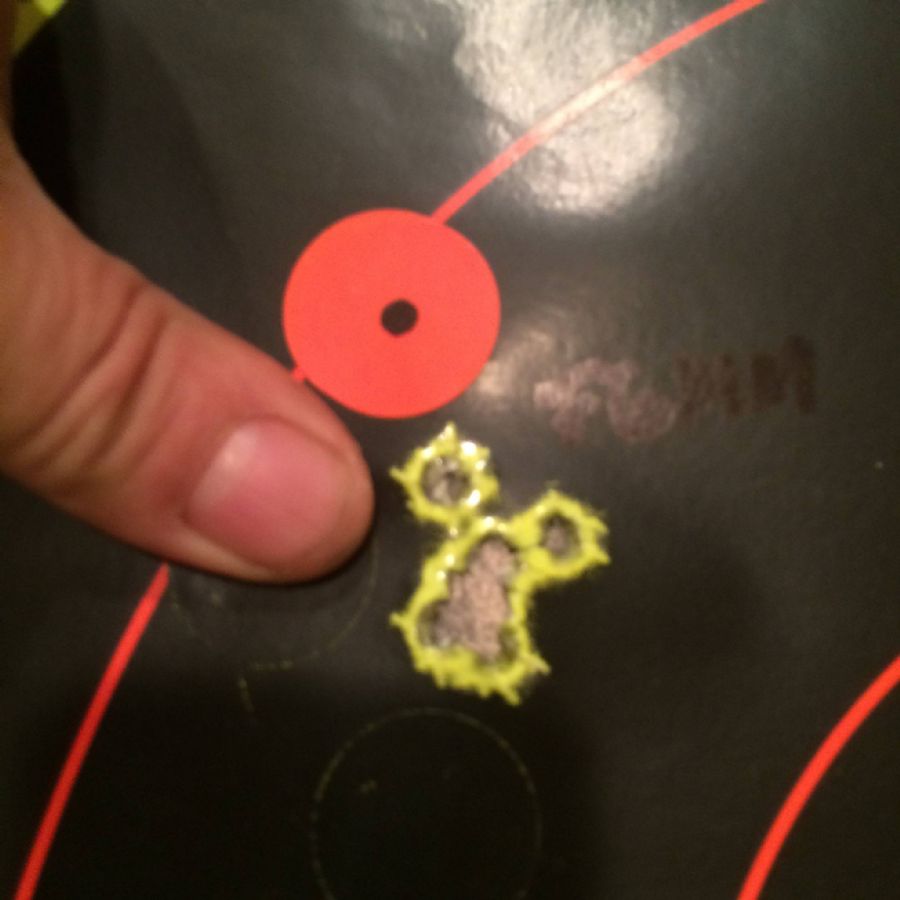

I have the 16" rifle gas hybrid barrel and it has worked with everyting I've put through it. My rifle is set up with a KAC receiver extension, a LMT MWS spring, and an H3 buffer. I also have an SLR adjustable gas block for fine tuning. Here are a couple 10 shot groups at 100 yards using Federal M1A 168 grain OTM. These were sll fired through a Surefire 300SPS suppressor.
