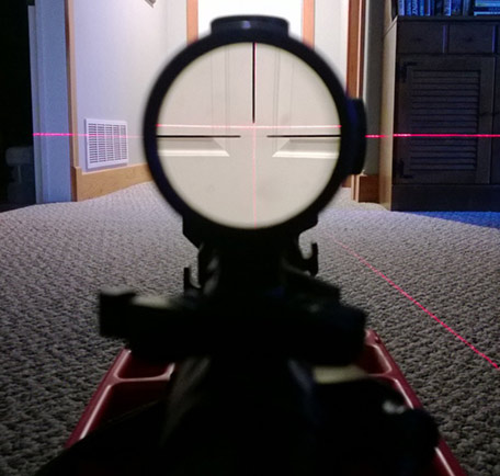

Create a channel Learn moreStupid question but don't you have to verify rifle is level first? I personally like using the feeler gauge method if on a picatinny rail.
I've used that before as wel as a survey plumb rod at about 200-300 yards. I put it farther out as its thicker and I can be finer. Or you can use your neighbors house if your in town.
I have never used a laser level. Some of the job sights I worked on dry- waller's used them to put the walls up an inch out of plumb in 12ft. Elev. crews put rails up 1/2 inch out of plumb. ( a 1/64 is the standard) So, how accurate are they, or is it the user that makes the errors? Not dis'n on, you truly curious.
Not neccessarilly. The rifle will automatically cant in the natural shooting position. You just need to make sure the reticle is level. Your better off setting the rifle in a natural position on a swivel bipod than level the reticle.
What's the feeler gauge method and how is it done?
oh I seeStack some feeler gauges between your 1 piece base and the flat spot on the bottom of your scope
