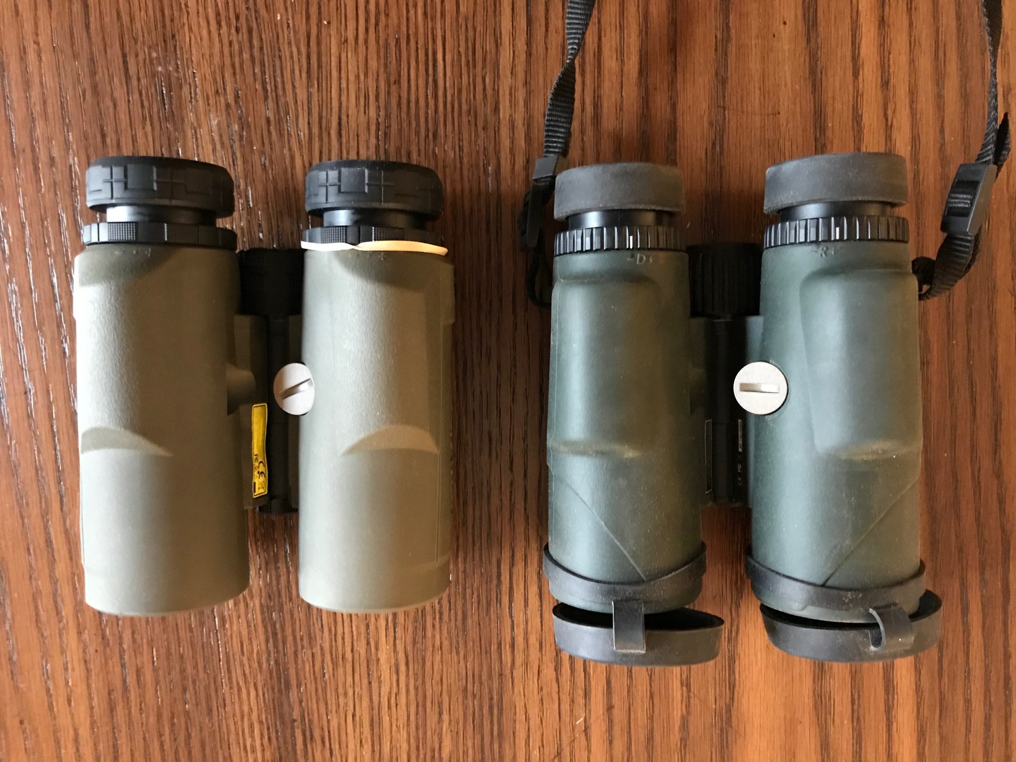

    I was in the market for a good rangefinder and narrowed it down to 3. The Terrapin-X, the Vortex Fury 5000 and the Sig BDX 3000. Really wanted binoculars as opposed to a monocular but accurate and fast lasing was my first priority and I was skeptical that the binos would lase as well as the Terrapin.
    I couldn’t find a head to head comparison so I ended up buying all 3 and ran them side by side figuring I would keep one or 2 and sell the others. My previous LRF Binos were the Leica Geovids HDR 2200. The glass was phenomenal but the laser was slow and often had difficulty ranging even moderate distances if the light was not perfect.
    I put all three side-by-side and lased a variety of targets out to 4500 yards. I was impressed with all 3 units right off the bat. They were head and shoulders above the Geovids as LRFs. The Geovids absolutely have better glass but as I said my priority was fast and accurate range finding.
    First I figured out where the beam was relative to the reticle on all of the units. Then I put them on tripods and starting lasing (buildings, vehicles, trees, shrubs, rocks, and street signs. Out to about 1000 yards I could find little or no difference between the 3. But as I got out past a 1000 I started to notice a small difference between the 3. The Vortex would occasional take a 2ndattempt to give a reading. As I got out further this became more common. As I continued to push the limits of the 3 I found the Sig would give readings more consistently than even the Terrapin. On some objects at 2000+ I was able to get readings from the Sig that I could not get with the Fury or the Terrapin.
    I was surprised there was a difference between the Vortex and the Sig as they look identical to me except for cosmetic differences in the shell. They both have the exact same issue with loose diopter focus rings. I would be shocked if they are not the exact same under the shell except for the software and a Bluetooth chip for the Sig. But the Sig was more consistent in giving readings on difficult objects. The only explanation I can come up with is the software/algorithm used by the Sig is better. As a note all 3 units were able to lase a large reflective street sign out to 4500 yards.
    Bottom line, all 3 are impressive rangefinders and don’t think you could go wrong with any of them. But the Sig did seem to edge out the Vectronix and the Vortex and I liked the AB Lite and the Bluetooth connectivity so that is the one I am keeping.

    Honestly no clear winner. As I stated initially I prefer binos to a monocular so it came down to the Vortex and the Sig since all 3 ranged very well. I was tempted to keep the Vortex as I am a Vortex fanboy and love the fact their lifetime warranty covers the electronics and rangefinder. But the Sig seemed to pick up targets a little better at distance and I liked the option of the AB Lite, iPhone app and the ability to link to my kestrel.

    UPDATE:
    After further testing I feel as though the Terrapin-X does indeed do a better job of hitting smaller targets on your first scan. The Sig definitely picks up targets further out more consistently but it seems as if the Terrapin is more precise in hitting smaller targets. They are equally accurate as far as yardages but the Terrapin does better pinpointing targets.
    According to the specs they all have very similar beam divergence so not sure why this is but that is what I found. The smaller reticle on the Terrapin is definitely helpful.
    As Stag stated above, with the fast scan of the Sig and the Vortex you can scan over your target and easily see when it hits the closer target.
    As I stated in my original post, I much prefer binos to a monocular so I am sticking with the Sig. But if my main criteria was ranging smaller targets out to a mile I might go with the Terrapin.
