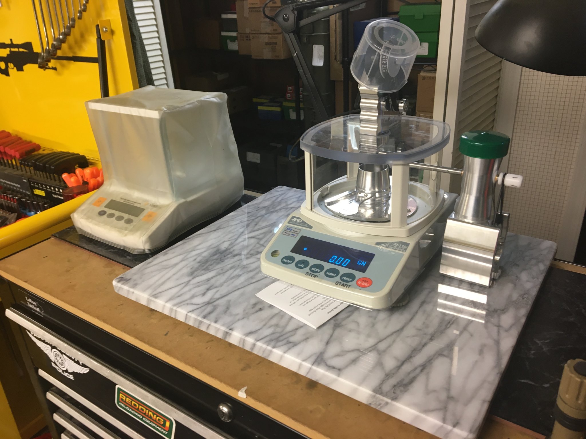

I’ve got mine set up on an old roller cabinet (tool box).
The scale itself is on a marble cutting board alongside my old Sartorious scale that’s on a piece of marble floor tile.
I do run a line conditioner with it and the Sartorious.
I use a liquid detergent measuring cup/cap to cover the auto throw and the cap off a Redding powder hopper on the Trickler.
Edited to add: I never turn any of my electronic scales off.

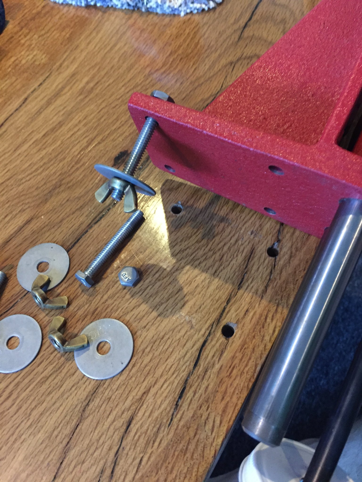

I tapped some holes in the coffee table and load on my couch. A few wing nuts and bolts and the press is on and off in a jiffy with no penalty but a few holes. Then everything goes back to the counter top instead of inside the empty cabinet because I don’t care that I can see it the rest of the time. But it could be stored (hidden) if someone were to bitch about it.
