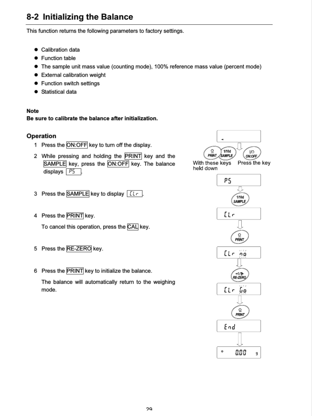

Resurrecting an old on here. But does anyone know how to restore the scale to factory settings so I can reprogram the v4. My uncle had some issues getting to grains and tried to program but not thinks he messed up and we want to start from scratch and re program from default factory settings.
Thanks
Is it a full factory reset or not?
There is a list of parameters that will be set to factory setting but not sure there are all parameters of the scale.

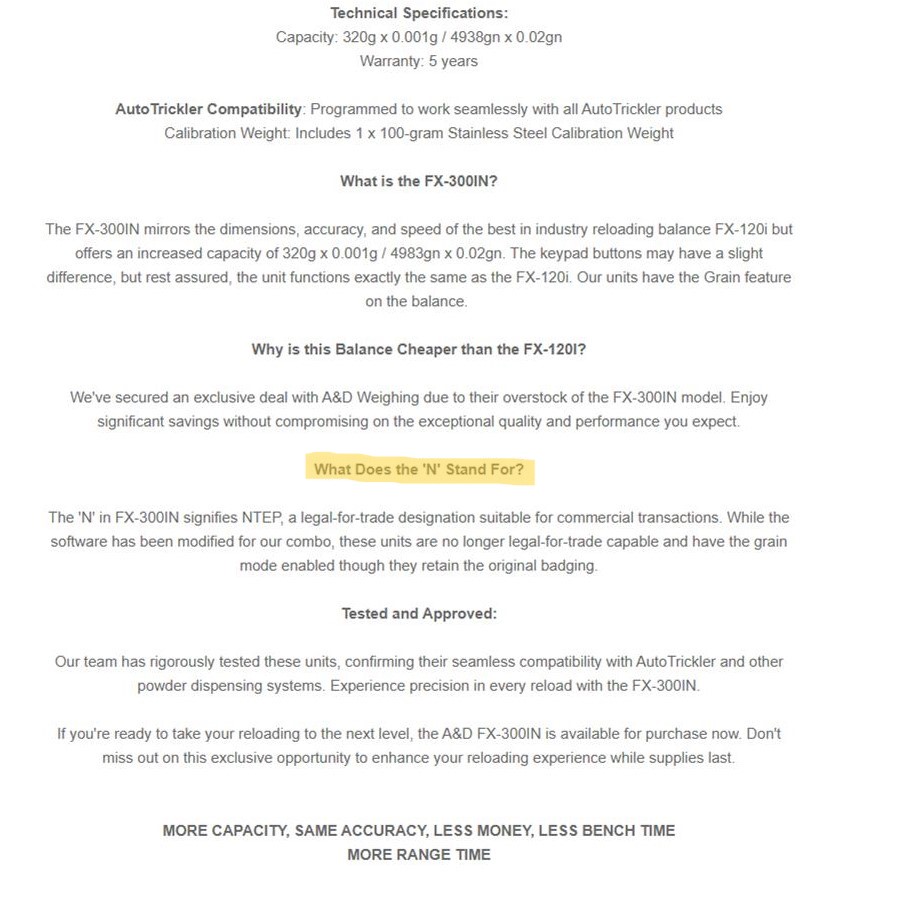

I purchased a N series scale locally, legal for trade....before I ever knew there were 2 versions. I'm not able to get this to work on mine but I'm not ruling out user error either. Can anyone confirm if you can add grains to a FX-X00i(N) series scale with the above or any way else?

I don't think the "N" has anything to do with the types of units you have access to. The 120I and the FX-300iN is simply that is has more load capability. And there's an explanation as to what the "N" stands for:
I agree the scale should have Grains support but it's turned off because Grains is not a recognized unit for commerce by NETP. I'm pretty sure I need to get the super secret menu stuff from above to work in order to enable it.
Yes it came with the same manual, but also an addendum that explains the differences. The calibrate button is on the back of the unit behind a cover, the 3'rd digit has a circle around it / highlighted and it comes with the anti tamper kit for your local weights and measure certification.
I called A&D and they walked me through it. Because my scale is NTEP certified the "secret" menu system can only be activated by using the the calibration button in the rear. It's the same process once you get to the unit menu.
