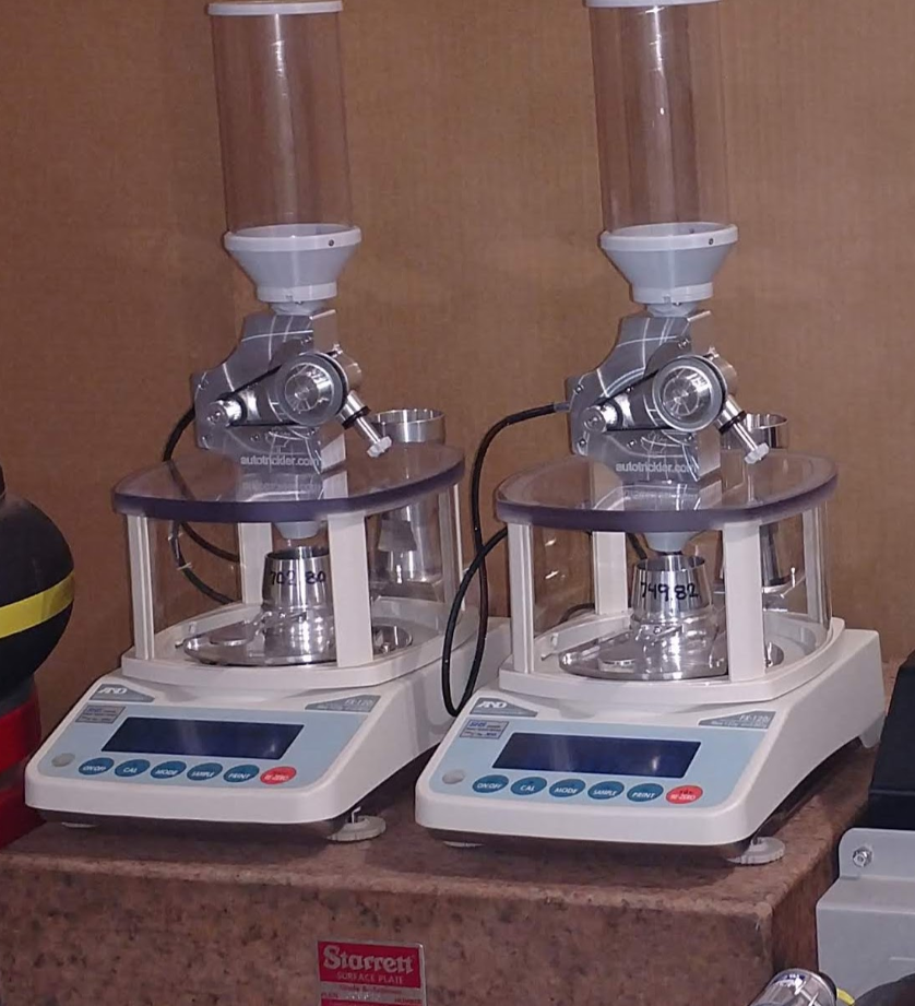

Is there a better scale than the fx120i for a man's money to feature ratio?
(I'm never buying a Prometheus scale)
The only thing better than the Fx120i is two Fx120i's 👊

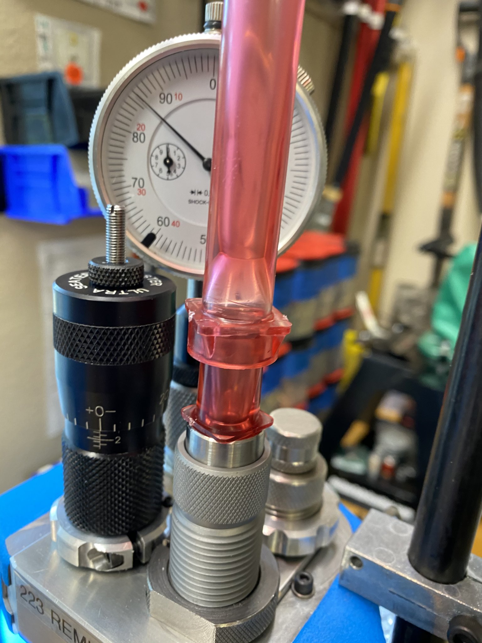

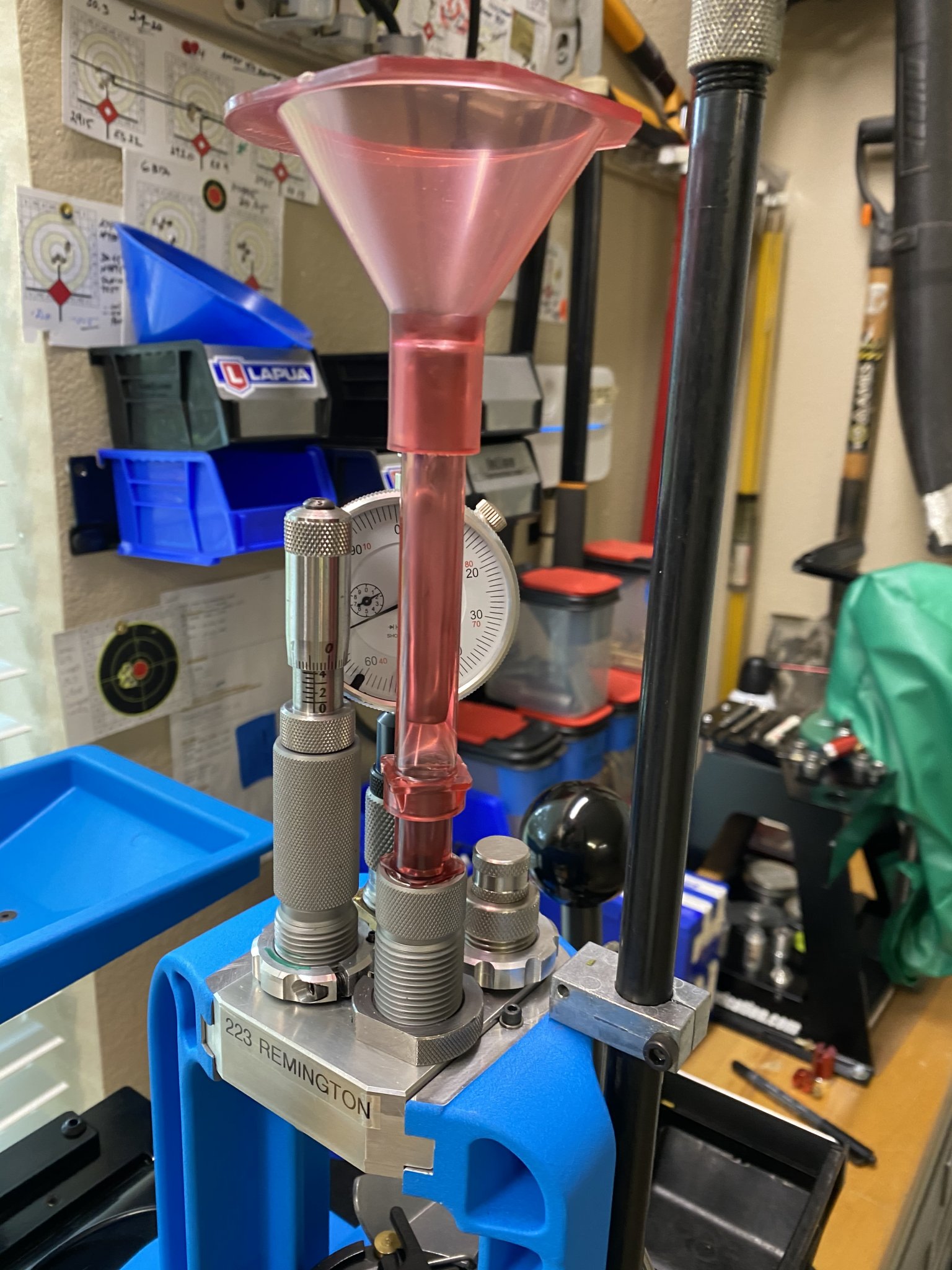

What's the best way to set up to pour the manual charge into the case on a 550?
I’ve tried most combinations for powder kits: Dillon, Area419, RCBS & Hornady.
The most trouble free is the Hornady LNL powder funnel die coupled with the cheap MTM plastic adapters.
Transparent, nearly bridge free & provides the snuggest fit. The Dillon powder die funnel head is loose & wobbly in comparison.
(The combination above bridges frequently & you’ll never know cause you cant see it. I started with that combo & switched to Hornady)

So this way mates right up to the dillon powder die and caliber specific powder funnel in the conversion kit, correct?
Easy peasy?

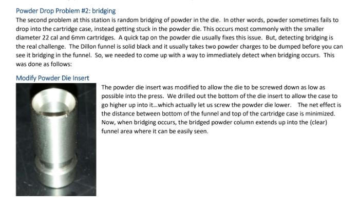

Trust me, I’ve got the 419 setup & you’ll never be sure each charge is true because it will bridge and you wont notice for several rounds because the bridge builds slowly.
I use the area 419 with two or three 3" extensions. The Dillon powder die adapter just sits on top of the powder die. It is not thread in. I adjust the die so that the sliding insert will push the powder funnel up slightly when you lower the RAM and push the case up into it. So when I raise a case, charge it with powder, and lower it the entire funnel assembly moves up, then down onto it's shoulder. I do this to eliminate any bridging. It works pretty well.
Same as me...I have never had a powder bridge doing it this way all the way up to 93 grain charges
Ive been doing the exact same thing for years now with the Area419 setup and drop tube. I always adjust the powder die so the entire funnel/drop tube setup pushes up a little bit. Never had any bridging in 100's of thousands of rounds to date.

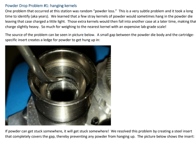

Well, I haven't been so fortunate. Perhaps some mods can be made to address the issue; but the issue is real, and insidious (for me).

In any case, the Dillon 550 & Fx120i combo produce outstanding results.

One thing to state, I do not use my powder dies as they come stock from Dillon. All of my powder dies (the part that is caliber specific and slides up and down, not the die body) are polished to a mirror finish and there was an entire thread on that on here somewhere with what I did, how and pictures. They are literally polished to a mirror finish. They have lots of tooling marks in them from Dillon.....Just adding that to this discussion....
