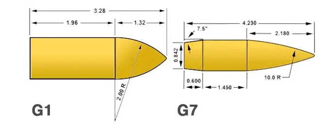

    A G1 value/number is just a way of measuring/assigning a Ballistic Coefficient (BC) value to a projectile (a G7 is just the newer, better way of coming up with the same type of value/number and is what most use these days). The higher the number the more aerodynamically efficient it is supposed to be.
    Generally speaking, a higher BC number is always more desirable... but BC is one of the last things that determines whether a bullet shoots well in a given barrel, marrying the ideal twist (and even chamber when talking .223/5.56 vs .223 Wylde) with your chosen bullet weight matters far more.
    In simple terms, if you and I were the same strength and we each threw a rock equally as hard as each other, the guy with the larger higher-BC rock would end up with his flying truer for further.
    Reactions: HeavyAssault
    And just to add a bit more clarity, the G1 BC is computed using a flat base profile, which was much more common in the olden days, while the G7 is computed using a boat tail profile.
    Why not just use G7 for precision shooting if it's more correct ? G1 is often a good enough approximation, and up until more recently it was the most common model used/published publicly. These days a lot people use custom drag models that are neither G1 or G7.
    I’ll look at that G7 number if it’s provided. Not all data is shared or hard to find even on manufacturer sites. Thank you!
