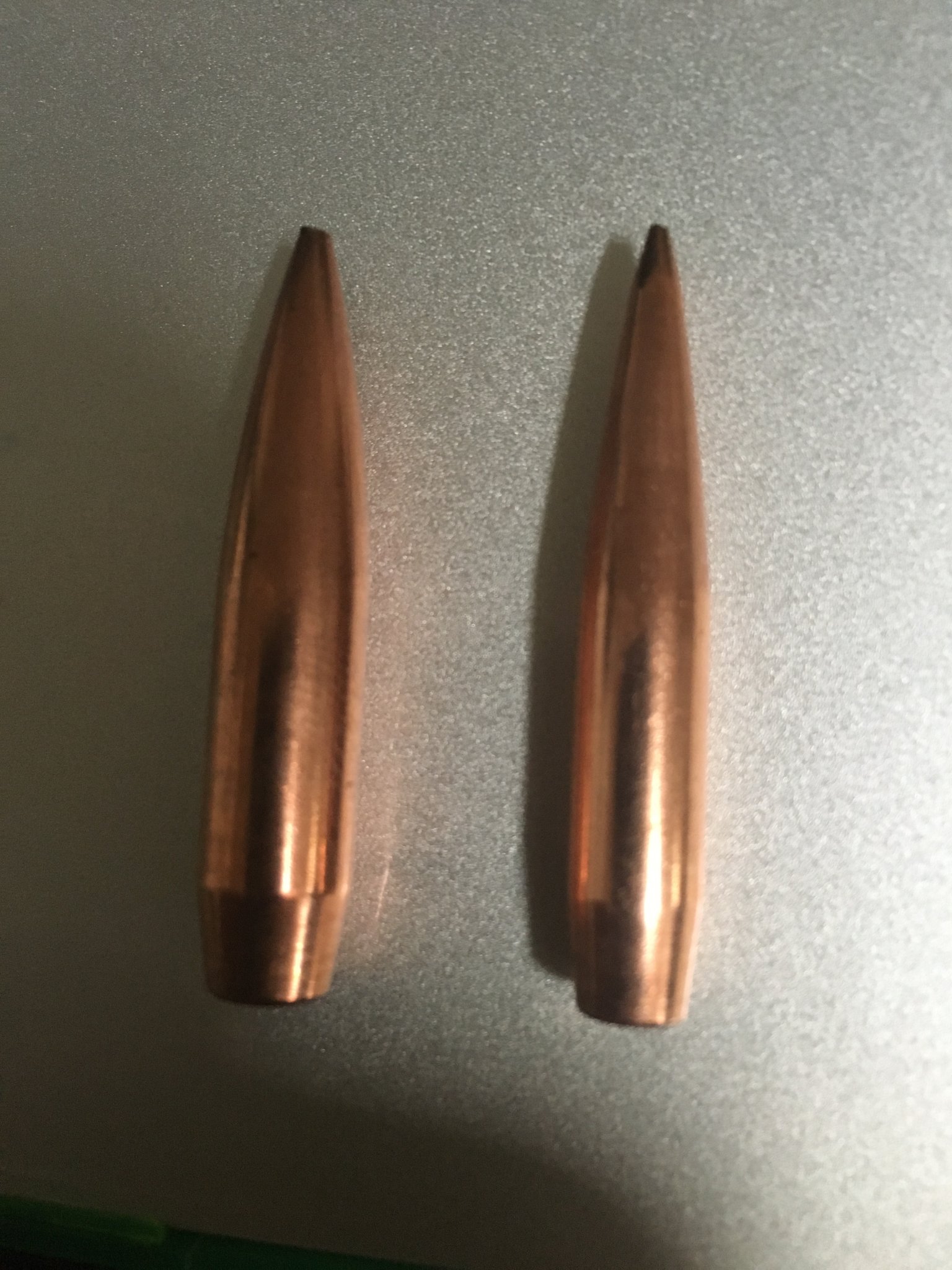

    This is what spurned my original question. The bullet on the right should be about as G7 as anything out there. The one on the left is a 300 SMK for reference, so you can see that a bullet 103 grains lighter is just about as long. The G7 calculation seemed pretty modest to me, and was barely making it out past a mile transsonic

    What you are seeing is two different lots of bullets. Left in for a reason.

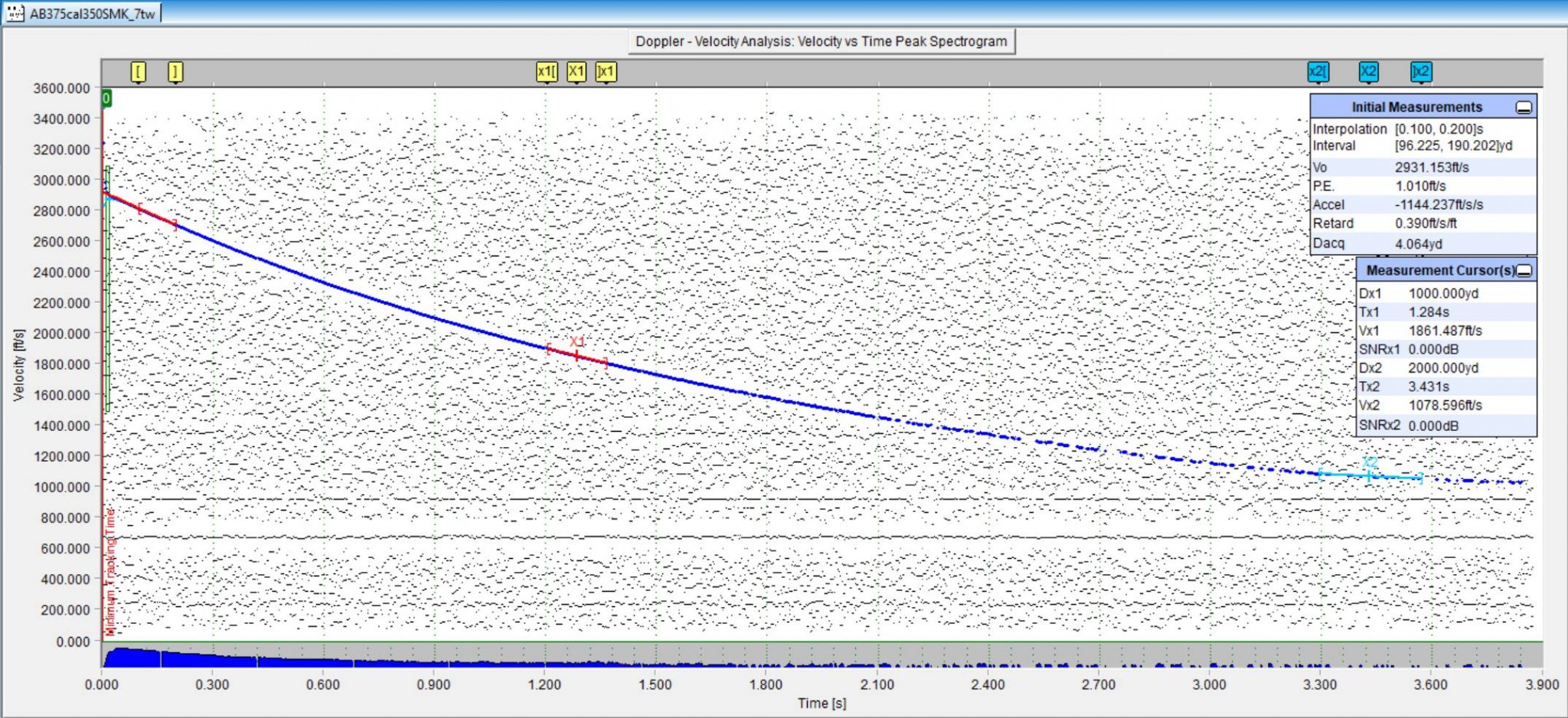

    On the other hand, the Doppler radar used by Hornady and AB can't track a a rifle bullet beyond 1200/1300 yards (and this is under ideal conditions). Meaning the transonic zone is hardly captured (velocity loss) for the usual ELR rounds (and many others), which in turn yields a big question on the data obtained for transonic/subsonic predictions.
    http://www.infinition.com/site/index.php/us/products-us/10-ghz-en-us/br-29015-en-us#performances
    Lets not spread lies now. This bullet stopped tracking when it impacted the target beyond 2000 yards. The Infinition is not the only radar we have as well. We have 3 radar heads. The Infinition is our portable system.
    Must be all that "hype".
    Would be nice to know what other radar heads you actually have...apparently the Infinition is just a toy in your arsenal, speaking of lies...never AB displayed or detailed any info other than the Infinition unit. So, who is spreading out misleading info?
    Btw, the data before and at 2000 is basically useless.
    Cannot give away all of our labs secrets, not every project is public. Very few actually are. But the infinition highly valuable piece of equipment especially due to its portability. Users will see just how valuable as we advance peoples ideas of ballistic solvers. Take 2 or 3 of the many systems we have and couple them together and we can get high resolution data at very long range. The information at 2000 yards is far from useless. But I am more excited about some of the upcomming releases of information we have in store.
