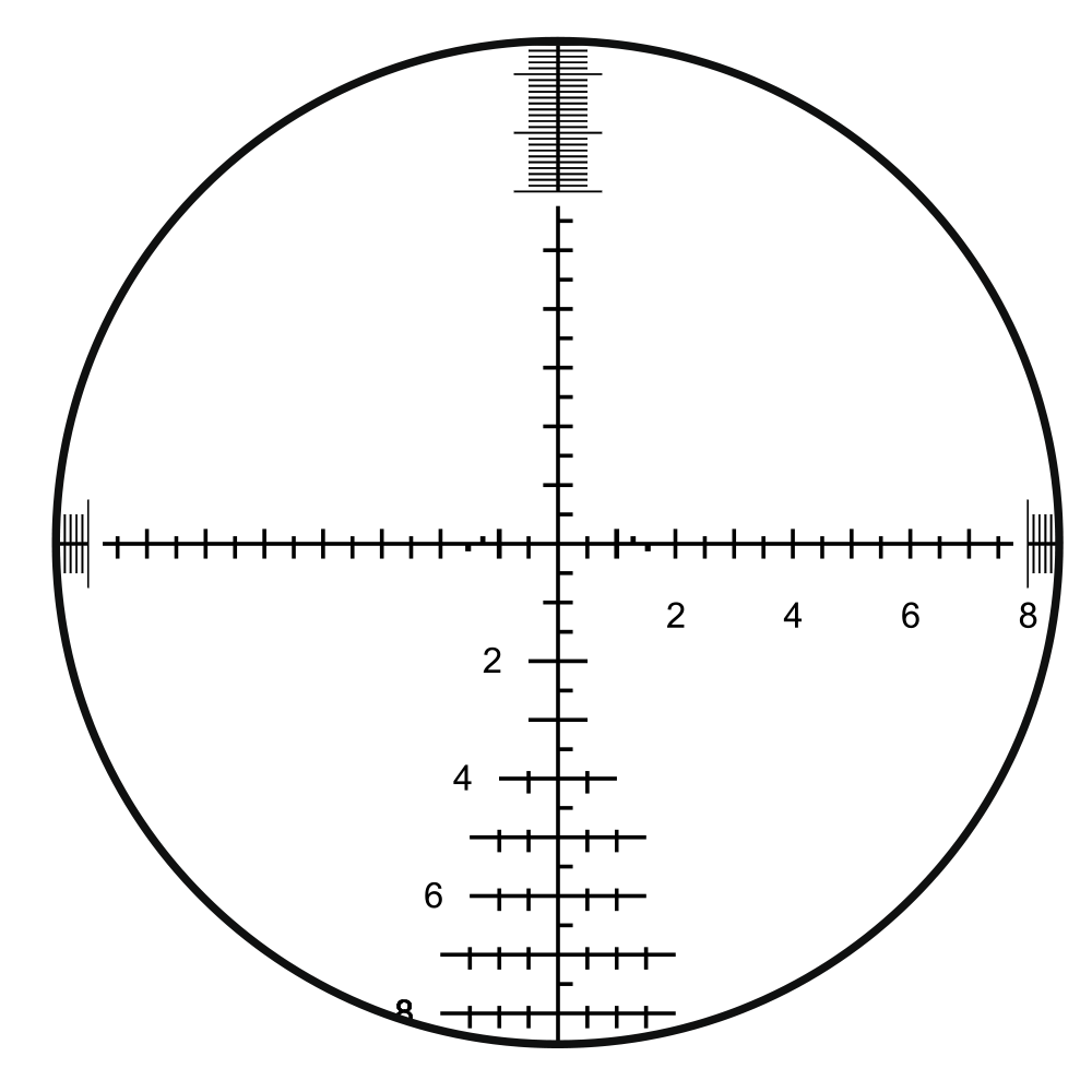

Looking at a Bushnell DMR2 but not sure which reticle to go with.
The optic will have to wear many hats as it will go from my centurion barreled ar15 I use primarily for varmints to my 6.5cm ar10 that I’ll use for my primary hunting rifle as well as range work at distance.
Im leaning towards the g3 reticle since it’s essentially just a basic mil reticle with a couple additions and I’m thinking that in a hunting situation it may be quicker than the H59 but I’ve never used a Horus reticle before.
My other option is saving a few bucks and getting a vortex pst gen2 5-25x50 ffp, but I think I would rather have the additional low end of the dmr2.
H59 to G3, hummmm, completely different ends of the spectrum almost. Unless you have used an H59 in the field, I'd stick with the G3. Personally, I like the H59 for LR stuff but i think I'd really hate it for hunting.
I opted for the G3. I just dont see how I would ever need to measure that far out to the sides that accurately to make a H59 worth while.

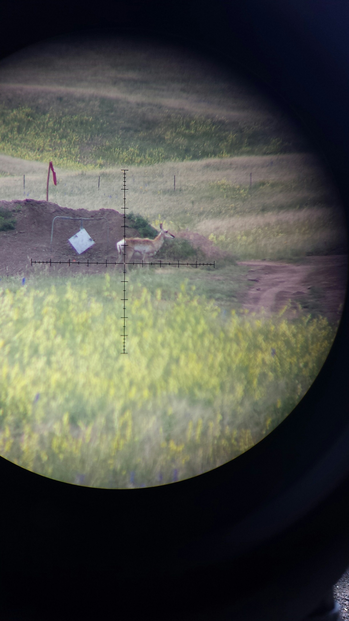

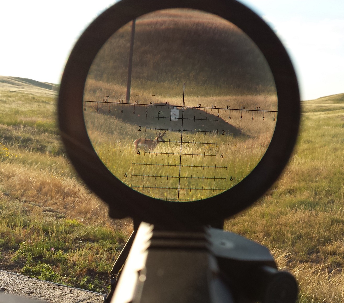

Ok, not trying to wack the hornet's nest with a bat here but I don't understand when people say that they like the horus (or grid style reticle) for targets but not for hunting. I look at it with an analytic mindset. When shooting targets I dial my hold and then I have a precise grid for my wind call, I can also use that grid to spot my misses and make corrections. When you dial the scope back from full power the reticle gets finer, so if the thick lines get too busy for you, then back the power off to make it thinner. At 5x on a 5 to 25, the reticle is so thin you damn near cant see it.
Now when hunting I'm all about looking at the calculator and your data charts and wind calls and all the other information that gives us all headaches and analyzing what is my min and max holds for both wind and distance, and I use a bracket method to maximize my hit potential. I can essentially make a box that would be a "kill zone" in the reticle To me, using the grids allows me to analyze what could go on with the bullet if my wind call is off or if I forgot my rangefinder in the truck. Now I will admit that when I hunt I'm not snap shooting. Im sitting on the side of the hill watching a valley so I have loads of time to gather my data before ever getting on the scope. And for those who argue that you cant see enough detail through the grid to tell how many points that buck has or look for that black patch on the antelope...well I say....look the hell up on the other half of your scope! There is nothing at all going on there so it's clear as can be.
Again, not saying the reticle works for everyone but it works great for me since I like to bracket both targets and animals. Not trying to call anyone out, but I have always thought that if it works on a 6" steel plate, why can't it work on a 4-foot wide animal. Its all about knowing how to use the equipment. Hope this is a good contribution to the 9mm vs 45ac.... I mean reticle argument.
I have attached 2 pictures to illustrate what I am talking about, I believe these goats are both around 500 yards out, can't remember, it has been a few years since I took these photos.

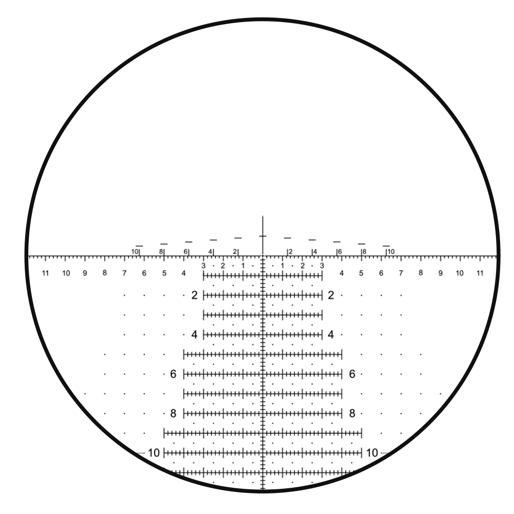

I love my H59s it's the only reticles i run now. While there are plenty of other great reticles, once you really get in and shoot a fair bit behind any of the busier tree reticles all the "expected" confusion goes away. You end up looking through all the suppossed clutter...or at least i do anyway.
That all being said, i'd go with the H59 over the G3 for a few reasons i prefer:
1. . Floating center dot, i almost can't stand shooting reticles with solid centers anymore
2. .2 mil hashes, i love the fact that i can subdivide so precise at distance. How much it really matters vs just eyeing it between the .5 lines in the G3
3. Mover lines are great when shooting mover stages in matches (although the first one has also been added in the G3 so i guess that could be a wash)
4. the fast ranging lines are kinda handy sometimes when showing up to a new range and having to get some quick ranges for practice targets if i don't feel like getting out the LRF

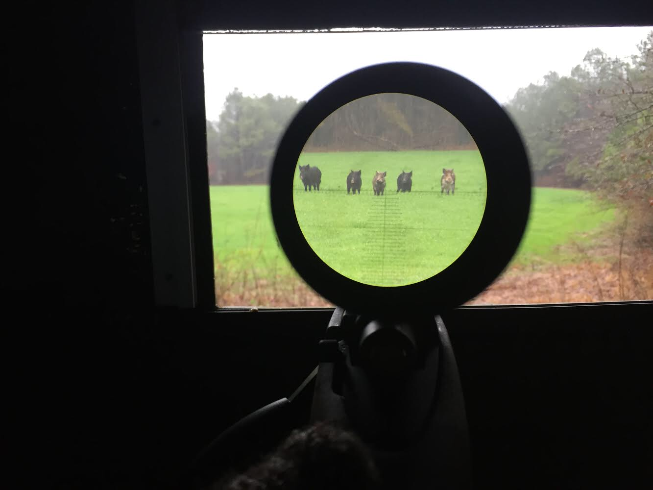

Certainly not someone I’d take advice from ? but I’ve hunted with an H59 on a Leupold Mark 6 when that was the only scope I had. Holding the phone with my hand several years ago is why the pics look so bad, looked much better behind the rifle. Agree that it would be much better with illum. Thinking about getting an illuminated tremor3 for my newest rifle which tells you I like it ?.

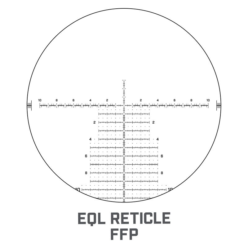

Going to ressurect this for a second.
Midway has the XRS II with G3 for 1058, and the H59 for 1208, free shipping on both.
I just got an LRTS and I love it, this is obviously a step up.
Really considering picking one up while they're still in stock, but torn on reticle.
This won't be a hunting scope, just for steel and competition. I like the G3 on my LRTS, but I also like the EBR2C on my PST Gen 2, so the christmas tree is helpful to me.
Thought son the value of the extra 150 for the H59, really thinking I don't need it.
I don't like the G3, but it's fine for competition especially until you are capable of consistently achieving 80% on target in a real PRS match. At that point, you've honed your ability to dial and handle windage on the main crosshair and you may need something more to take you to the next level. Still, it's not like users of the G3 reticle have never won a competition. It was designed by one of the most well-known competitive shooters, after all. The funny thing is, I achieve better scores using a Nikon FX1000 with it's non-tree reticle (with .2 MIL incrementsin all directions) than I do with any tree reticle. I'm not PRS'ing a zillion times a year and we're talking two different guns (I have far better DOPE history for the Nikon gun) but... still. I rarely, rarely find myself depending on a tree. You need a lot of experience to be able to mentally process all of that capability in real time.
