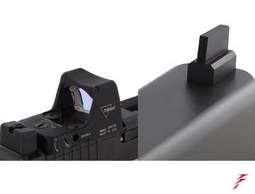

On my Glock 40 MOS with Deltapoint Pro mounted, I used this sight set from Dawson Precision (black front and black rear). Since the DPP on a MOS plate is so tall, this set is basically a lower 1/3 cowitness.
•Dawson MOS Co-Witness Fixed Rear .495 Tall x .125 Notch Width
•Dawson Fiber Optic and Black Front Sight .485 Tall x .100 Wide, Tritium .125 Wide

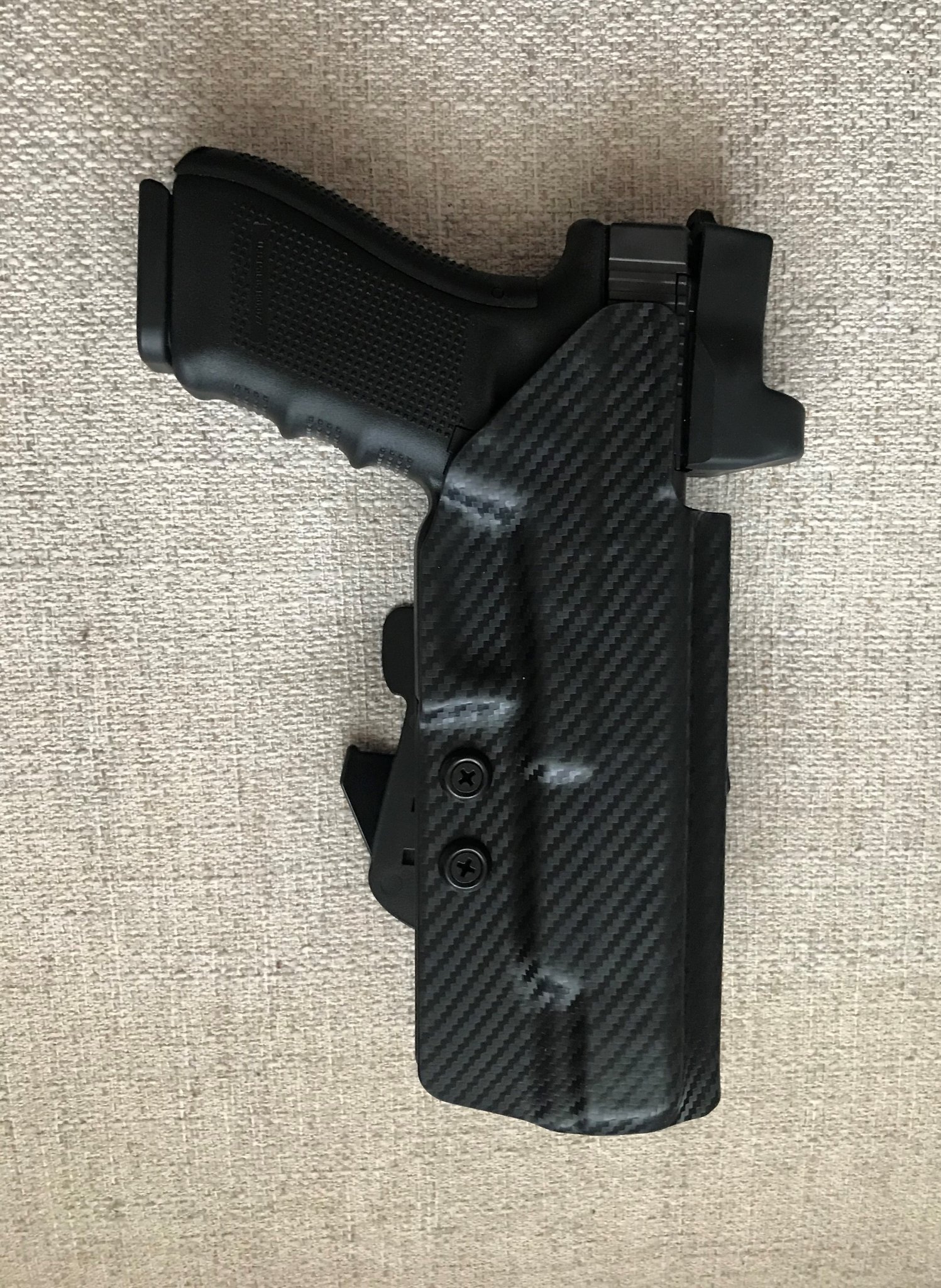

Don’t know what holster you use but those sights are really tall and won’t fit the Guides Choice I know.

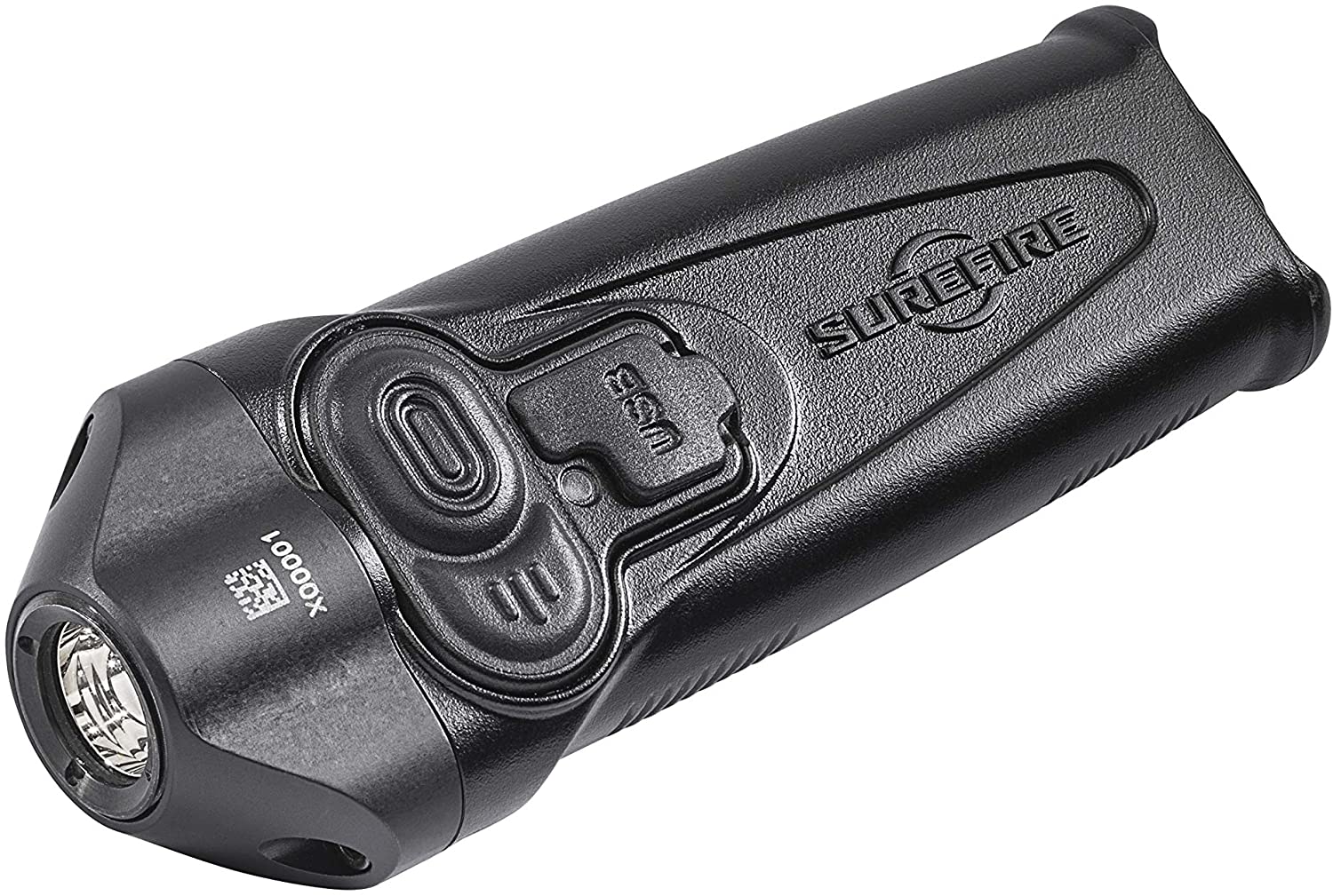

SureFire Stiletto
