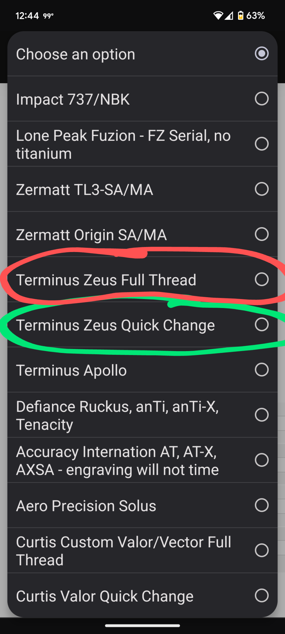

One thing that I should point out, if you want to utilize the Zeus's QC feature, the barrel has to specifically be cut for that.
Gunsmiths can spin up barrels for the Zeus in one of two ways: 1. To be torqued on, or 2. To use the QC feature. They will be cut differently to accommodate one of those two.
Here's an example, taken from TS Customs site:
The one circled in green is what you want. Red is if you are planning on torquing it up, which would require the equipment I called out in an earlier post:
