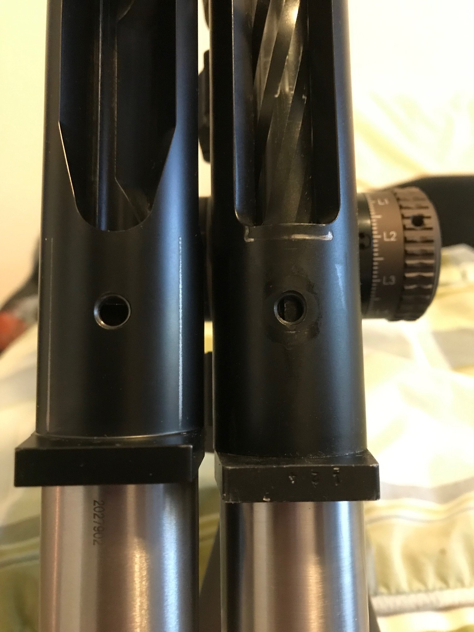

Yup I have a Templar from 2008 which I built my original 6.5 Creedmoor on, and the first Creedmoor GAP ever built ;) , and that covers it. It's a good action but not 100% 700 footprint. Below is a pic of it on the right next to a 700 footprint TL3 and you can see it's a little longer. You can make it fit in a 700 stock with a little work. I also would be surprised if it was still offered by GAP. I thought they moved on from the original Templar a while back.
