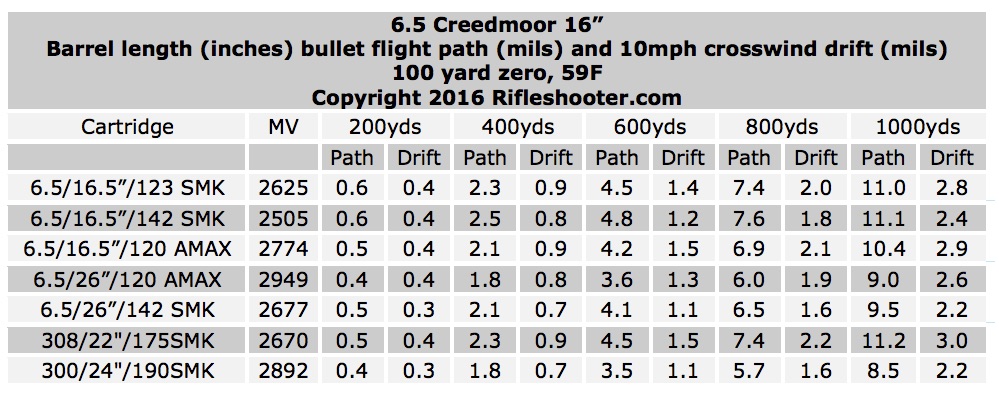

Hello Hide. Well I recently purchased a GAP10 G2 chambered in 6.5 Creedmore. The post said it had an 18" barrel. Well rifle showed up and barrel is chambered in 6.5 Creedmore but the barrel is 16.5" long not 18". The Gentleman I purchased it from is willing to give me my money back when I ship the rifle back to him. Was a good deal and would like to keep it. Does anyone have experience with a short (16.5") Creedmore barrel? Need advice . Keep it and shoot it or send it back. Don't want to shoot rifle or experiment with it if I don't intend on keeping it. Thanks for your time in advance.

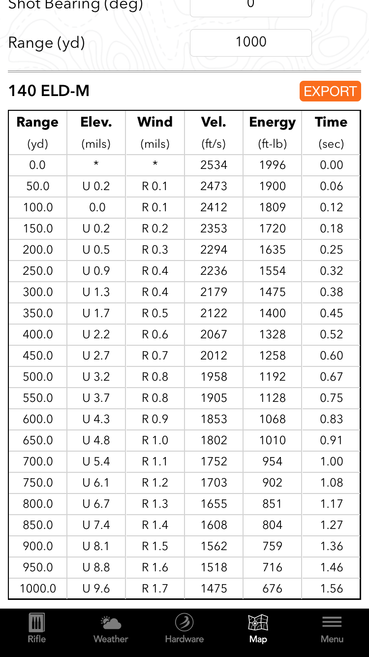

I have a 16.5” barreled 65Creed on a bolt action, with a suppressor (+30fps.) I shoot 140 ELD-M factory ammo at 2534 fps, and don’t have a single problem laying the smack down on an animal for an ethical kill shot with with plenty of energy and expansion velocity out to 600 yards or so. When I shout steel targets out at 800 yards, it’s usually me that misses, not the rifle or the ammo.
There’s not a thing wrong with a 16.5” barreled Creedmoor. It’s all about taking the time to understand what it’s capable of, and being realistic about what YOU’RE capable of. I am not trying to be a dick here (serious)..... but if you have to ask a question like this I’d be willing to bet you’re own skill set is going to be more of a limiting factor than a short barrel. So buy a case of shells, some good solid repeatable optics, and go hit the range!
My current dope at DA of 3,500:
Short 6.5 is awesome. If you’re okay with 18, then I don’t see why 16.5 would be much of an issue. There is a little bit of loss but it depends on what you are trying to accomplish. Are you trying to get the shortest possible (still usable) package? Are you trying to shoot the longest distance possible? The probably 30-50fps lost won’t mean much to you. And are you sure you’re measuring it correctly?
You really start loosing it quick below 22” length, typically go from losing 5-10 ft/s 22” & longer to about 30 at below 22” inches.
This is one of the reasons Glen Seekins chose a 22” for the SP10.
If you got a deal keep it and just get a new barrel after 2500 rounds or so.
