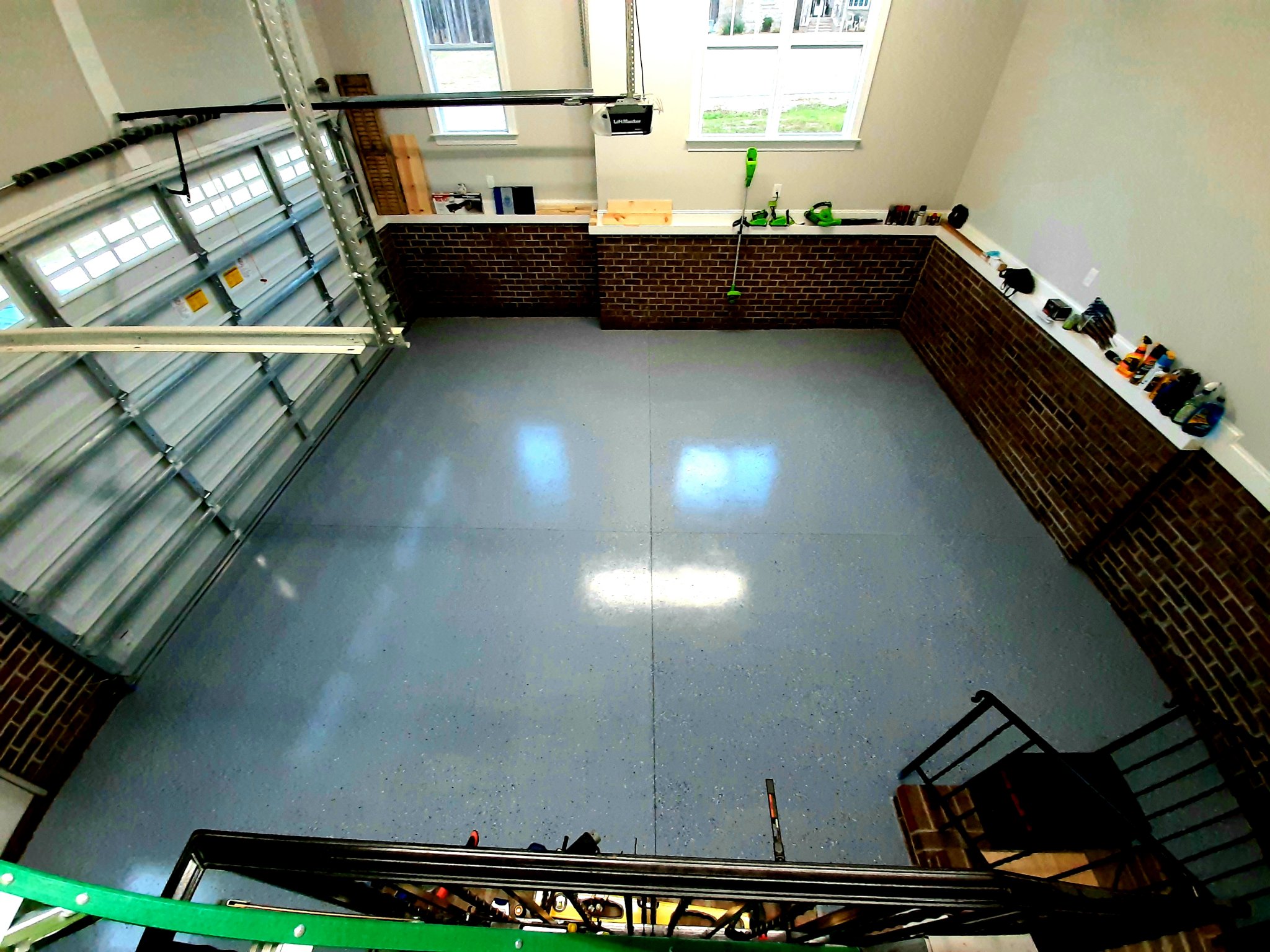

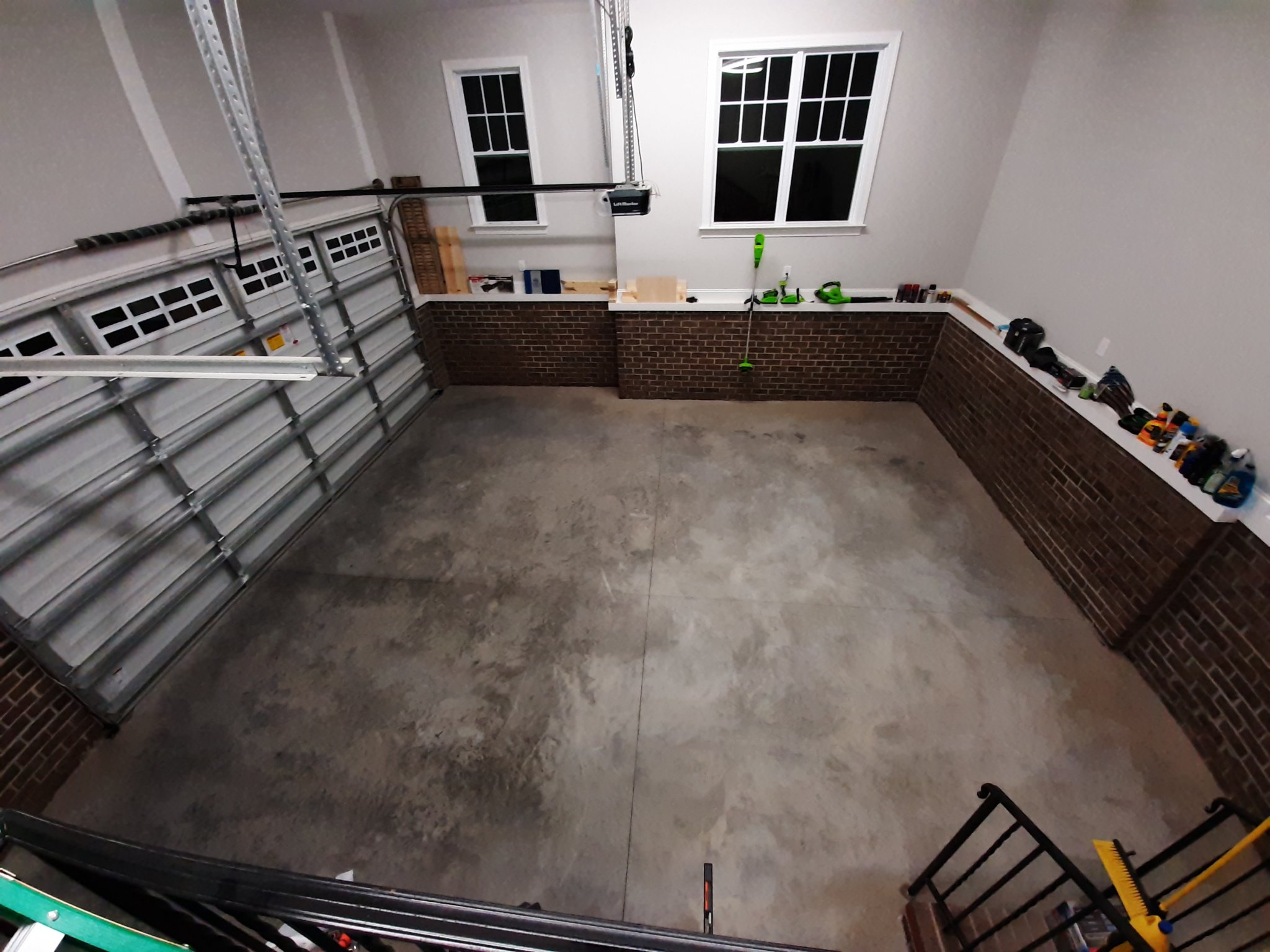

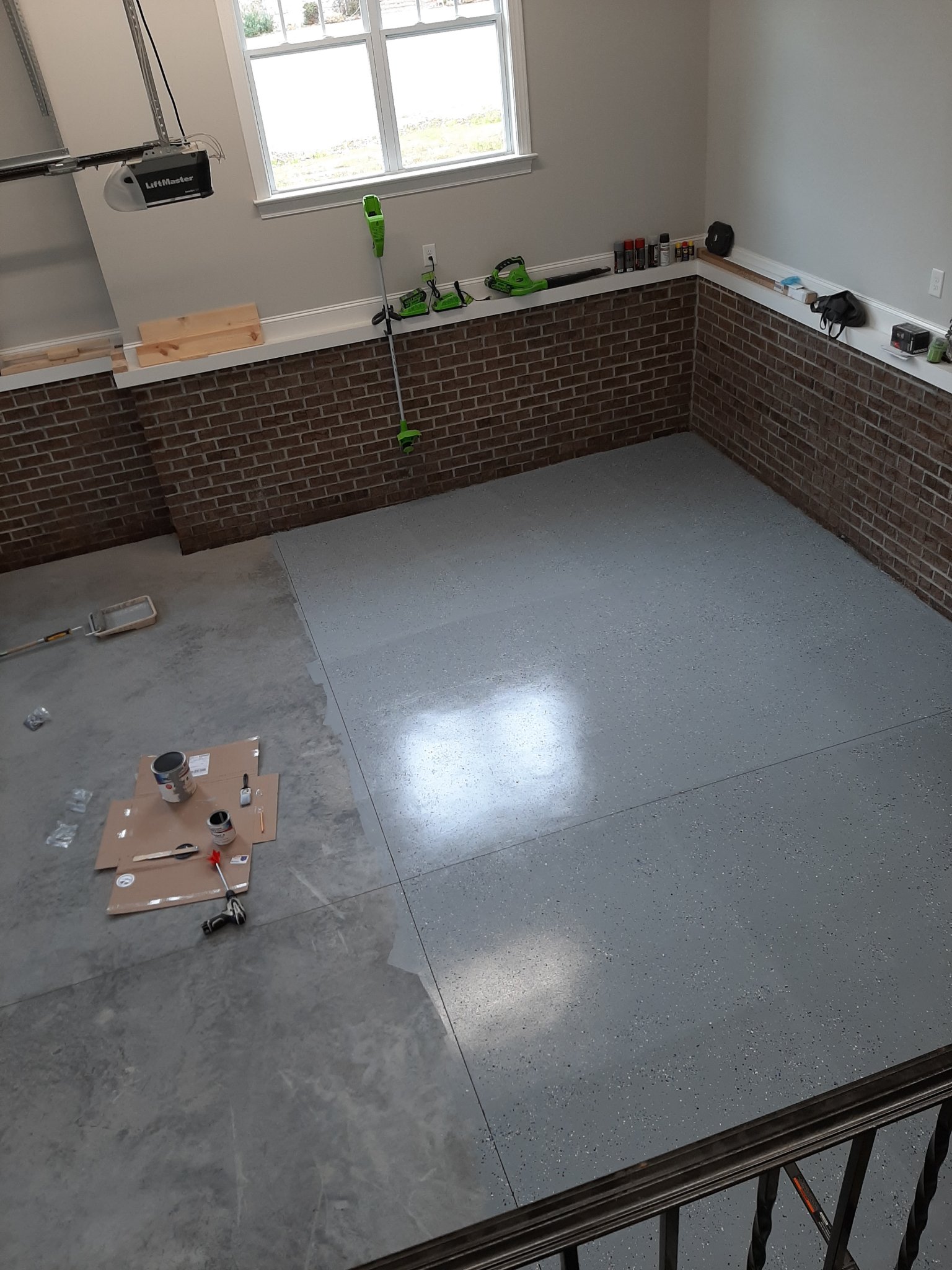

    To update if anyone is interested. I'm a year and a half into my coating with the epoxyshield. I have a 2 car garage and I got the 2.5 kit and had plenty to go thicker if I knew any better. It's held up to the tractor and parking my boat in there and dragging kayaks around often. No chops, peeling, etc. I'll probably go with something more heavy duty when we build our detached garage where I'll have my machinery and heavy shit but overall I've been pleased. As with everything painting I was anal with prep, truely is the key.

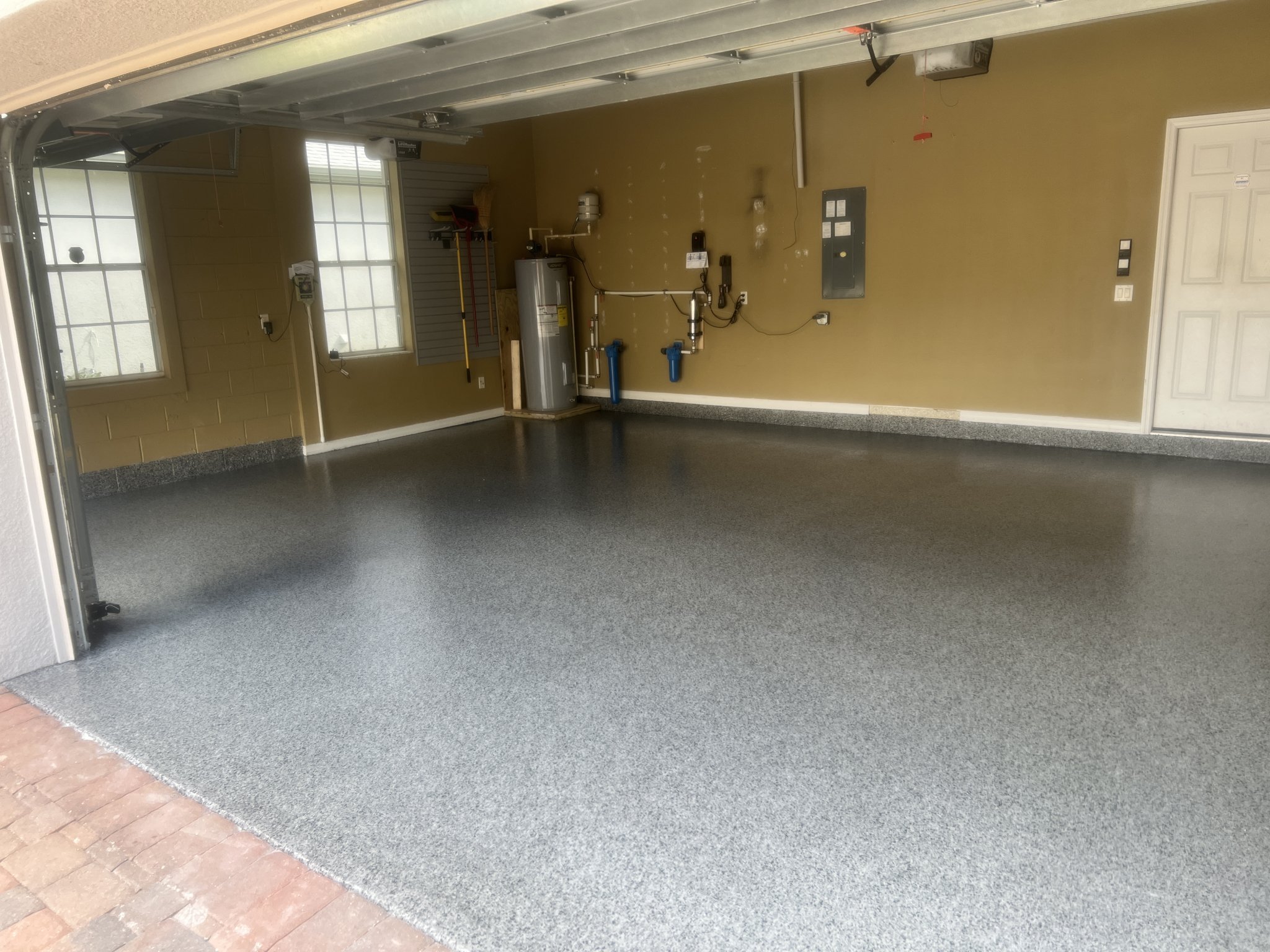

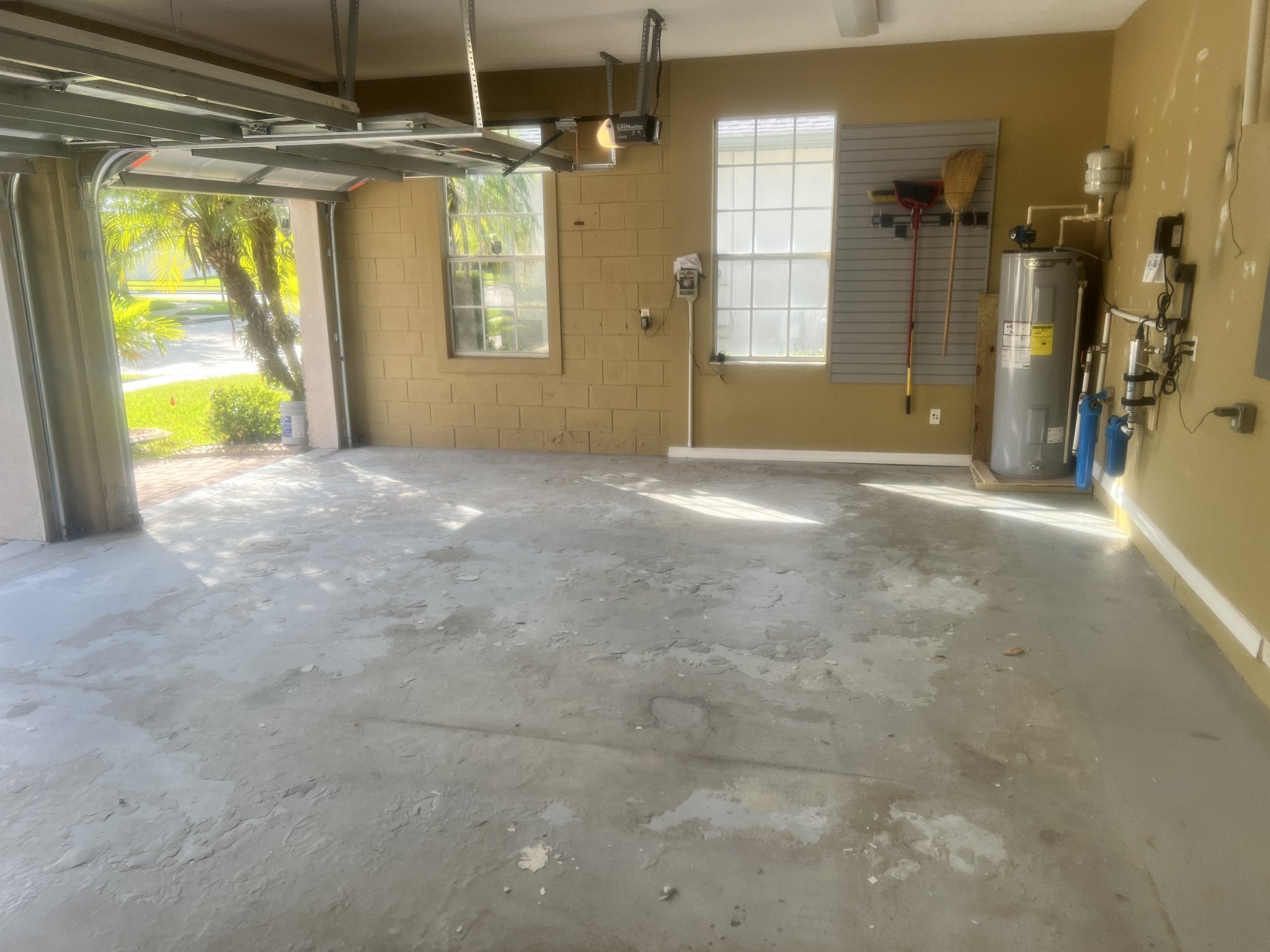

    I recently bought a house and I’ll be moving next month. I was considering having an epoxy shield coat professionally installed since I intend to be there long term. Has anyone had this done to their garage floor recently, and how much did you pay for it to have done? The one I am looking at is approximately $4100 and comes with a 20 year warranty for a 3-car garage that has approximately 600 sq feet. This price includes surface preparation of the existing concrete since the house is not brand new.
    Thanks
    Thanks
    That price seems high to me, I would have expected a price in the $3000 range for an epoxy flake floor. Not sure where you are and I'm sure prices are going up just like everything else but I would try to get a second bid.
