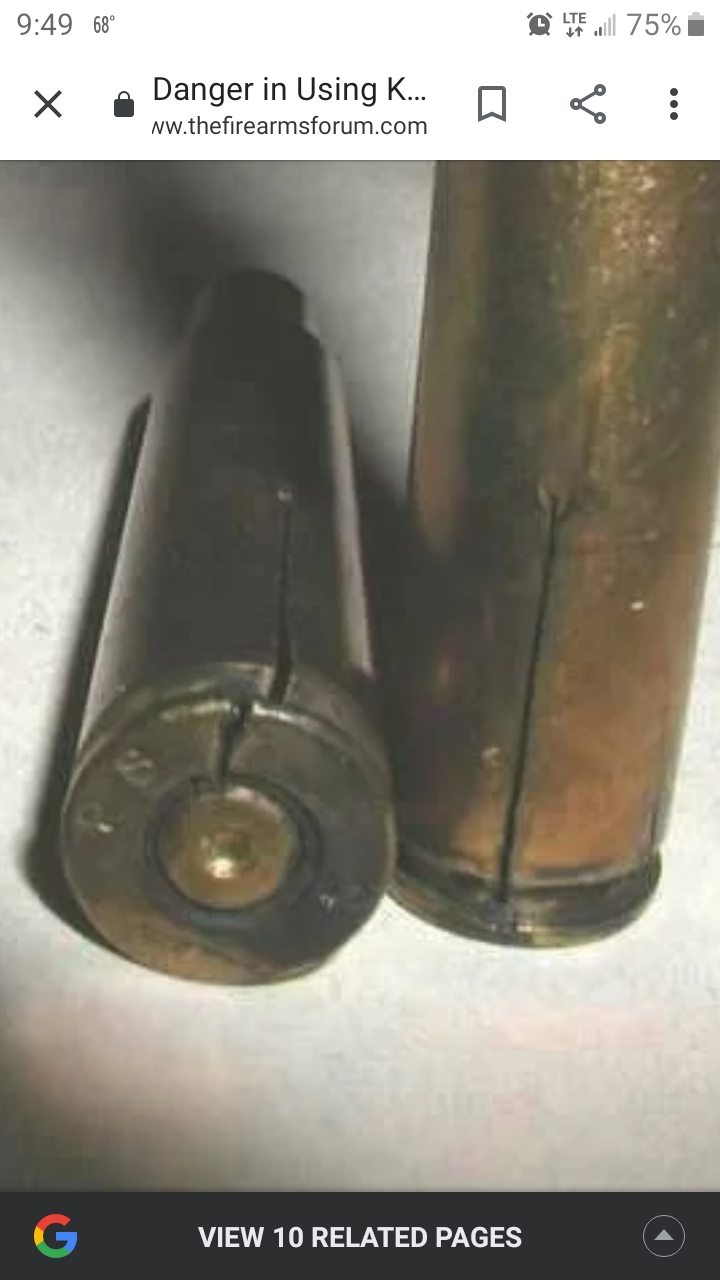

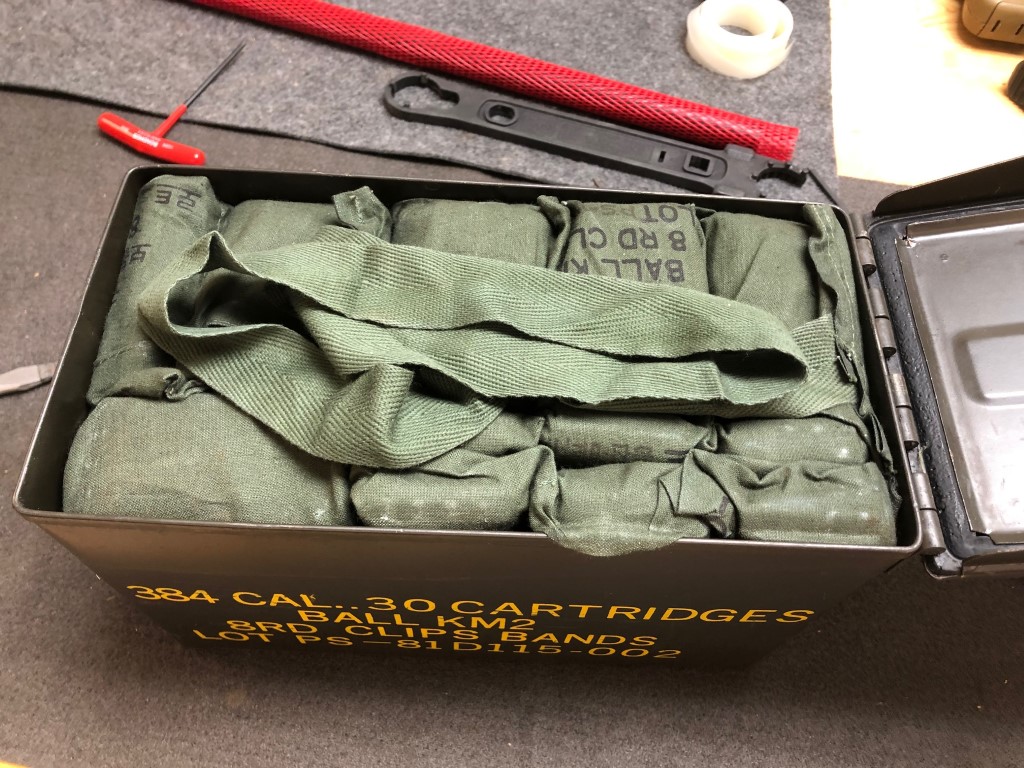

    I've got a couple cans of Korean 30-06 (PS-81) for my get around to it one of these days Garand projects. Yay or nay on shooting that?
    I've always avoided it myself.
    Some is corrosive and some have cases that seem to have not been properly annealed and can rupture in the head area, or both. Headstamps to avoid are PS, TK and TA.
    I tend to stick to U.S., Greek or Austrian stuff.
    Others opinions may vary...

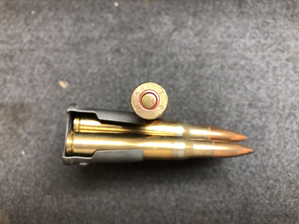

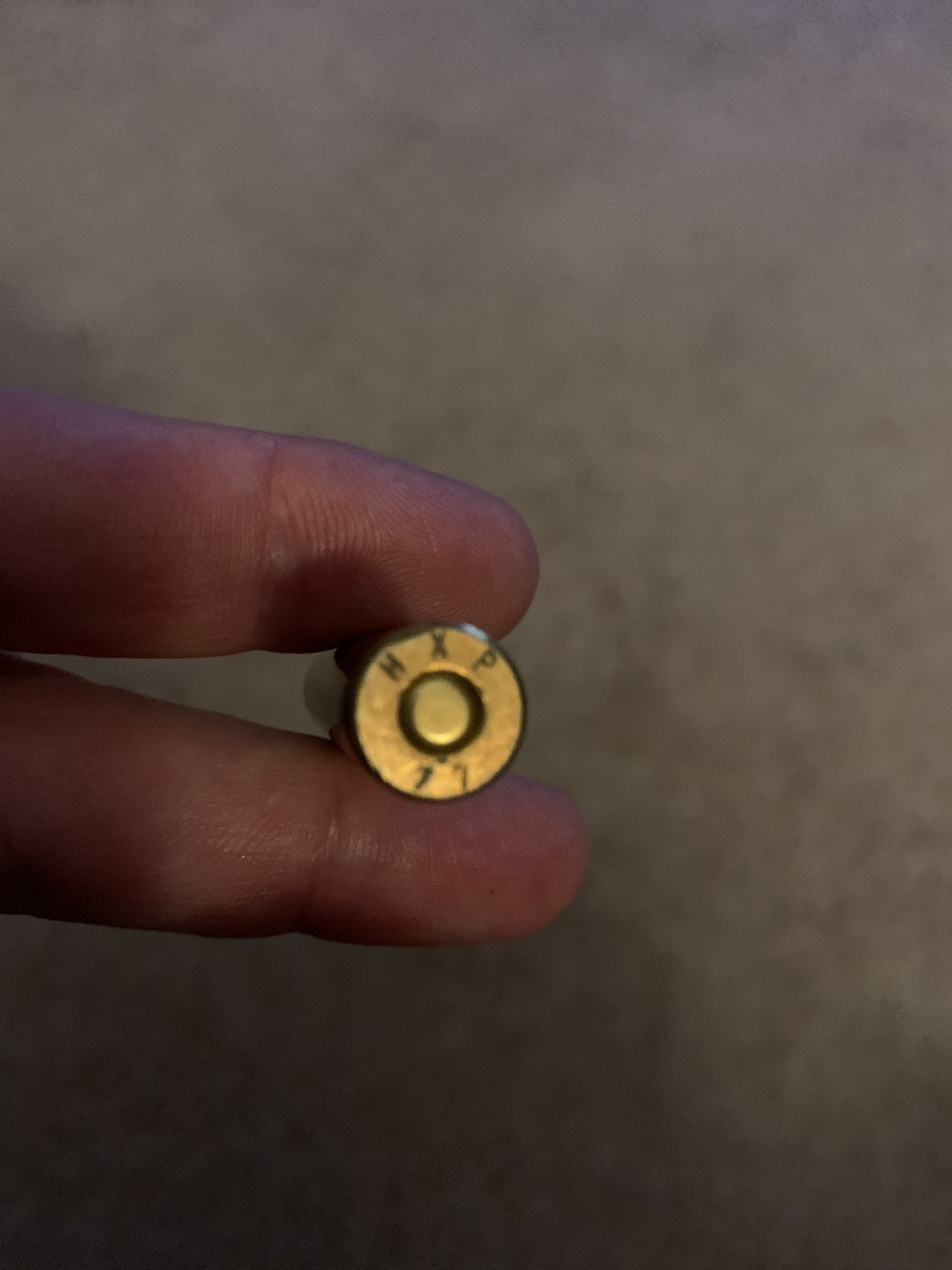

    The stuff thru the CMP was never offered (that I saw) as "Greek delinked" - just in the green spam cans of bandoliered and boxed. Delinked with the 1968 LC stuff sold in brown CMP boxes inside green flip top cans.
    We bought thousands of rounds is plastic bags loose in 30 cal cans from CMP store at Camp Perry over the years
    HXP headstamp from many different year stamp that was all delinked and had the link marks on the cases
    I’m still reloading those cases
    Some is corrosive and some have cases that seem to have not been properly annealed and can rupture in the head area, or both. Headstamps to avoid are PS, TK and TA.View attachment 7591313View attachment 7591314
    Thanks, any others with experience. Quick search shows some comments saying is/may be corrosive and many saying not, good ammo, etc. Have long forgotten the history of it but wouldn't have bought if I thought it was. Also have some Greek so at least I've got something to shoot if I ever get around to building.
    Corrosive is only an issue if you don't stay on top of it. I shot plenty of older Korean ammo through my M1 about a decade ago. Break it down, flush it with windex or soap water, or Hoppes... clean normally, oil, reassemble, check back in a few days.
    That said, HXP shot better, is better brass for reloading, and isn't corrosive. Easy button.
    Reactions: Waorani
    PS is supposedly non-corrosive, but why risk it? Just shoot it and clean as if it were. Soapy hot water cleans the KCl right out.
    Reactions: Waorani

    Thanks, I can deal with it potentially being corrosive but would rather not have to. Case ruptures are more concerning though. Thought I'd accumulated a good supply of Garand ammo back when it was cheap but maybe not.
    Test a few and see if they're corrosive.
    Pull the bullet, dump the powder and fire the primer with the muzzle a half inch or so away from freshly ground spots on a mild steel plate, then let sit in a moist environment to see if rust forms.
    You could always transfer bullet and powder to new cases/primers.
    I used to do this with .303 ammo as a cure for hang fires.
