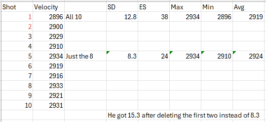

Did you math this out by hand to check, before we jump to ghost in the machine firmware land?
Ok, real quick calculation using an online calculator (haven't had time to do it by hand):
Using Sample SD, those last 8 rounds come to SD=8.8
Using Population SD, then SD=8.3
This is more like what you would expect just looking at the raw numbers, and the SD went down as expected when shrinking the ES by over 30%, not UP, like it did on the unit.
The ES for ALL 10 was 38, and the SD 12.8. Since the last eight rounds from the new lot were considerably faster than the first two from the old lot, I wanted to find out what the numbers were for just the new lot, so I deleted the first two shots and checked the Session Summary. My ES went way down from 38 to 24. BUT, my SD jumped up from 12.8 to 15.3.

Did you see the actual numbers I posted above when re-calculated?
I did, and I just explained how the changes you described are possible. The only way to know is to do the actual calculations by hand, with all of the original data. Which is why I asked if you did so.
So you don’t think the calculator is correct? Maybe so, but I’ve never seen an SD that is more than half the difference between the lowest and highest. I’m not a mathematician, but I do shoot three times a week over this unit and have never seen anything like that before. We shrunk the ES by about 35%, and the population by only 20%. I’m just not sure you can actually get an SD of 15.3 from an ES of 24 no matter how you distribute the velocities, even in a worst-case scenario, assuming we are using realistic velocity values on the order that would come from a typical rifle (around 2900).
For reference, here are the actual numbers:

The first two shots (in red text) were the ones from the old lot and the Avg MV on that load was around 2898. The remaining eight (shots 3-10) were from the new lot, and clearly averaging above 2898, so I deleted the first two to find out what the numbers on just those eight from the new lot looked like.
I can't see any way you can torture those eight numbers to come up with an SD of 15.3, and I don't doubt the validity of the online calculator I used, but maybe it's wrong. I will see what the manual calculation comes up with (after I go back and try to figure it out - I haven't calculated an SD by hand since Statistics in college, and that was decades ago!). But it will be tonight at the earliest before I have a chance to do so.

Yep, in Excel using SD sample I get a 13.5 SD for total then 8.8 SD with the two slow shots from prior jug deleted from the data set.
Garmin just fucked it up.

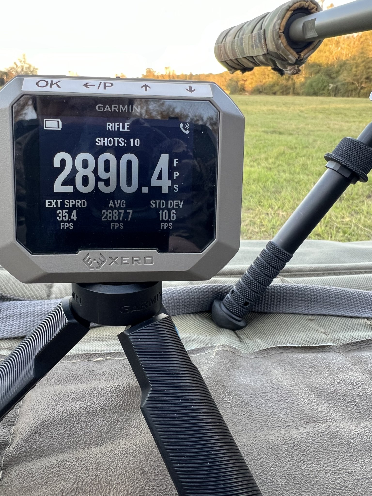

I did it again today. I shot 10 rounds of an exact-same load, then 5 more that were processed slightly differently. I kept them all on the same string and then went back and deleted the last 5, and compared it to the numbers I got when it was just 10.
First 10:
After 15:
Then I deleted the last 5 to get back to the original first 10 again. Watch the SD compared to the same 10 the first time:
Also curious, the AVG didn’t change by even a single tenth of a fps between 10 shots and 15. I haven’t done the math by hand yet. It may work out like that, but that’s very uncommon.

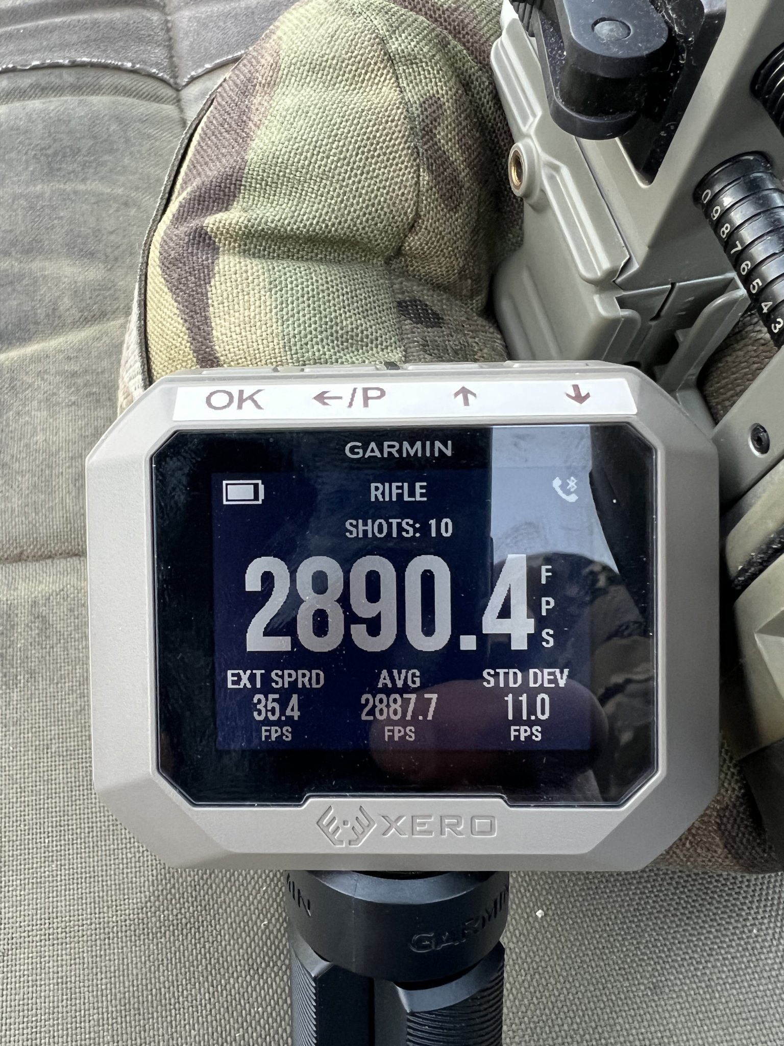

First 10:
After 15:
Then deleted the last 5 to get back to the first 10 again. (Watch the SD):

The variation shown in the pictures above is very small. If you are fretting and losing sleep over this I would suggest you sell the Garmin and move on.
No sir, that's not the point. The Garmin is the best unit out there, but it has some glitches. If we identify them and report them, others will know what to watch for. If you are fretting over a thread you don't even care about, then I would suggest you don't have to read the thread. If you read the OP, the first time this happened the the unit gave an SD of 15.3 when it should have been 8.3. That is NOT small. It's nearly double, and for me 8.3 is ok for a working load, but 15.3 is not. This one is much smaller (inconsequential to me), but @spife7980 asked for people to post other examples and this one is the next time I saw it happen.
So the POINT of this thread is this:
Currently the Garmin does not allow you to come back to a session after you leave it. If you have some reason to run some rounds over it that, for whatever reason don't really belong with the rest of the data (buddy wants to shoot a few while your gun is cooling, just to get an idea of his MV, etc), the work-around for not being able to start a new session without permanently closing the current one is to record the extra shots in the open session, and then just delete those shots and get the numbers on only the ones that belong in the session. However I've seen on several occasions that this will cause an error in the final calculation (sometimes small, sometimes huge) vs. if you hadn't included, then deleted those extra shots. So if I know this, and report it to other users, they can avoid that by realizing it may create a false answer. Also, Garmin may not know it either, and might be able to fix it on a future update.
No one can prove or disprove any math without the actual data.
Yeah, but both can't be "right" (even though they're pretty close to each other). It's the exact same data in both calculations. This one is tiny, but it still gave a different answer with the same 10 shots. I'm just posting it because you asked for more cases.
