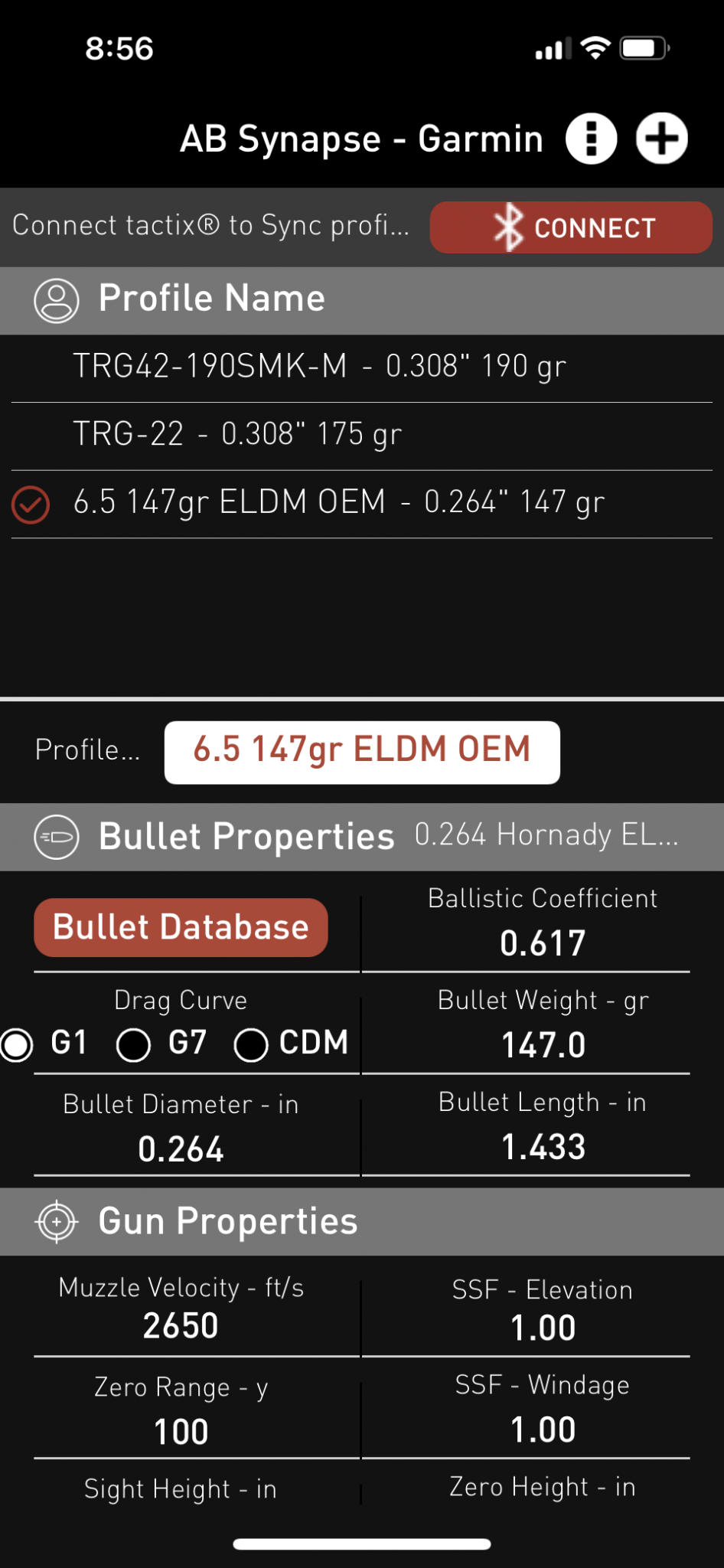

    I’m setting up my rifles using AB synapse to send rifle and bullet information over to my Garmin tactix delta.
    When I select a Hornady 147 grain ELDM, The information in the bullet table doesn’t match the information available in Hornady‘s website.
    For example, the G1 BC shows up as .633 vs .697 thats on the box.
    There is also some confusion for me in that the OAL of the bullet is not readily found online. I literally cannot find it in the bullet information page on Hornetty‘s website.
    When I measure the OAL of a 147gr ELDM from stock, it’s 1.462 inches as opposed to 1.433 from AB.
    Anyone got some thoughts on this?
    Odd, AB Mobile shows the same 1.433" but .617 G1 for me, Strelok shows the .697 number and 1.43", Genesis is .697 and 1.44".
    Wonder if AB's BC is a typo or one of the ones they actually tested that usually say (Litz) in other libraries.
    Regarding the length, perhaps you have a new version?

    @GBMaryland
    I believe that the G1/G7 values used by AB are measured on their Doppler system. That is why they typically do not match the values used by the manufactuer
