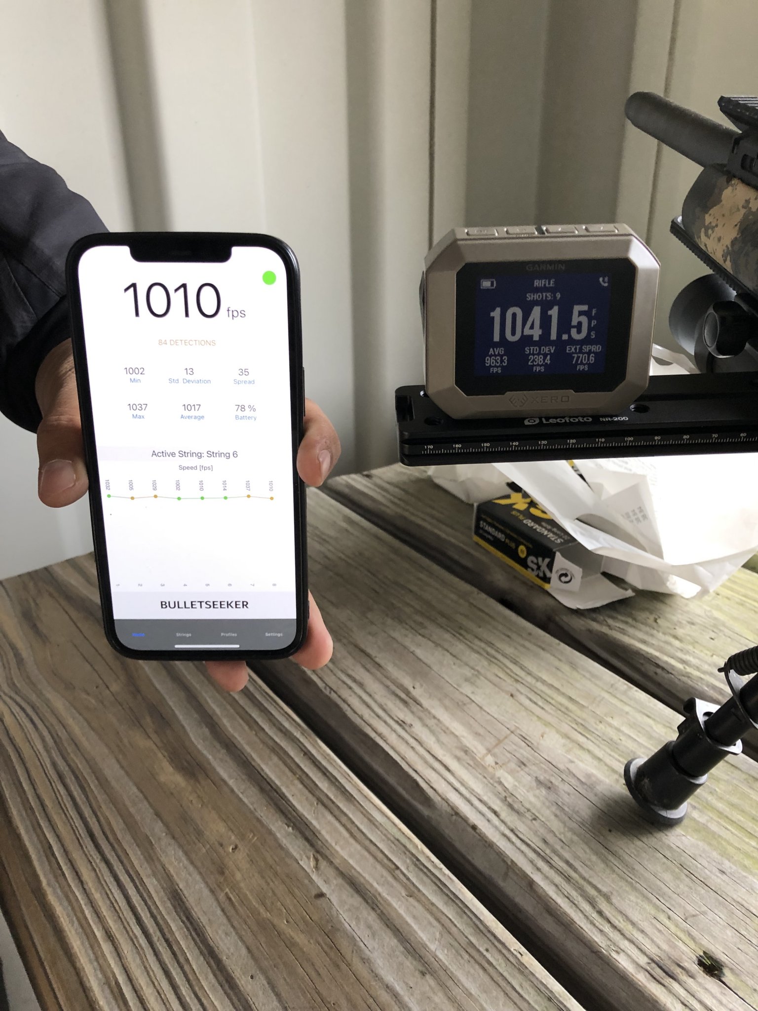

I was at an event and someone just got their Garmin Xero. I brought my BulletSeeker so we compared them. We mounted the BulletSeeker and Garmin onto my friend’s CZ .22lr. I was shooting SK Standard Plus.
According to my friend, his rifle with that ammo should be around 1040 fps. He uses a MagnetoSpeed V3.
Not sure why there is a discrepancy. I’m am not happy with the BulletSeeker.
The xero has a 776 fps es. That’s pretty large. It would have had to pick up something in the 300 fps range on one of the shots…. Delete that shot and compare if possible. Otherwise, can’t compare very well….

Yep, something's wonky. The Garmin is showing a triple-digit SD. Good eye.
SD/ES doesn't matter here... I think he's just comparing the same shot between the 2 chronos and asking why the large discrepancy.
How does it not matter? There's 6 (or 9) shots in the string. If you think there's a large discrepancy in this shot, I can guarantee you there's a MUCH larger discrepancy somewhere else in the string. The Garmin is all over the place with an ES of 770 vs 35 on the BS. With that kind of data, why would you believe the Garmin over the BS on any given shot? As I said, something is wonky here. I haven't experienced this kind of issue with the Garmin.
Just a hunch but probably because the Garmin was being used for another rifle/ammo prior to the test. I'd imagine they just put it on for the one round without resetting the string to compare directly with the BS.
The average speed of the entire 9 shot string on the Garmin was 963fps WITH the 1041 reading... not too difficult to see what happened here.
