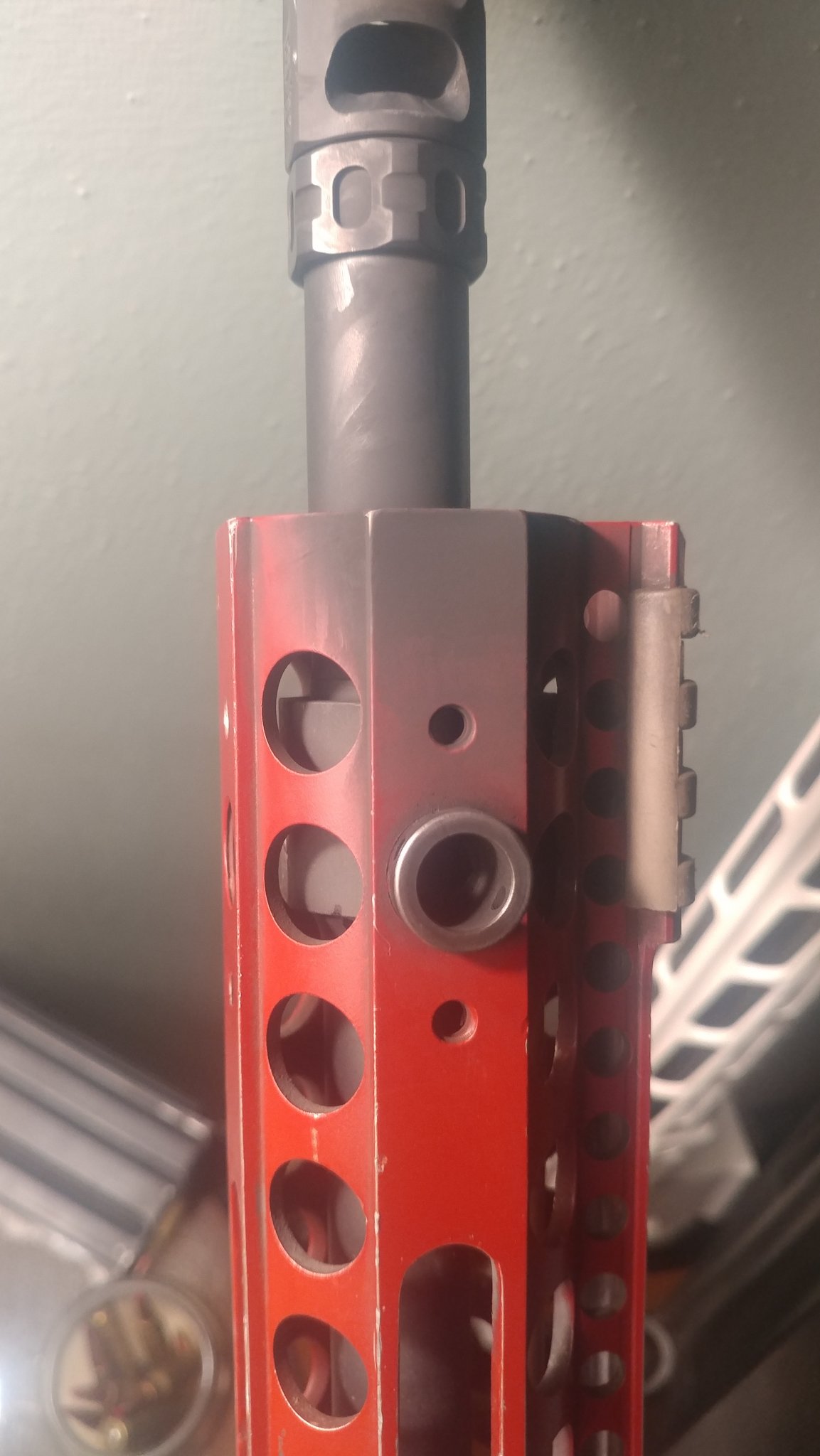

Also with a rifle length gas system and a 15” hand guard your gas block will be exposed. I have a seekins adjustable block I would part with if you are interested in this setup. No pressure, it’s just collecting dust in my shop.
I’m pretty sure it’s .875 but I’d have to double check.
Also with a rifle length gas system and a 15” hand guard your gas block will be exposed. .
Not quite. Rifle gas with 14.5" HG pic for reference.
