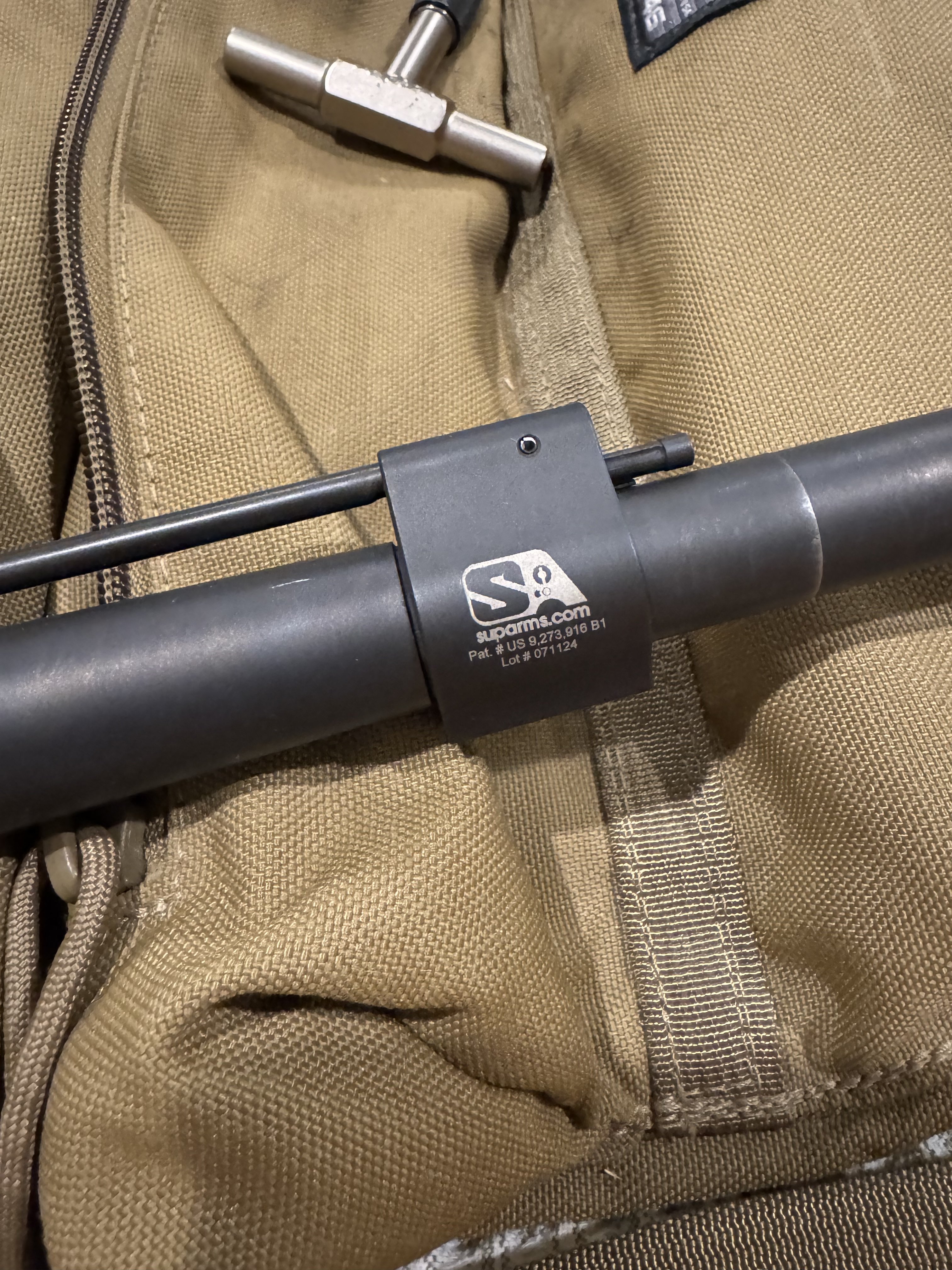

Put together a new .308 gas gun a few weeks ago and I'm having a hell of a time getting the gas system running. Thought I'd see if anyone here has faced a similar issue. The components are as follows:
LaRue 16" Midlength Barrel
Superlative Arms Adjustable Gas Block
Melonited Mid-Length Gas Tube
I've assembled a lot of gas guns over the years and have never had this much trouble with a gas system. I installed everything and test fired only to seemingly get no gas to the bolt. So, I disassembled and the reassembled with the same result. I'm wondering if it is an issue with the gas block or gas tube. I have a new gas tube coming to see if that fixes things. I used the spaghetti trick to make sure the gas hole is lined up with the gas block.
This is the first time I've tried a SA adjustable block, so I'm not sure if there is a defect with the gas block. I set it up per the instructions, but I don't know if I might also be doing something wrong. I guess I can replace the gas block with a standard one as well to make sure it's not a barrel or bolt issue.
Anyone have suggestions or other obvious things I might be missing?

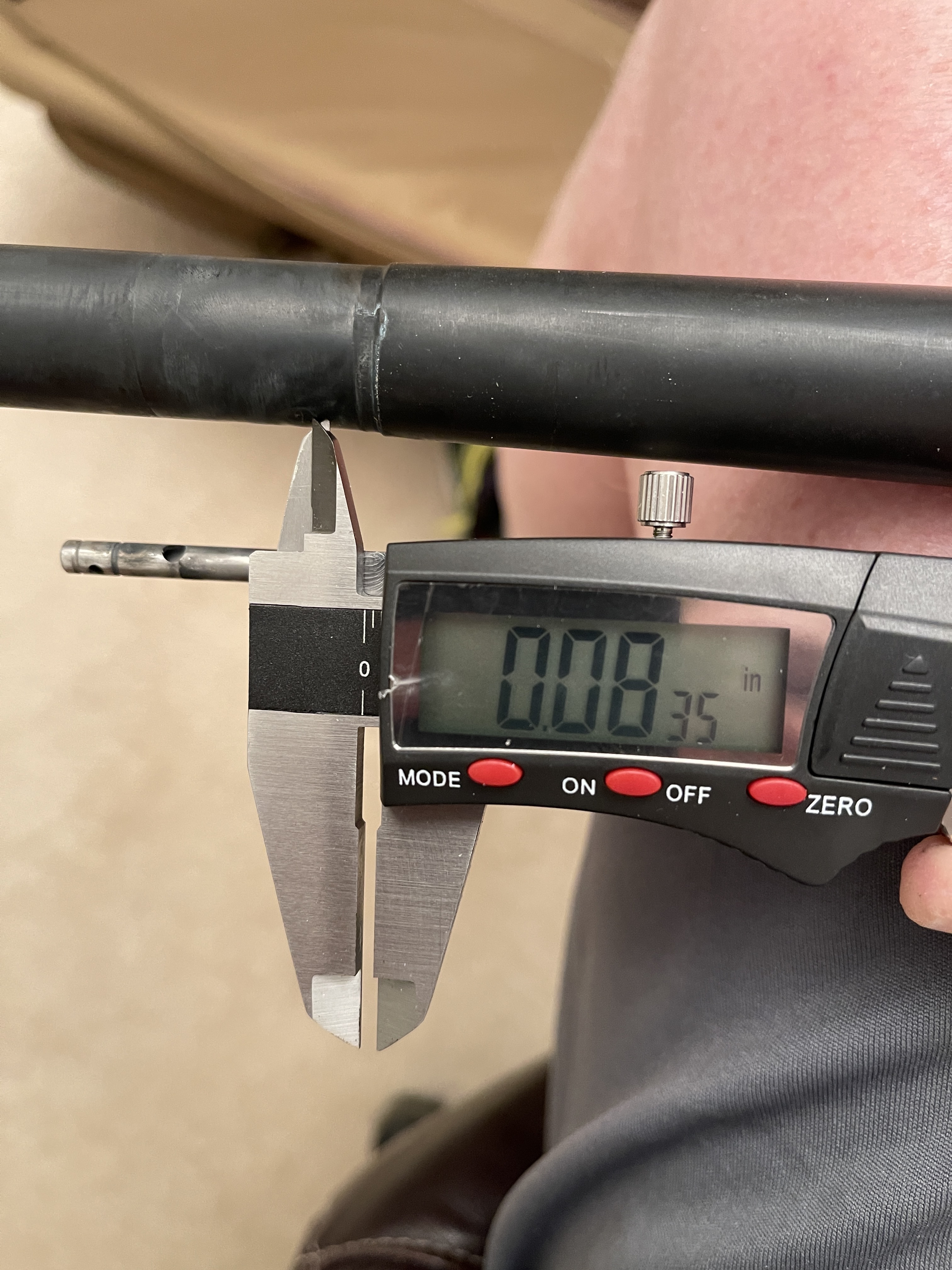

First step I would take is to measure the gas-port size for your .308 gas gun using calipers. My 18" .308 required a drill-out of the gas port because it wasn't getting enough gas to push the BCG back to cycle the rifle. Pre-drill out gas port size picture attached for clarity...
Once you have the measurement, post here and you'll get plenty of 411 from the learned members here! :)

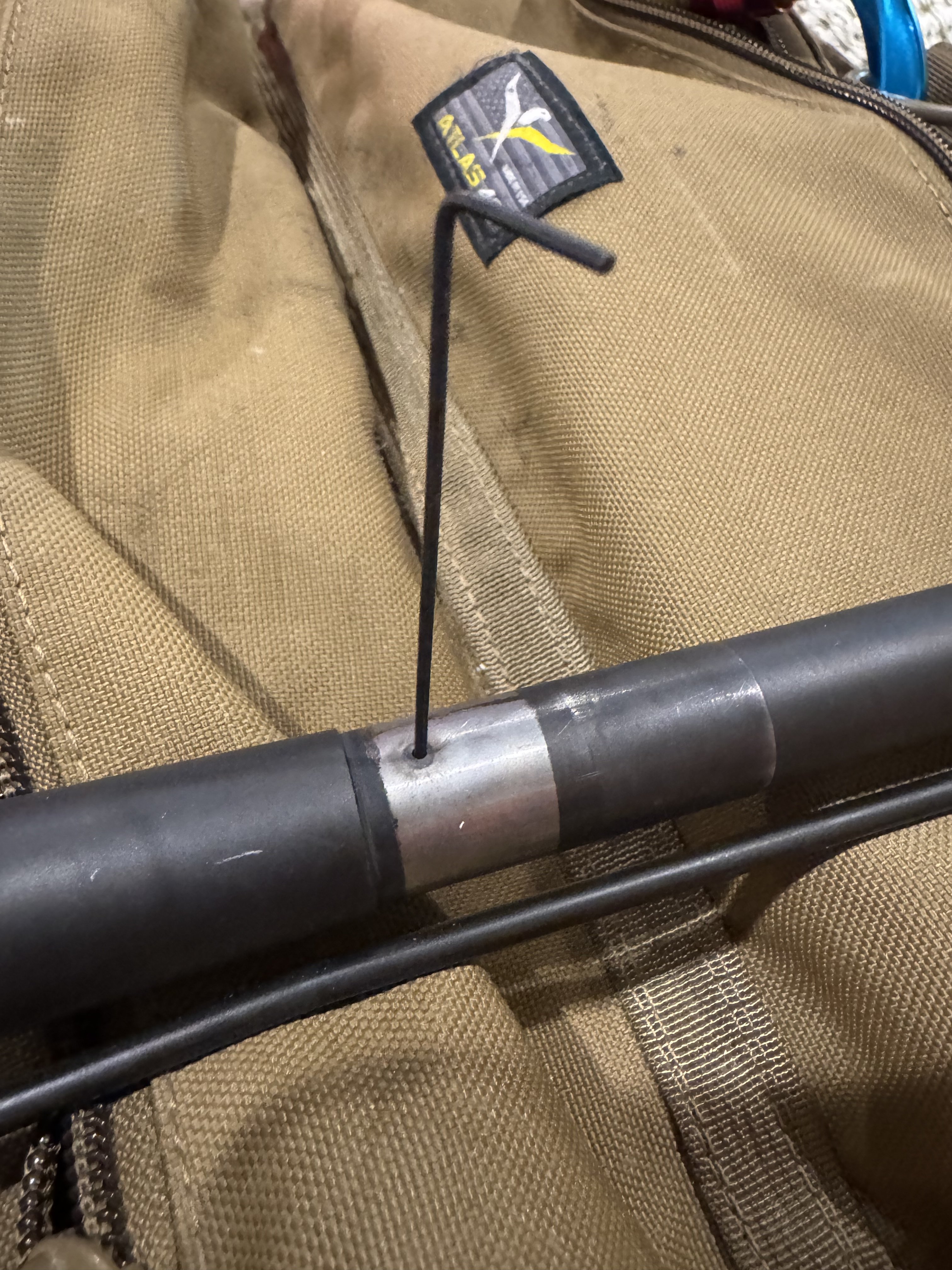

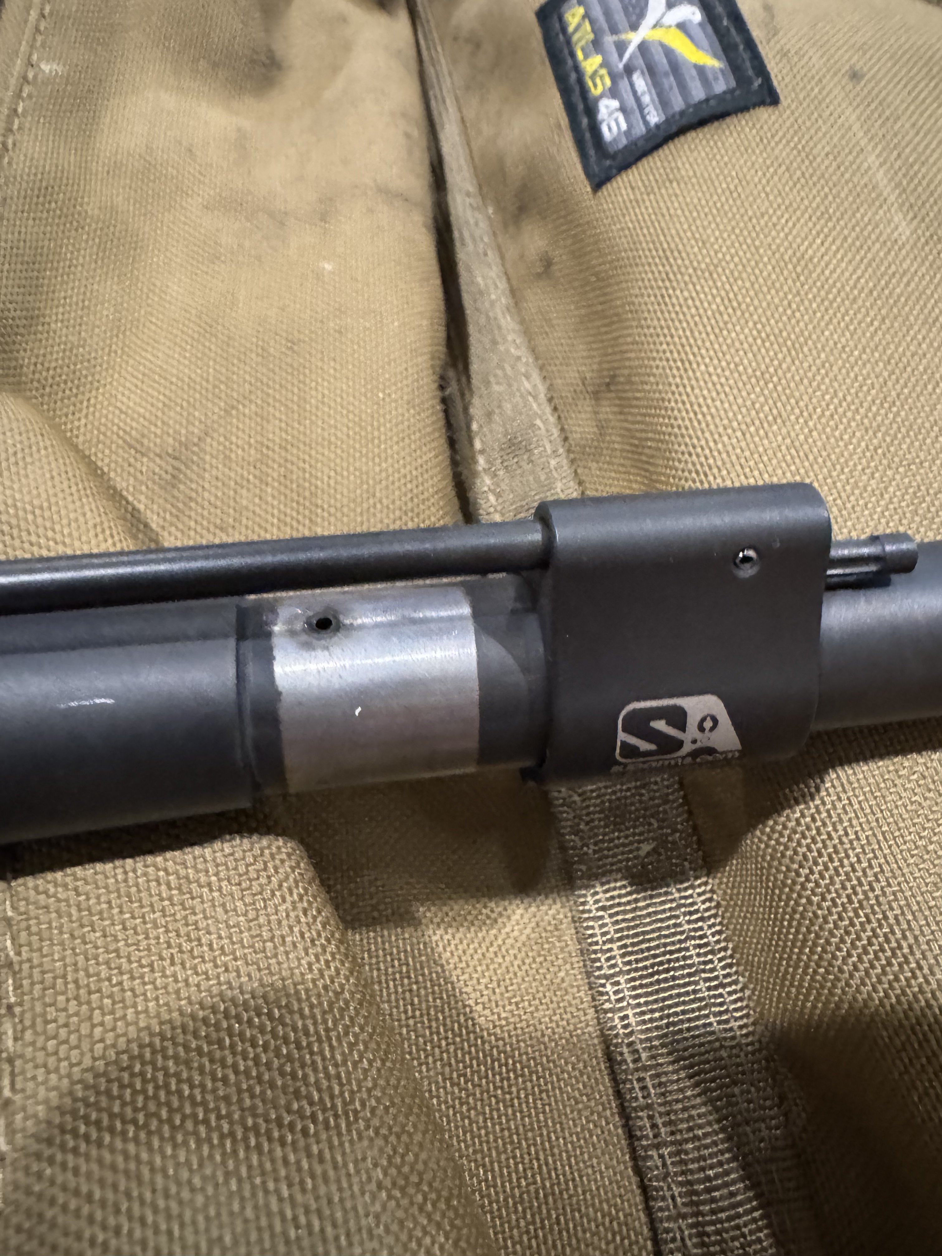

Ok, pics attached. To answer questions:
Gas hole in barrel fits a .050 allen wrench, but not a .0625. A quick search makes me think the port needs to be enlarged to work. The first few links I clicked said it should be .0625 minimum.

Must have gotten one of the barrels mark made on a Friday. A sub .0625 sized gas port? Thats some QC for ya.
Return the barrel as defective for a refund and buy a craddock.
A hex wrench isn’t exactly a precision measuring instrument. And as they are measured from flat to flat, the size of the wrench isn’t giving a true numerical value for the port diameter.
I realize that it’s not the most precise measurement, but I think it clearly shows that it is smaller than .0625. Whether that matters or not, I don’t know. LaRue finally emailed me back and said that’s in spec. All the reading I’ve done says that less than .0625 is too small, so who knows. 🤷‍♂️
I asked LaRue what the exact correct size is and told them I’ll go to McMaster and get pin gauges to check. That was yesterday and no response yet.

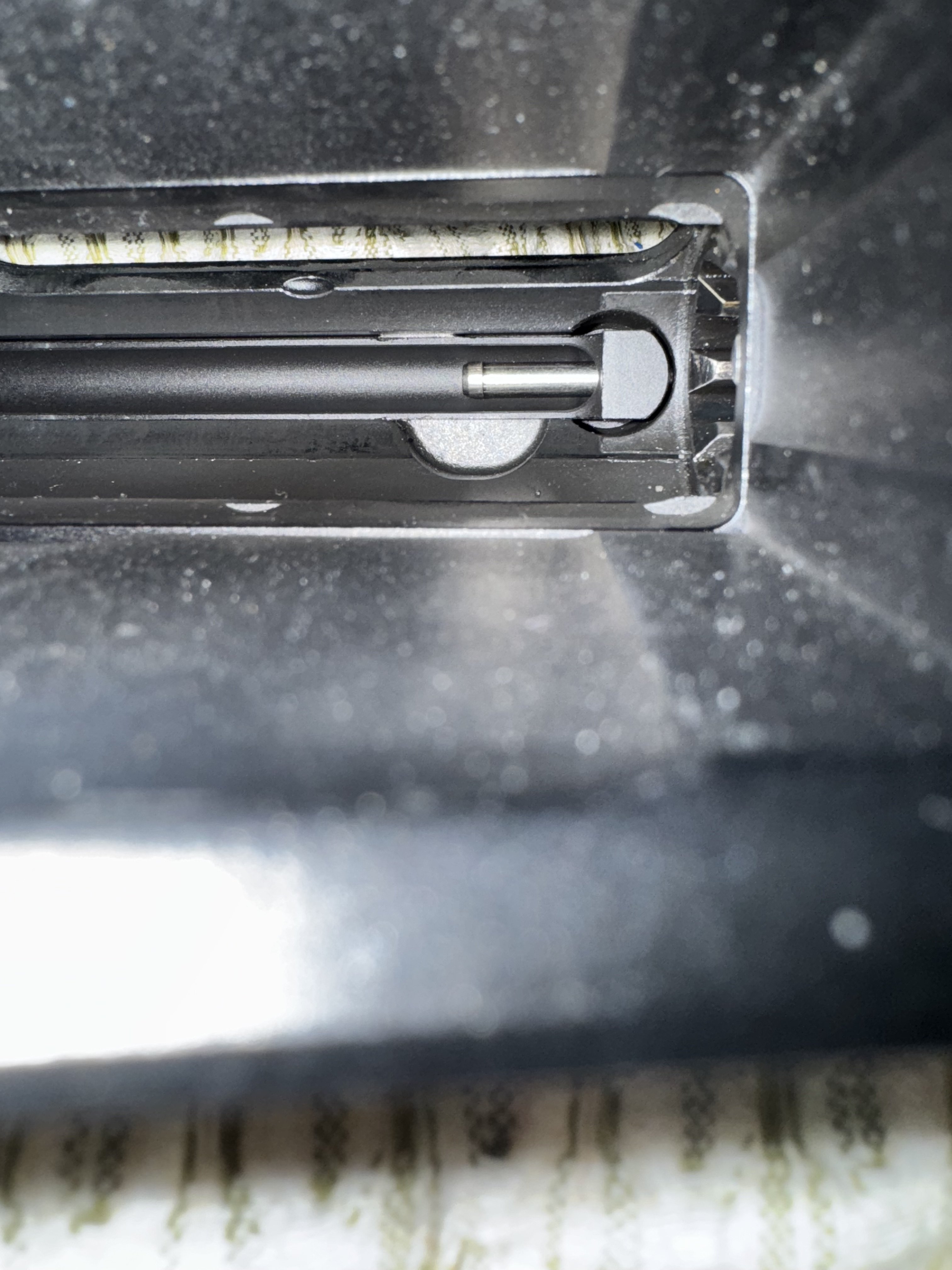

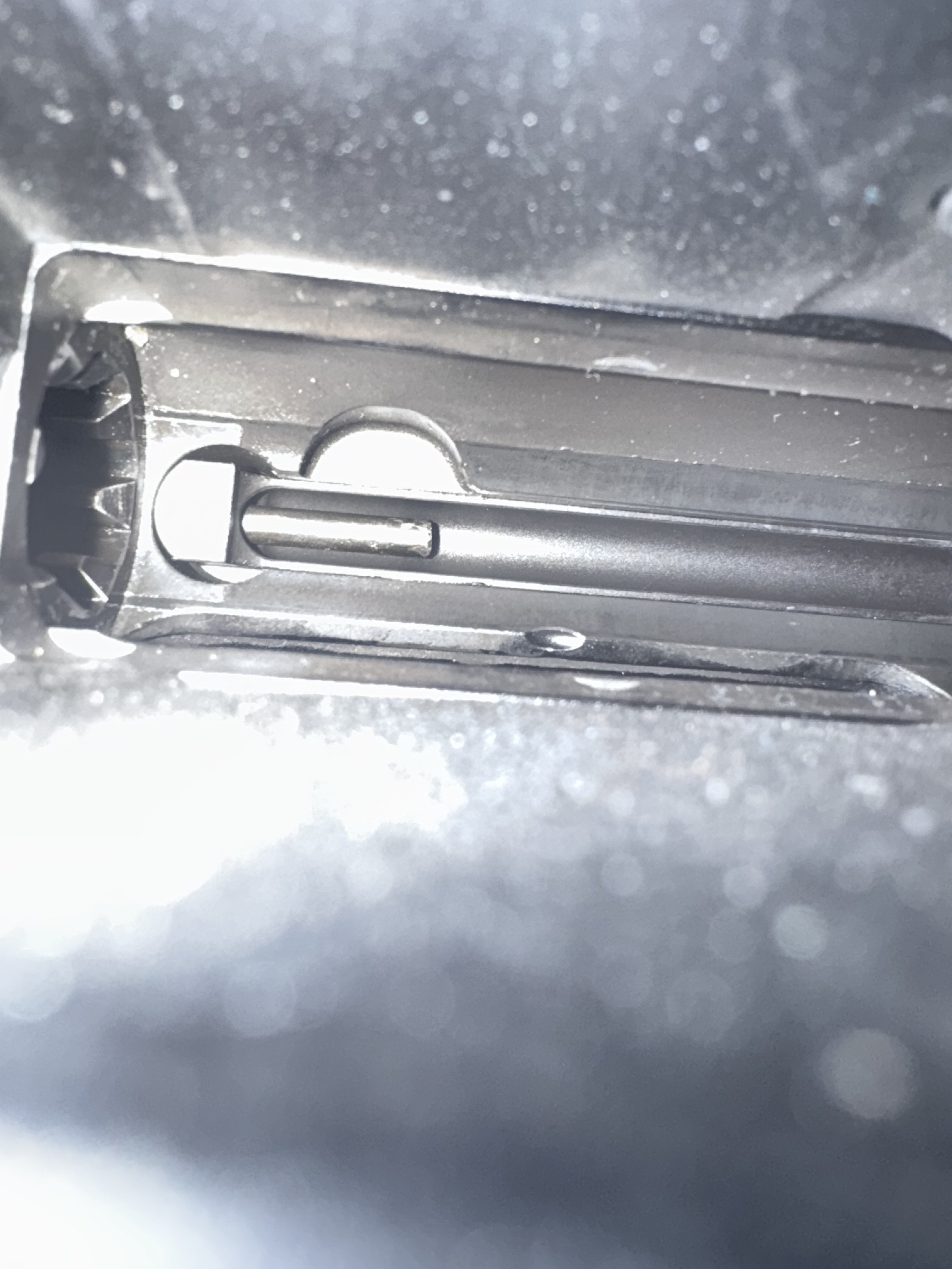

Couple things I see right off the bat is that gas tube is sticking pretty far out. Make sure your bolt carrier isn't sticking on it. And also make sure that end of the gas tube isn't peened over or have any burrs around the opening. The second is the cerekote/paint on the gas block journal up by the shoulder. That is not allowing the gas block to get a good seal against the barrel. As posted by everyone above, start looking over the fit and function of everything else from the bolt to the buffer as well. I would guess you have a combo of small issues rather than one main cause. Even with the port being barely in tolerance, it would still cycle the bolt far enough to extract a fired case, may/may not pick up the next round, but it should at least extract unless there are other issues.
Yes, that tube is too long. You'll never know if that's really part of the problem until you get it corrected. Usually they're too short. Either way, it messes with the timing.
Your gas tube appears (to me) to be too long. The tube should sit right in the middle for optimal performance. Will it work there...yeah, but not optimally (IMO).
I have a new gas tube on order, but I think I’ll cut this one down a bit and see if that helps.

Harbor freight numbered drill bit kit. Use shafts as pin gauges. You only want to increase .002” at a time. Trial & error determines if more needed.

I replaced the gas tube and just stripped down the bolt to get it completely cleaned up and relubed. There is air getting through everywhere it is supposed to. I also confirmed the bolt carrier/gas key move freely and without any binding on the gas tube per @mtrmn recommendation.

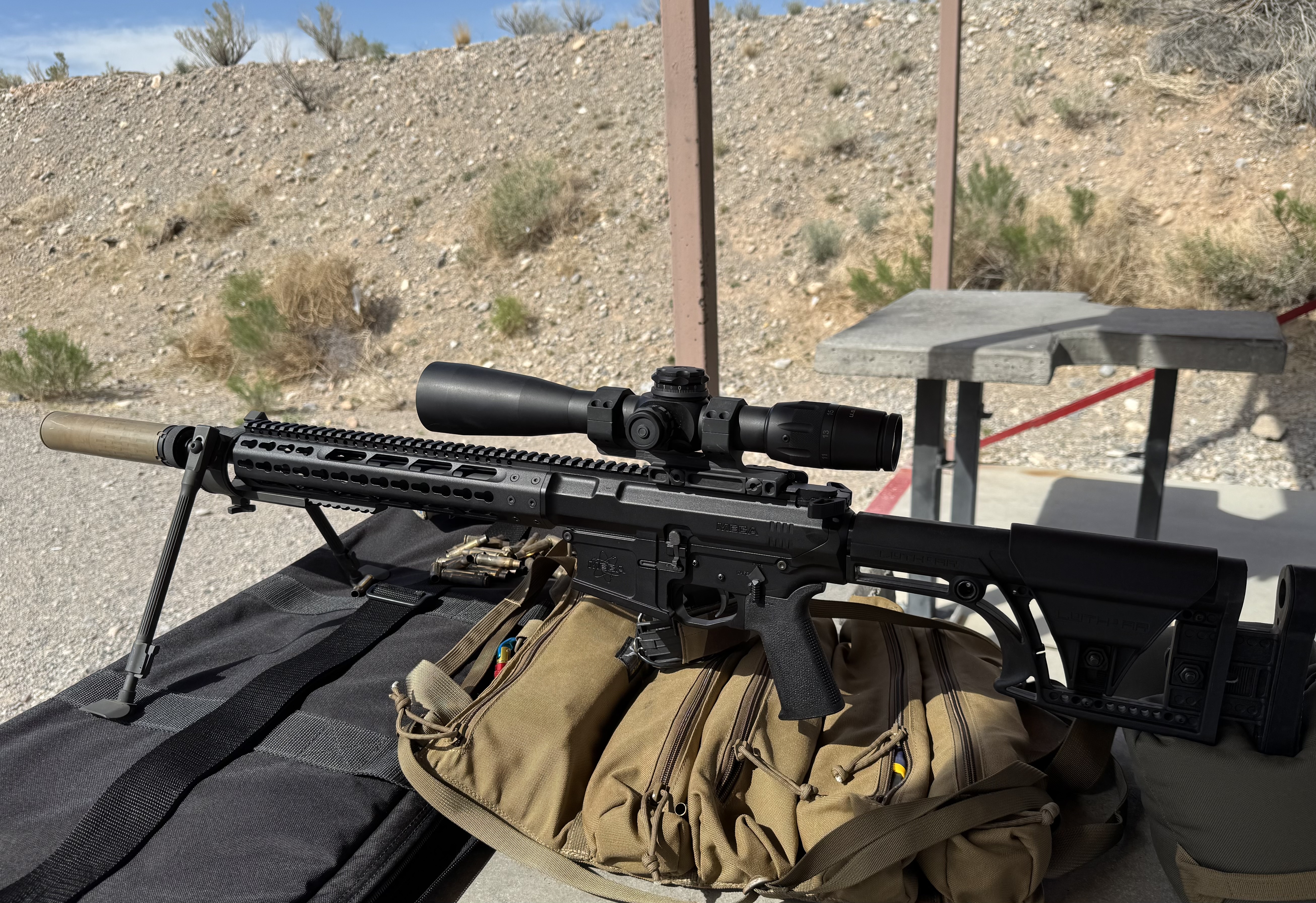

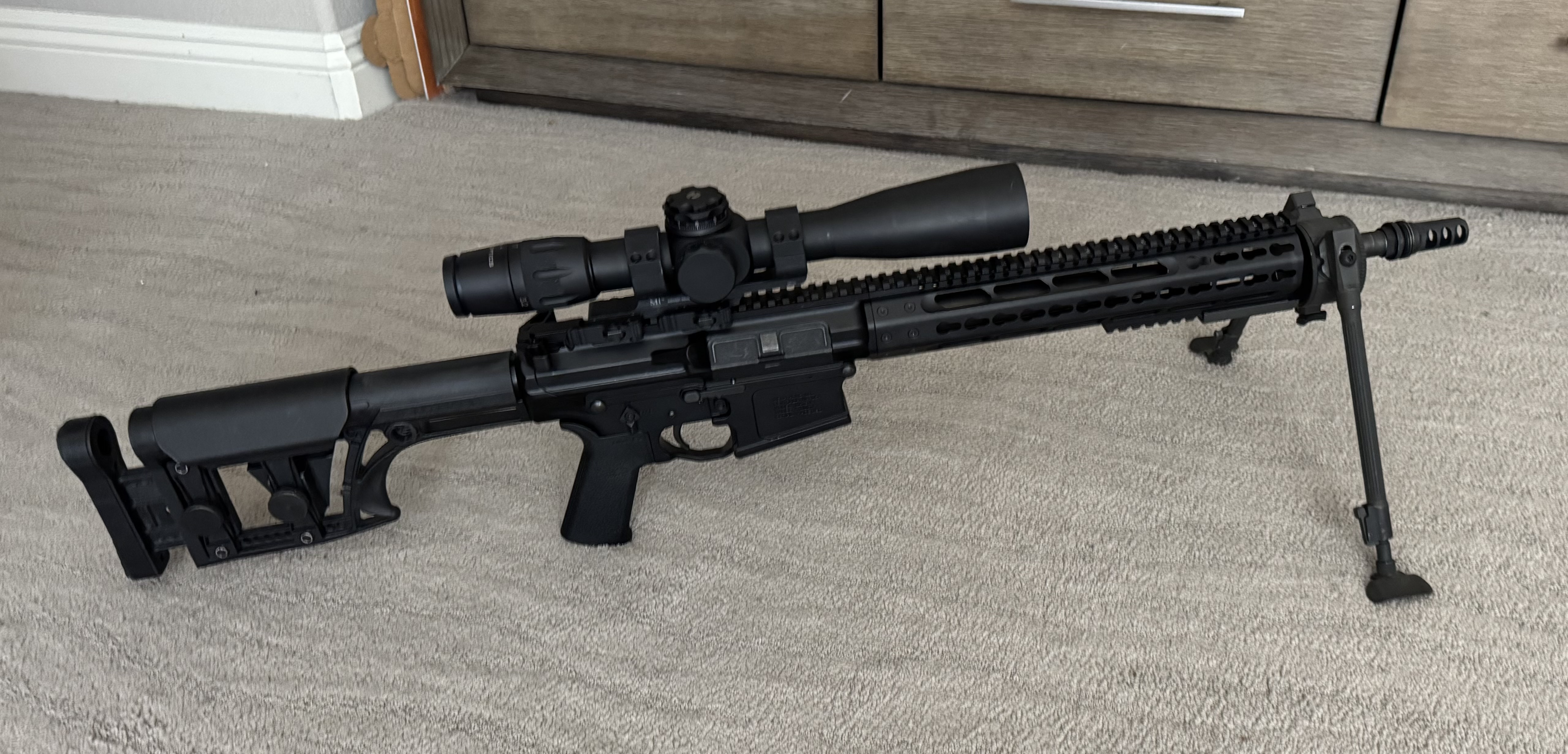

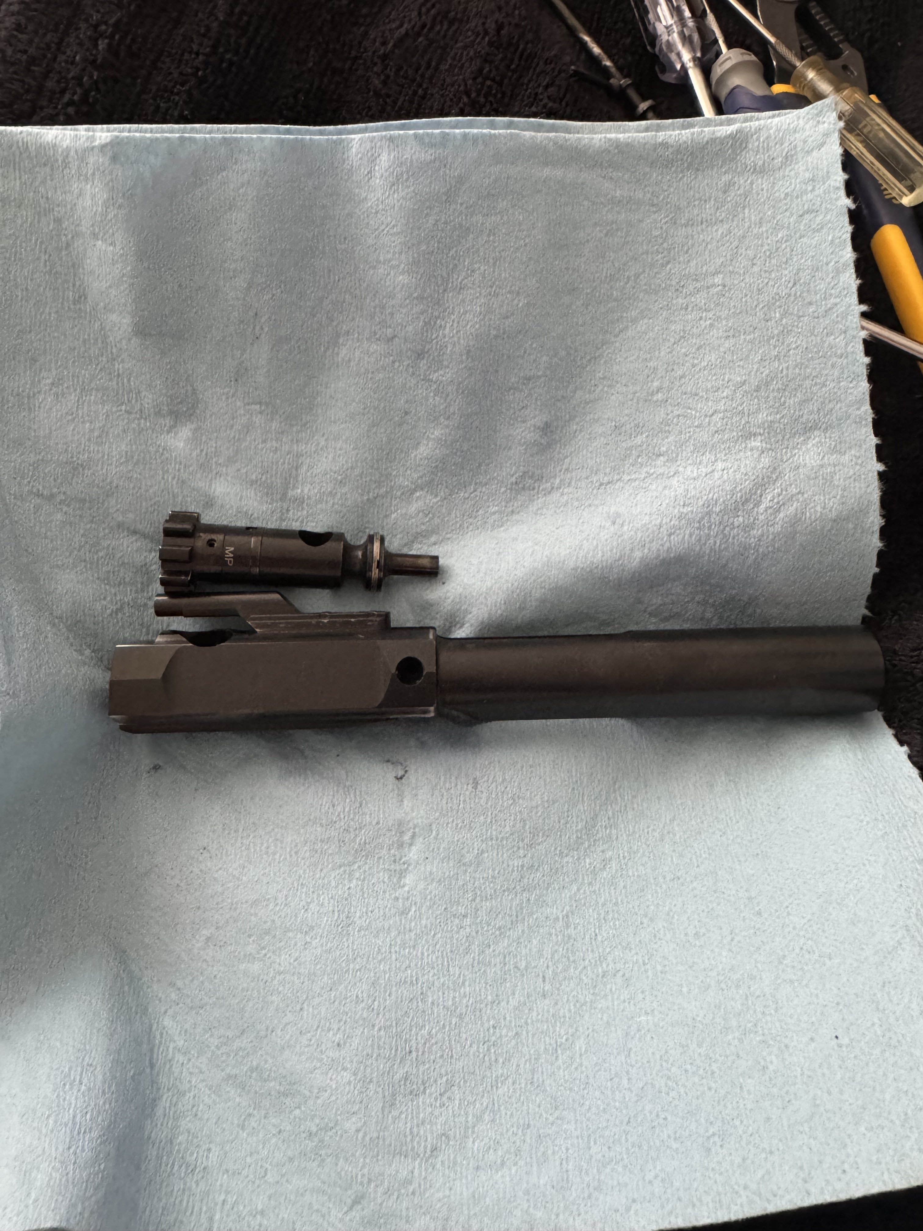

Here a picture of the bolt and carrier. And the rifle ready for testing!
Step out the back door and test fire it!
