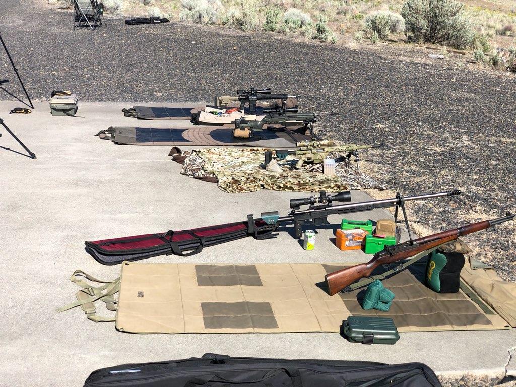

Shush! I love the look of the M14. My budget doesn't, but I do...
Second from the back
NM build with kreiger barrel.
