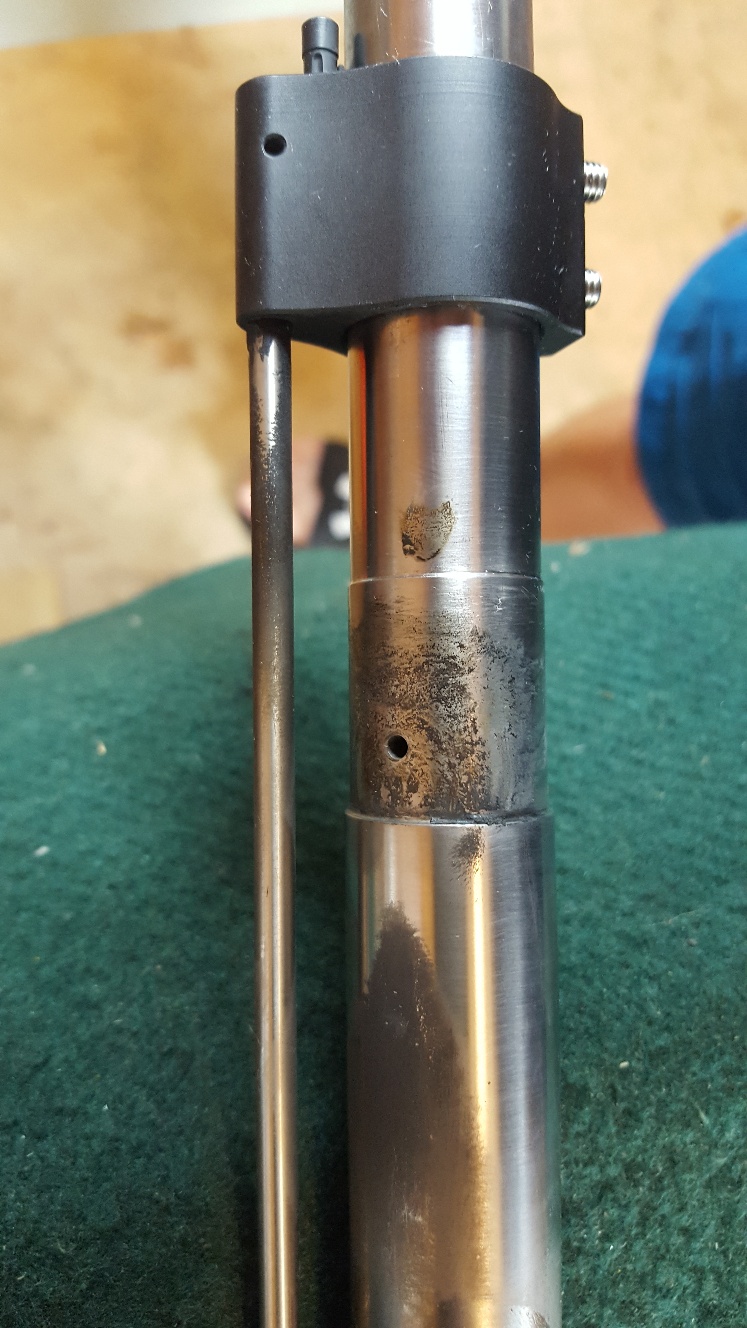

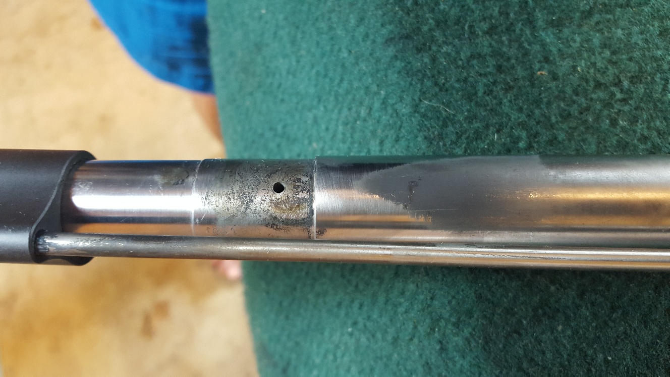

some phone pics attached if that helps anyone see what may be going on.

in the pics you can see a bunch of carbon aft of the block on the barrel and tube so not sure if that indicates a loose or sloppy fit. i snaked the tube all the way to the block and no blockage, snaked the gas key to inside the carrier and no blockage, and the gas port in the barrel has no blockage.

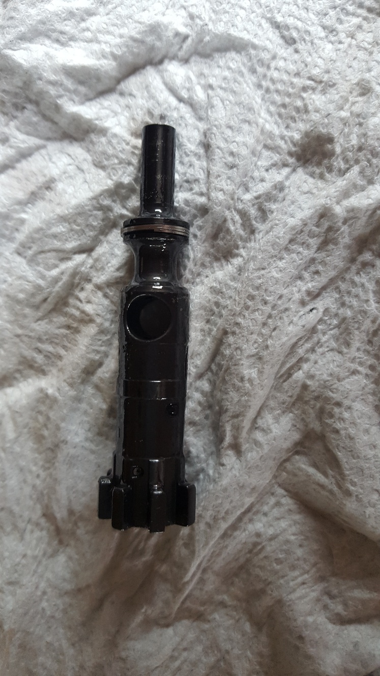

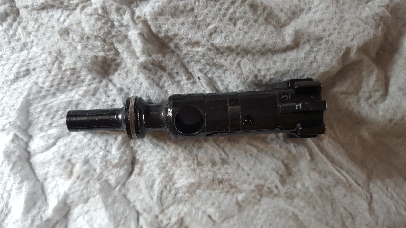

based on above, thinking it might be the gas rings on the bolt, but no idea how they (and/or the carrier inside) could have worn so incredibly fast.
yes they got back to me today. he was going over all the ejecting patterns and i'm like, it's not ejecting... basically said to turn it ccw from closed to full open (4.5 revs, 18 clicks iirc) and let him know what happens, and if it doesn't cycle it's not the block's fault. but he did say even if it doesn't seem to be the block, he'd help me troubleshoot.
The gas rings look funny. I've never seen a JP bolt or a 6.8 bolt so I donl't know if that is normal.

Looks like a JP one piece gas ring. So the bolt is it just clicking out of battery then back home when fired? Sounds like gas issue, my JP bolt I have here is loose in the carrier compared to my other 3 gas ring bolts. I've never used the gas block your using, does it normally blow that much gas out onto the barrel? My gas blocks don't leak that much on any of my ARs? Maybe the tube is messed up inside the block or split? Have you pulled it from the block?
I expanded the bolt picture, lots of lube.
I did not see any of the splits on the rings i was told to make sure they are staggered.

Looking at your photos I'd say you are in the bleed-off positions due to the flute showing on the adjustment screw. I would turn the adjustment screw all the way in and start unscrewing once you get reliable ejection and then turn it out one more click. If you want to keep it in bleed-off I'd screw the adjustment screw in 1-click at a time until you get it to cycle the leave it there. My guess is the AGB isn't properly aligned and the adjustment screw is on the edge of non-restrictive and bleed-off.
Read this article: https://www.pewpewtactical.com/superlative-arms-gas-block-review/
The fouling in front of the gas block looks like what you have on your barrel. This is the bleed-off working. Try setting it 4.5 full rotations from full closed. This will set the AGB to the maximum amount of gas. Now turn the adjustment screw in until it stops cycling then one click out for reliability.

I’m still wondering about the gas rings. Is that a different type ring set up? Also I see zero wear in the finish on the end of the bolt which makes me wonder if it’s out of spec too small or the carrier is out of spec too big?

they said this is the newest version of their rings, out a couple of years. when i mentioned it seems to run a 'little' better after the rings are freshly oiled, they sort of agreed that suggested some sort of ring clearance issue (whether rings too small or inside carrier too large), hence them sending me another bcg to try.

From looking at the pics, what is the contamination around the gas port ?
Shoot it without a handguard, wrap it with tissue, and see if you have a block to barrel leak.
