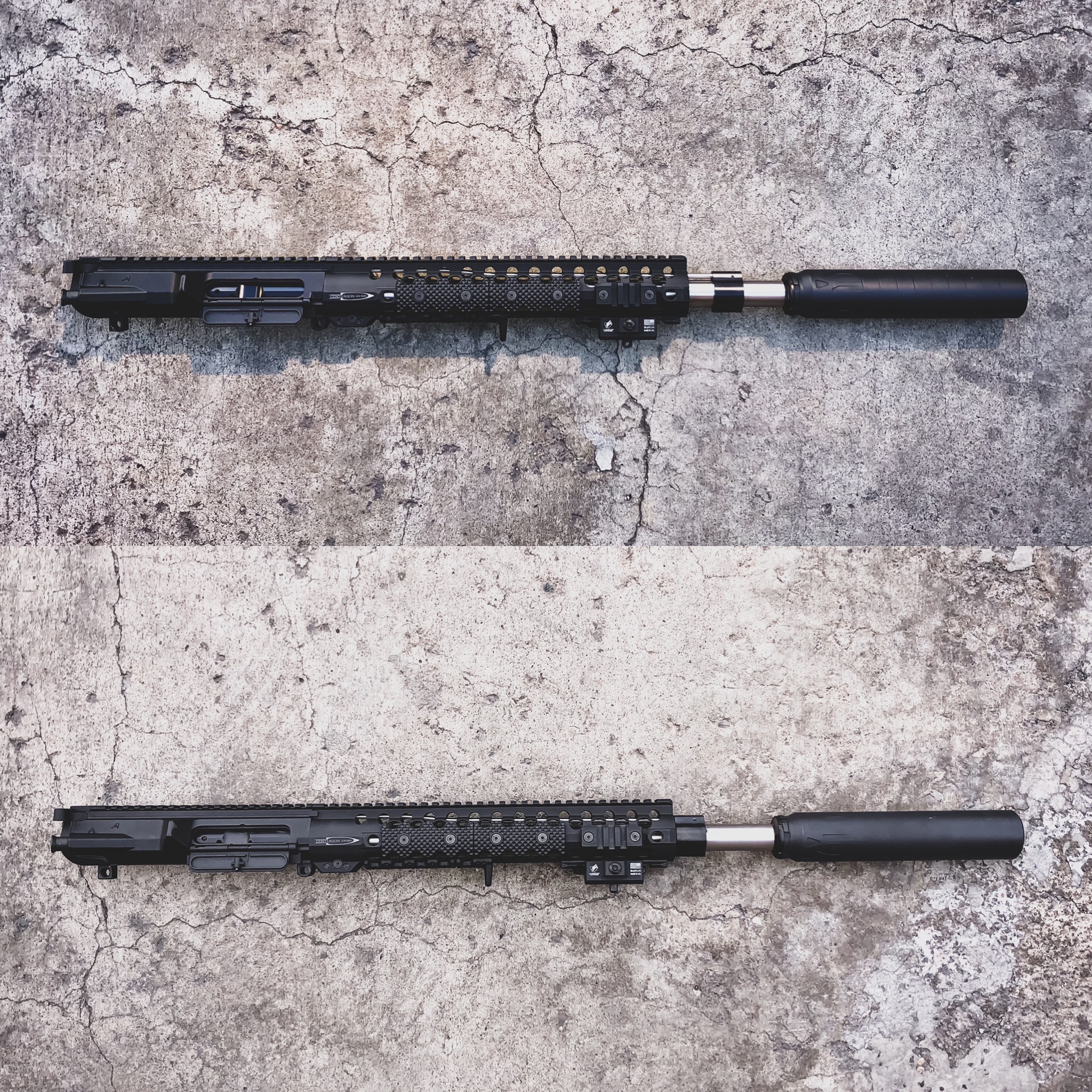

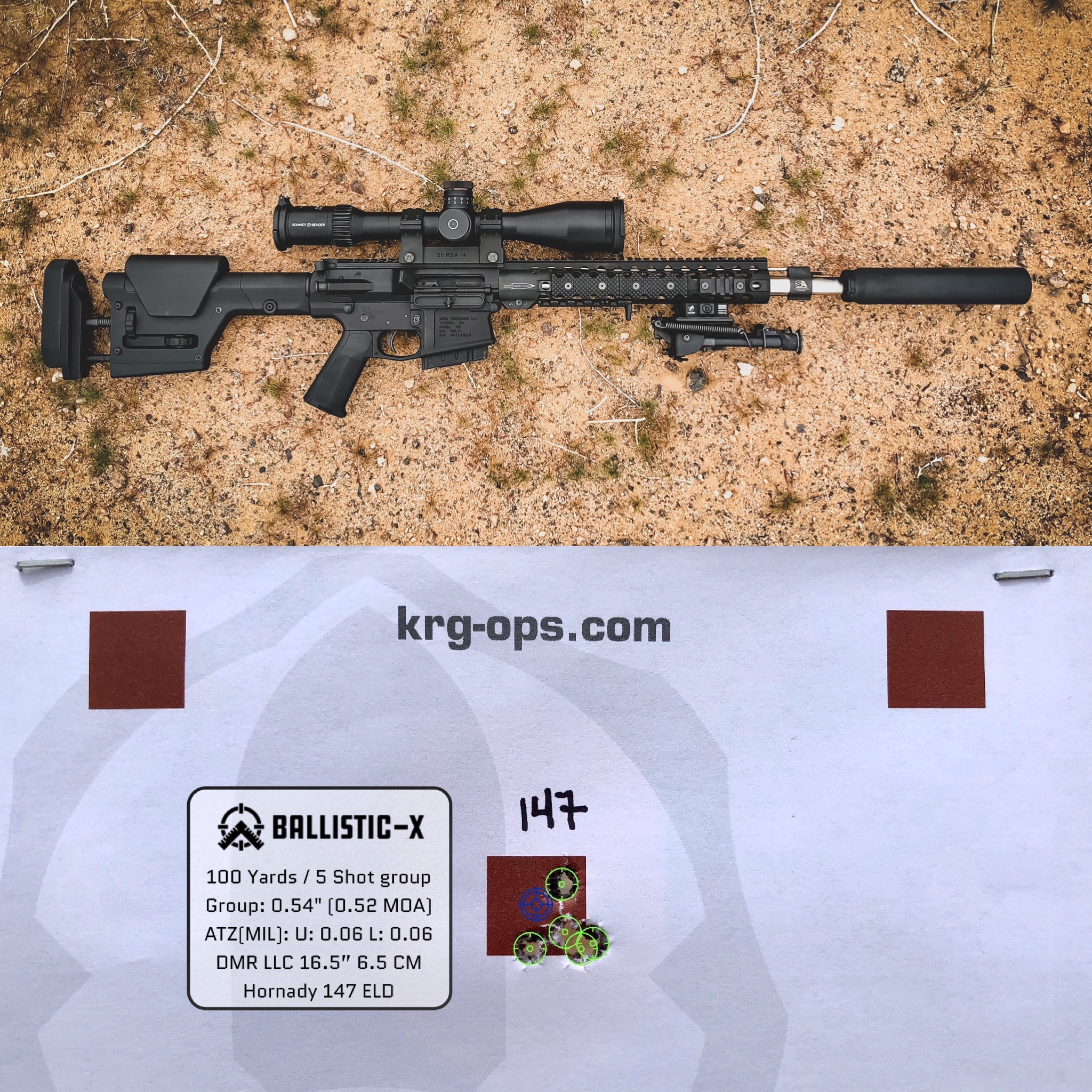

OK here ya go 16" 6.5 creedmoor ..on the market and available ....

Old thread I know. I did a 16.5” with a +1” gas system and am liking it so far. I will be doing another barrel and incorporating more refinements. I also did a rifle gas length barrel for comparison.
Reactions: Luke G
Whose barrels are you using if you don’t mind me asking? Looking for a rifle length 16 but having trouble finding many options. Looks like that one shoots well if that group is anywhere near what it averages.
I’m still shooting a variety of factory ammo to see what it likes. Hornady 147 and Winchester 140 have showed exceptional results. Hornady 140 did 0.8 MOA averaging four 5 round 100 yard groups. I want to shoot Federal 130 and a few others before doubling back.
Both barrels are Bartlein 5R’s that I chambered, ported, etc. I haven’t finalized my gas port diameter yet and am currently using an adjustable gas block. My “finalized” barrel will not utilize an adjustable gas block.
