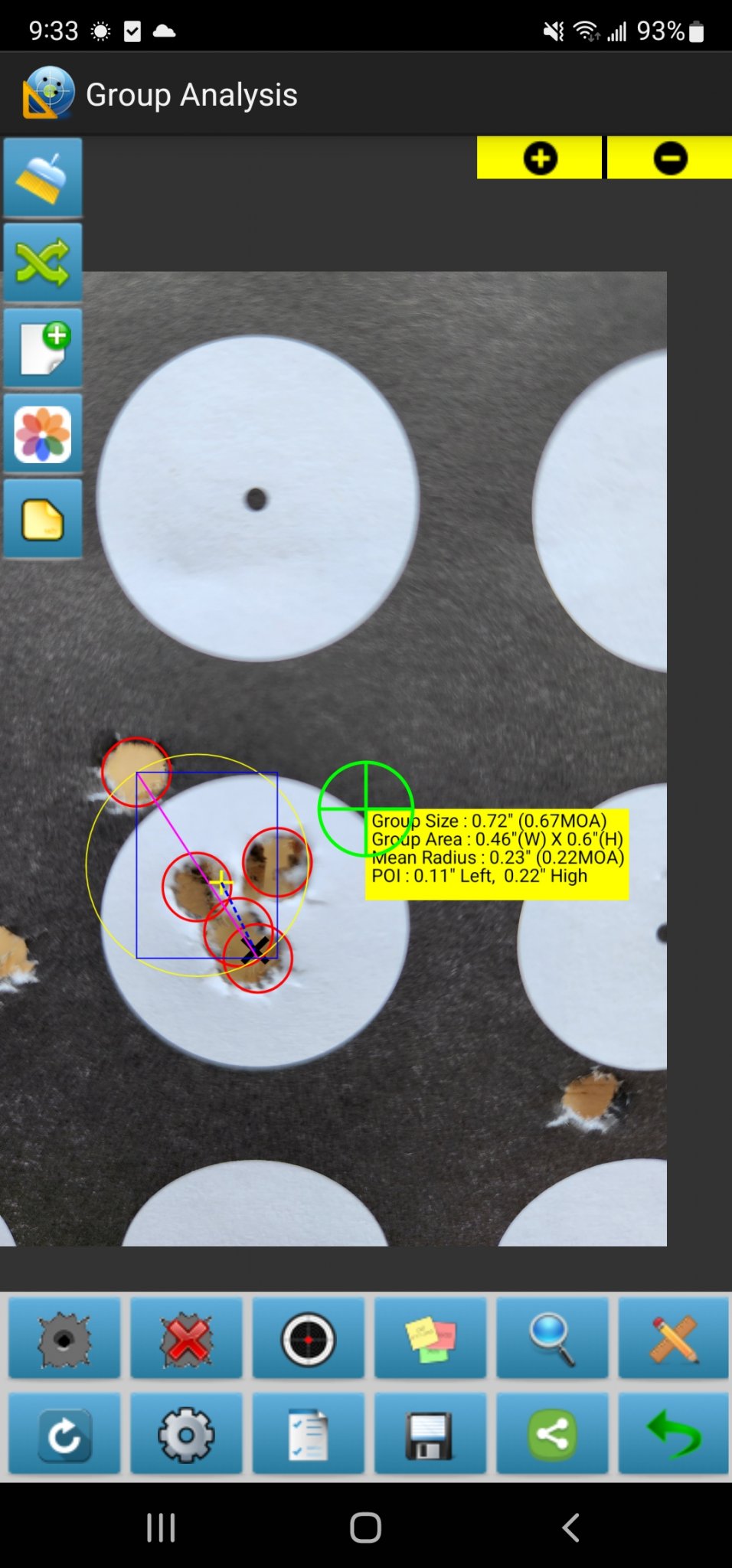

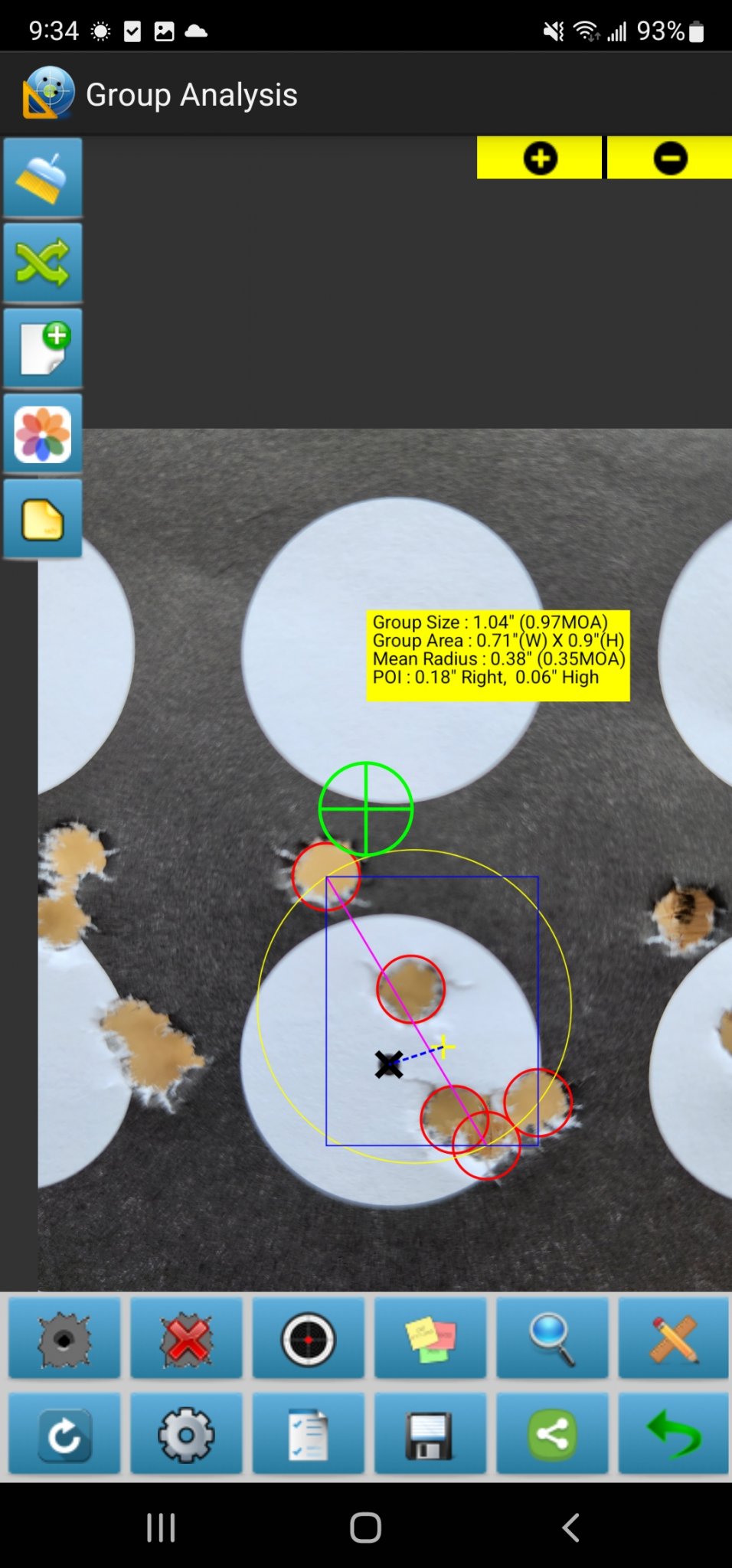

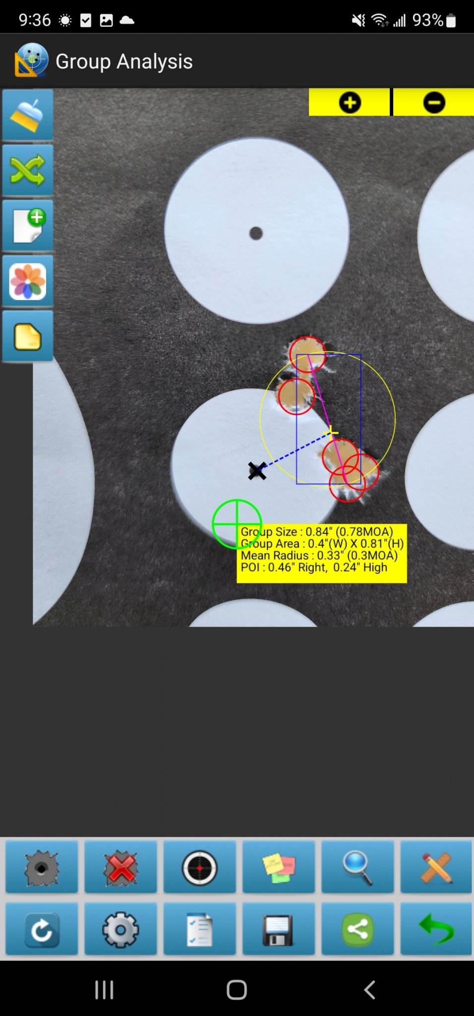

Here's a few groups out of my 12.5 (black hills 77 smk's)
