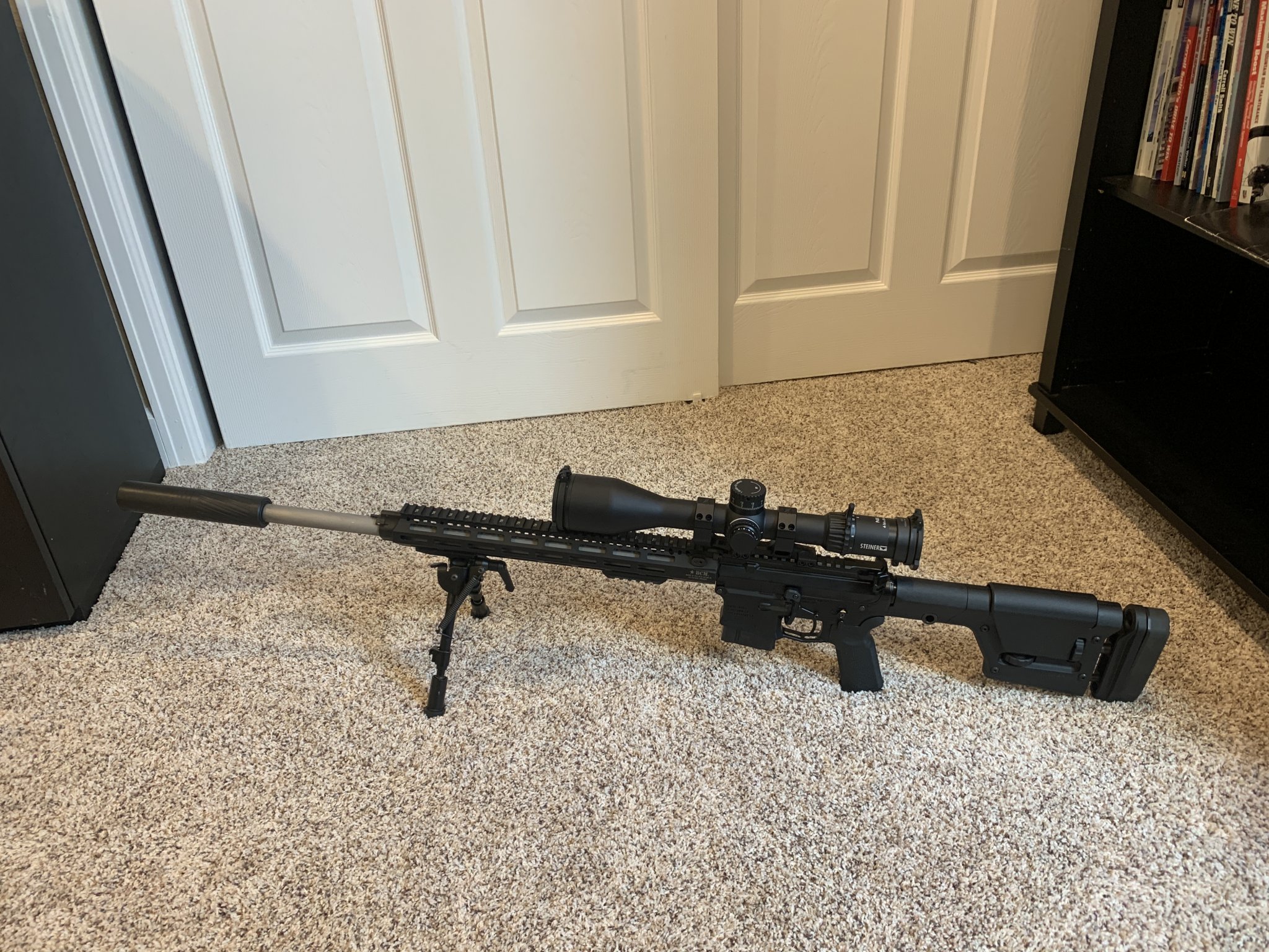

My opinions, and for the record my go to for everything but small bore is gas guns.
The average shooter will likely shoot a bolt gun better due to a number of factors. Good shooters will be able to shoot a semi as well as they can a bolt gun (this is me). Great shooters can shoot a bolt gun better than a gas gun because they can squeeze all the capabilities and consistently out of the bolt gun the gas gun can’t/doesn’t offer (this is my second daughter).
If you want to shoot really far getting bullets to go faster is going to be a lot easier out of a bolt gun. Also, loading hot is difficult due to magazine capacity restrictions on COAL and you’ll tear up the gun faster if you over charge it.
But, inside of 600 it’s going to take an above average shooter to outshoot me with my gasser and in all likelihood I can shoot a lot faster. All depends on the application and how much time you have.

I have a very accurate gas gun:
Craddock/Rock Creek 6.7T 224Valk
Other good parts
I can shoot groups like this with it all day long:
At my local match I have won the gas gun division a couple of times. Best I’ve done overall was about halfway up the standings. When you get in a match setting and your fundamentals understandably don’t remain perfectly perfect, as you’re shooting positionally and/or under a time crunch, a bolt gun is a lot more forgiving.
In addition, I would guess inherent accuracy potential is about a quarter of an MOA less with a bolt gun versus a gas gun.
